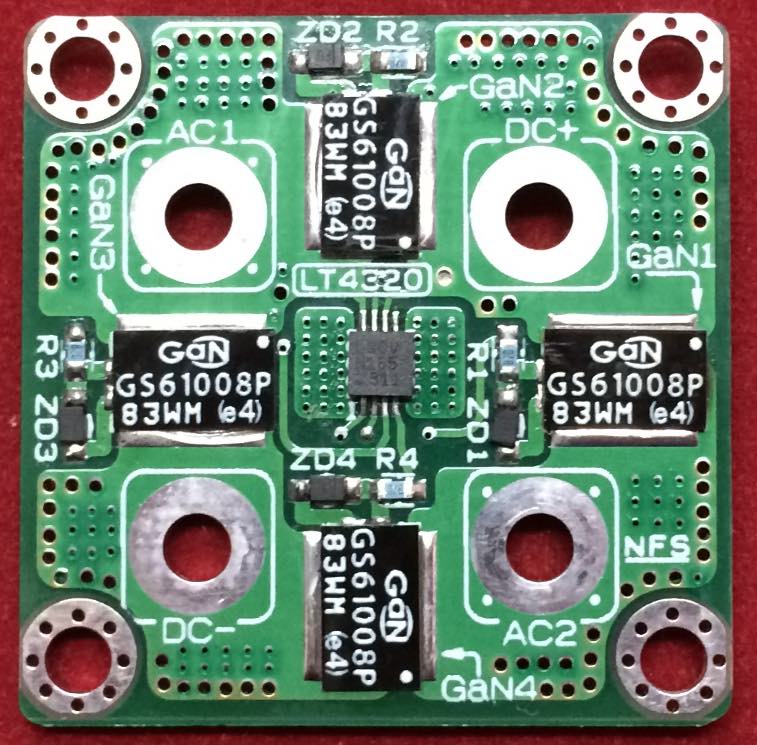

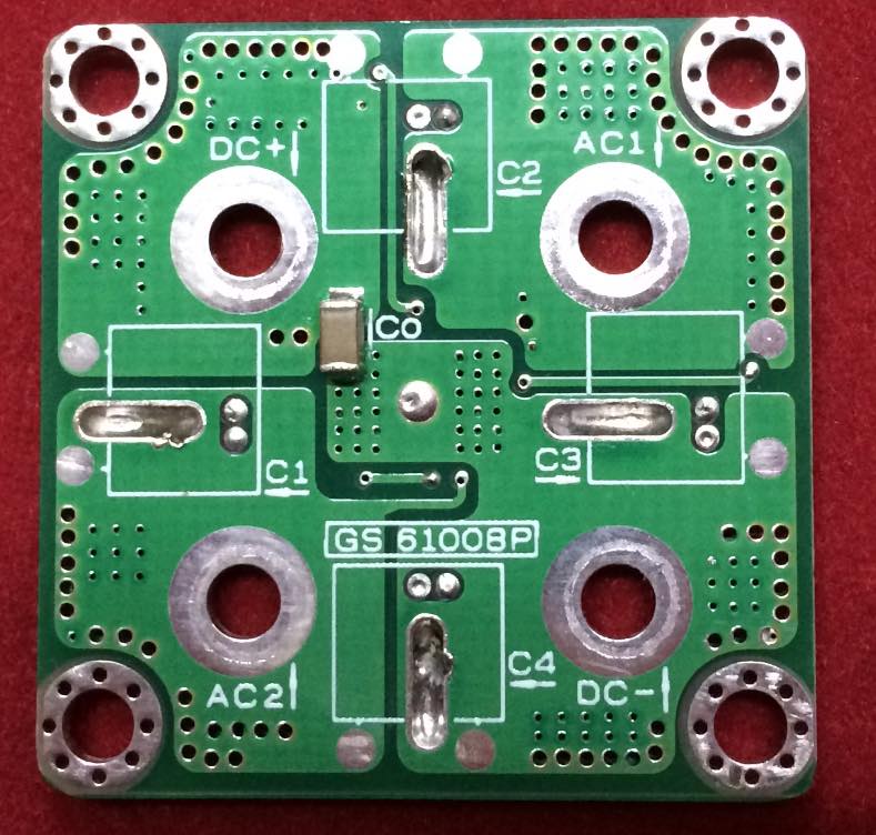

By Bunpei’s request, Mr. Hazawa in Tokyo designed and assembled a new PCB of “ideal diode type bridge (4-diode) rectifier. The PCB incorporates one LT4320 and four GS61008P GaN E-mode HEMT.
Bunpei will apply it to DC power supplies for his DACs by replacing existing Si diodes and SiC diode with it.
AC input must be 9-75V and a capacitor must be placed at an output.

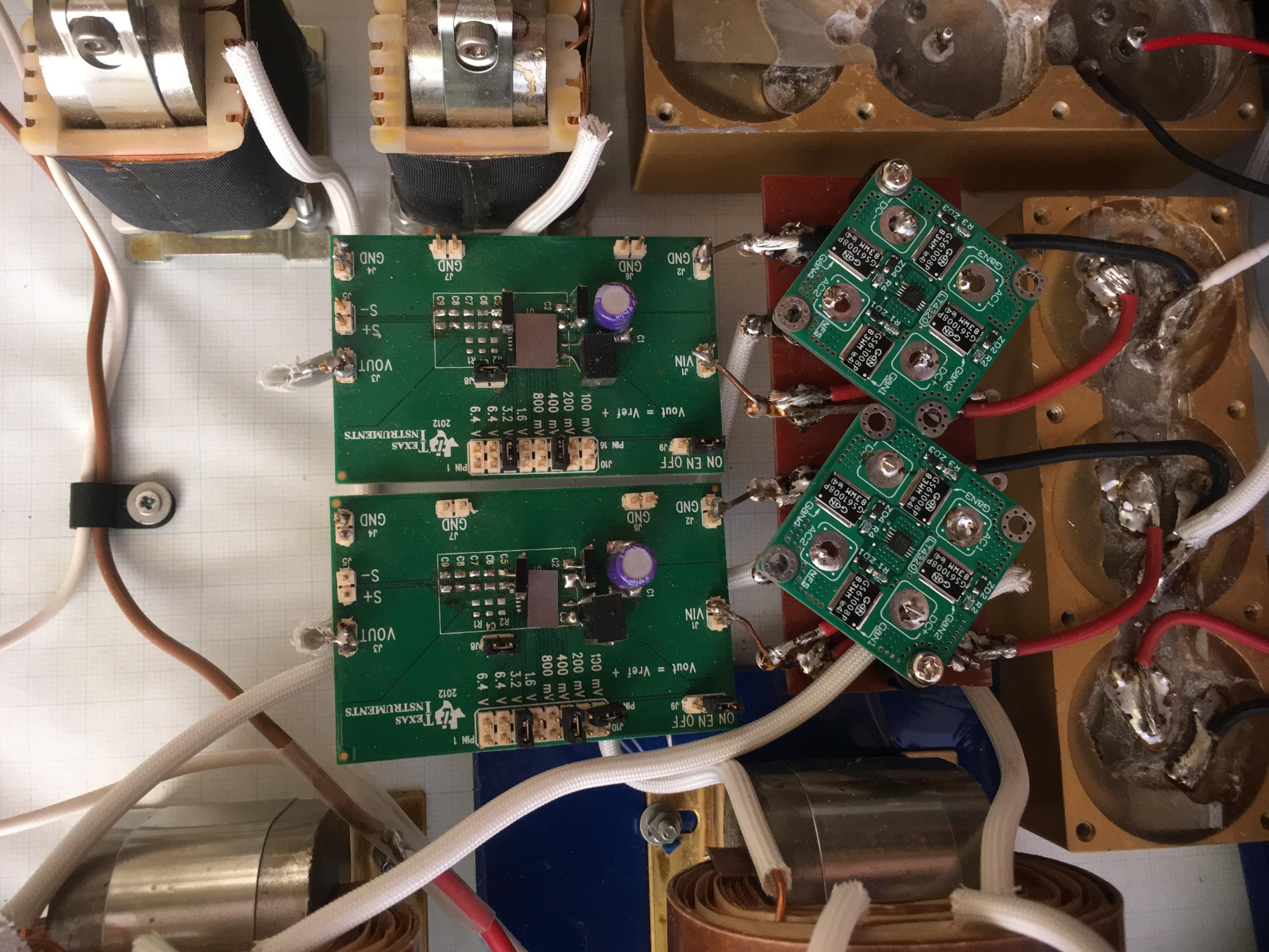

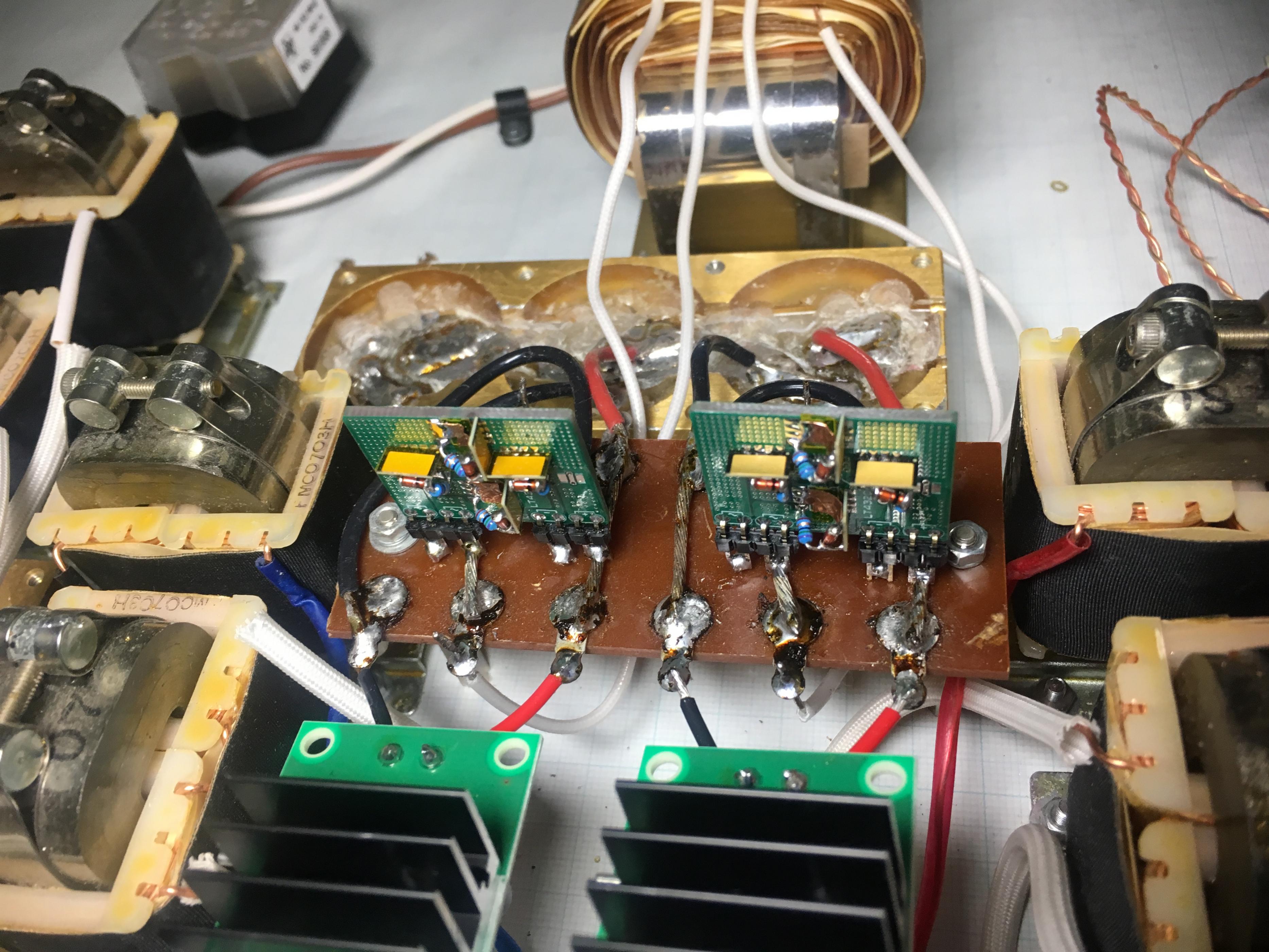

Bunpei applied Mr.Hazawa’s LT4320 ideal diode driver board with GaN E-mode HEMT GS61008P to +5V DC power supplies for a master clocking circuit in Chiaki’s ES9038PRO Dual Mono DAC and for a bipolar transistor driver circuit in NDK DuCULoN OCXO. Original four bridge diodes were four G-S tied GS61008T
The resultant SQ improvement is very satisfactory though no apple-to-apple comparison was not made because of an unavoidable transformer configuration change associated.
