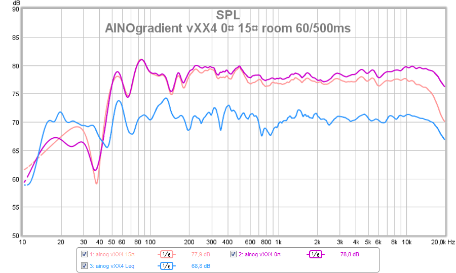

I have found that I (like SL and Jon Marsh among many others) find most pleasing sound when on-axis has this bbc-dip and 15¤ off-axis is slowly descending to highs. This is largely because of high-end has usually more beaming
Like this: 1,2m on-axis and 15¤ horiz off-axis (60ms) and room response at 2,2m 10¤off-axis (500ms). My speaker is rather constant-directive but it has a widening peak at 2kHz.
Room response has dip around 800Hz, it is front-wall nulling. Also floor reflection and room modes are seen
