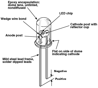

I'm afraid I don't know what you mean with "flat side out". Leds are not blinking in any way. (I even turned out the lights to check if they were burning very low...)

Flat side = cathode, facing out toward the board-edge
