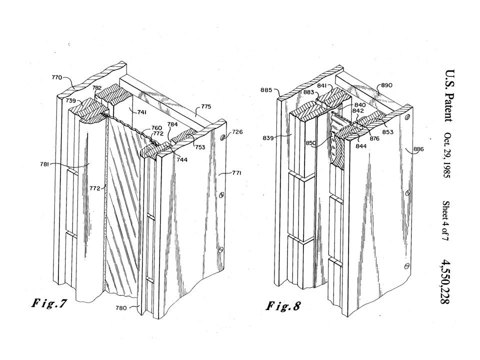

I wonder if anybody may be able to answer a few questions behind the design of some of the apogee ribbons .
I have been review their patent no.4550228 and find the following puzzling:
a) The midrange ribbon is noted as being attached at the edges along its length to the frame /diffraction thingos etc. as opposed to being limply suspended in space.
Whilst this would help with mechanical centering of the ribbon, I would have though that any such fixing would have restricted any ribbon movement and even lead to very high local stresses in the membrane leading to failure at the point of attachment .
I also note that the ribbon appears to be obliquely corrugated as opposed to perpendicular to its length - ie as the treble ribbon is. =perhaps this allows for some movement without mechanical failure.
From memory some of the magnepan treble ribbons were also attached at the edges ..??)
b) The treble ribbon seems freely suspended but has what appears to be a significant gap at the edges near the face of the magnets to each side .
I would have thought this to be a no-no for sound cancellation - or is this gap not an issue at the frequencies in question? (This gap is also plainly visible in some of the images of the ribbon found on the net.)

Hi George,
This Apogee patent is for their Full Range Ribbon Speaker.
The midrange ribbon is a true ribbon made from 10 micron thick aluminum foil with horizontal corrugations over the 2" wide, 84" long ribbon. The ribbon is clamped at the top and bottom by copper bars. To control resonance, the ribbon is physically divided into three equal lengths by soft foam rubber pads that contact both the front and rear of the ribbon to physically center-clamp the ribbon in the frame. Hence, the ribbon is one aluminum strip, but it is physically divided by the foam rubber clamps into three separate physical segments. The ribbon is 0.1 ohms, and almost pure resistance. A metal box holds a step up transformer that converts the 0.1ohm to 4ohm. The speaker comes with a passive front end bi-amp crossover box which provides 1st order crossover slopes at 320Hz and 10K Hz.
The magnet structure for the midrange is designed to provide a self-centering force. Two rows of ceramic magnets with about 0.1" separation are glued along the length of the iron frame. This 2-magnet-gap motor structure provides a more uniform magnetic field over the front-rear ribbon displacement. A second method is used to help self-center the ribbon. At the top electrical connection, two aluminum foil strips are run along the magets on both the left and right sides down to the floor, where the input started. Plastic tape on top of the magnets electrically isolates the foil, and a second strip of plastic tape on top of the foil provides electrical isolation from the ribbon. Remember that this ribbon is only 84 db/watt efficiency, so large currents flow through these side aluminum foils. A more efficient NdFeB ribbon would not generate enough current to make this side-foils arrangement worth considering.
The tweeter ribbon is constructed from a 0.5" wide, 2*84" long 10 micron aluminum foil with horizontal corregations. The two ends are both electrically connected at the bottom of the ribbon, and the top is a non-conductive clamp. The 2x length is used to create a bipole tweeter with about 0.5" air gap between the front and rear tweeter foil. When the drive current pushes the front ribbon forward, the rear side is pushed backward, thus creating a bipole radiation. Using one long strip of foil increases the total resistance to 2 ohms, and increases the efficiency to where Apogee used just a 2 ohm series resistor instead of a step-up transformer. The tweeter ribbon also uses two sets of soft foam rubber pads to physically divide the ribbon into three equal pieces, over just one continuous foil.

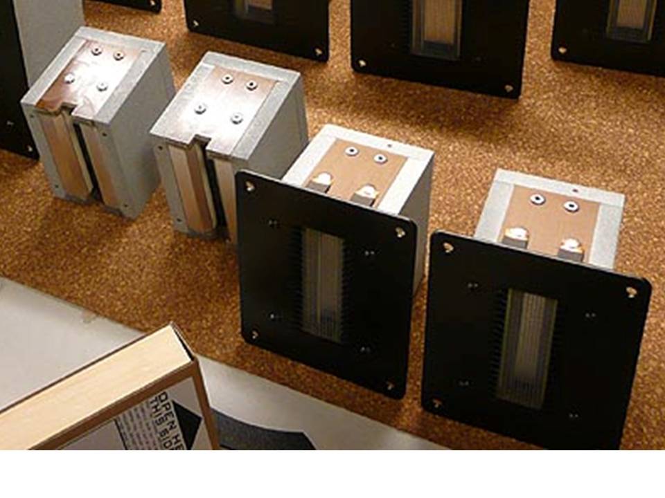

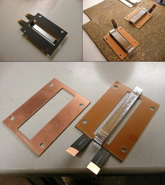

Linesource: Can you say a bit more about the photos in your last post? How are the parts you showed going to be used?
Few
Few

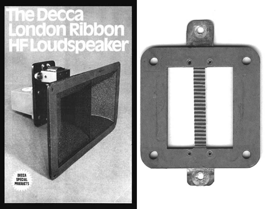

Hi Few,
The first picture is of the RAAL "FlatFoil" ribbon and its mounting frame. This assembly is screwed to the RAAL magnetic+steel frame in the lower left of the second picture to construct the finished ribbon in the lower right of the second picture. RAAL embosses their Al foil and adds a stretchable plastic film for the suspension instead of corrugating the Al foil it as done in most ribbons.
The 1956 Decca London Ribbon was one of the first designs to use a ribbon in a frame for ease of repair.

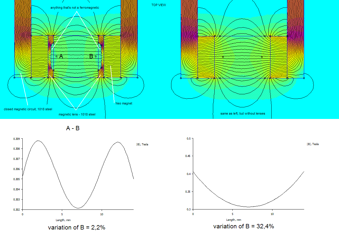

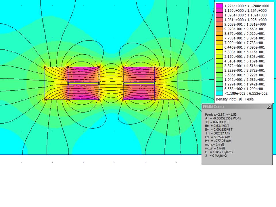

Linesource, does the Apogee double magnets (front and back) really make a difference on field strength.
The magnet-gap-magnet motor structure does provide a more uniform field over a longer front-back displacement than a single 2x height stack of the same number of magnets. This motor structure also provides some self centering between large displacement transients. Simulation show that this is a good design option with low flux ceramic magnets, or small NdFeB magnets. (pic1 and sim_pic2)
With larger high strength NdFeB magnets a steel "magnetic lens" (pic3) can be used to maintain a uniform flux over longer front-back displacements.
With even larger, wider, high strength NdFeB magnets the center gap field is uniform enough over a 0.1"-0.2" to not require additional more complicated engineering. I favor this simple construction.

Hello,
I have the same results with a variation of 3,8%. I bought customized Neodym Magnets 15x15x140mm with such lens milled. But it is very expensive!! Your version of a steel lens is more cheaper. Do you have any idea to manufacture such steel lens?
Andre

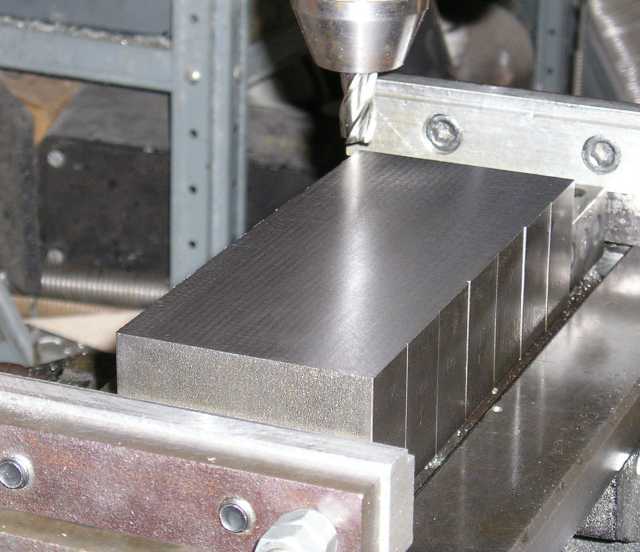

Do you have any idea to manufacture such steel lens? Andre
Andre,
Iron and soft steel like alloy 1008 are relatively easy to machine. Any machine shop could easily mill your artwork into a rectangle bar. Some DIY'ers use a drill press with a XY screw vise plus a few milling bits to make these simple shapes.
I do not think a magnetic lens is necessary for a tweeter ribbon, but might be helpful for a midrange ribbon if a smaller, lower cost NdFeB magnet is used. The increase in NdFeB prices has changed what is a cost effective design.
