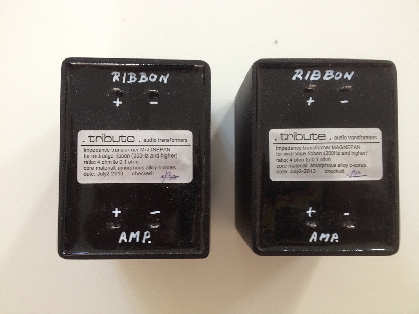

Hi Bill, congratulations :)
I dont have the stock transformers but the transformers tribute made for me are marked for polarity.
Theyre (mis)marked magnepan but are specifically made for the full ranges.
Original impedance box how I found it.

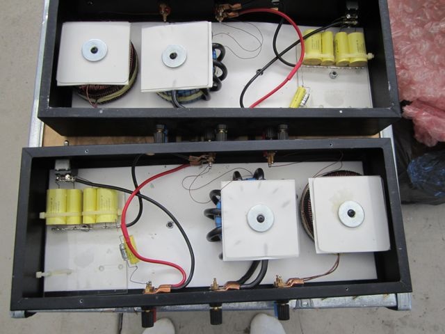

EDBK, those look really nice output transformers. How do you get those custom transformers? Have you compared them to resisters? My US repair rep states transformers do not sound as well as resister do. However I have not experimented so can not say. I like the efficiency of a transformer versus a resister.
Here is the photo of my transformer. It is the middle transformer with large 6 gauge wire. Is the polarity of the stock transformer to be wired top windings to the black terminal as found with my original impedance box?
Thanks Bill

Hi Bill,
I have not compared them to resistors but my gut feeling is its not the best idea to burn power in resistors on these low efficiency babies ;)
I've never had the stock transformers, but there are several FR owners who have ordered these transformers from Pieter Treurniet. A comment from one:
"i had a chance to hook up the transformers today and i am very
impressed! They have taken the music to a new level of realism and
transparency."
You can get them at Tribute - The final word in audiotransformers
One catch, mine took 4 months or so so you have to be patient ;)
I would not think the polarity to be very critical on the stock transformers anyway. But you can always reverse it and have a listen ;)
