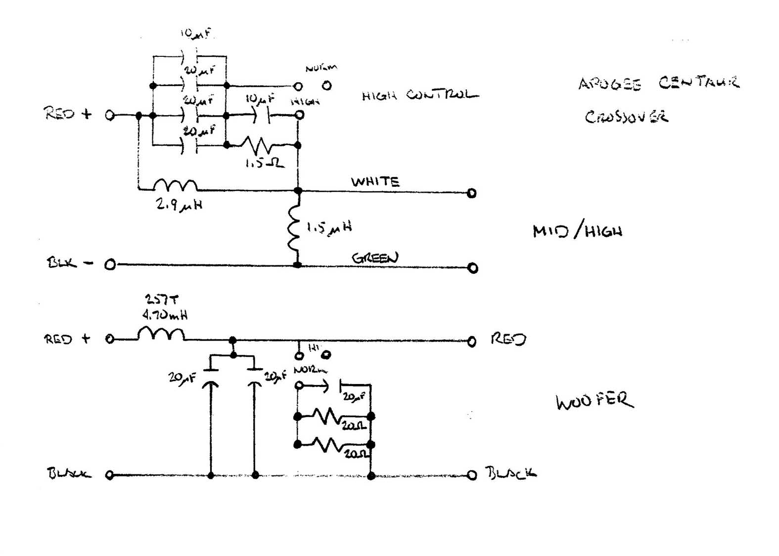

I like the Minor higher crossver point.....but i have the stages allso...so i gess i like the diff .....i run my stages with only the 70mf as the crossover....here the crossovers................thay all sound killer to me....

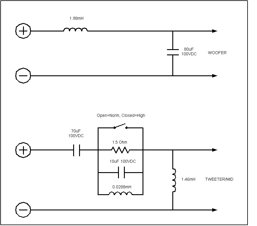

http://www.apogeespeakers.com/projectstech/centaur_minor_crossover.pdf is the minor crossover and matches what I have seen when the cabinet fell off mine.
Some things about the schematic don't make sense. Not least that its second order but ribbon and woofer are in phase. I need to start another thread on understanding the design decisions on the hybrids, unless the OP doesn't mind us doing it here.

Thanks Bill, the phase orientation doesn't surprise me. Phase coherency was a hot topic when the Minor was designed. The hole in response across the x-over range also shows up in Stereophile's measurements. Apogee recommended listening off the inside axis, I suspect leveraging lobing to fill it in. The hop from second to first order is a head scratcher and negatively audible to me.
After twenty years with the Minor, like you the performance of that ribbon continues to impress.
Any idea if the Minor x-over linked is correct? As I read it, the woofer 'high' position transitions the low pass from a second to a first order. Parts Express measurements of the original Vifa woofer shows a fairly dramatic upper-mid bump above 1.5 kHz.
Yeah, that particular crossover diagram is incorrect. (I noticed that many years ago on the old Apogee forum.)
Unfortunately, the Apogee crossover diagrams are user supplied in most cases and mistakes were sometimes made in analyzing the wiring configurations and translating them into conventional format schematics.

well starting at the top, the crossover I linked, which is close to the Mk1 eyeball of a real minor crossover seems to have a presence dip around 3KHz based a quick back of envelope calculation. Any one have any ideas on this?
Once that cleared then its the question of how low you can run the 26" ribbon. 750Hz isn't a bad point as you are pretty much splitting the power 50/50 between the drivers, but is there an advantage in going a bit lower with LR4 electrical?

If you believe the component values on that notch filter in the high-pass section, then the dip frequency is approximately 9.2khz. (10uF/30uH) I'm not sure how you're computing 3khz. However, 3khz seems like a more realistic frequency considering that driver. It's like I said, you can hardly believe anything you see regarding Apogee schematics.
I think it's probably preferable to run the ribbons as low as they can go.....considering the electrical roll-off of the filter you use. If you start seeing them move around quite a bit, it's time to raise the xover frequency or steepen the slope or both.

It was a 'quick' calculation some time ago so I can believe that as I didn't check it, but made a note to come back and work out why it was there. In what was a cheap speaker for Apogee they would have had a reason for putting it in. Looking at the impedance plots from the stereophile measurements there is is a wrinkle in the impedance plot around the 9KHz point so that makes sense. Looking at the frequency plots again there is a hump off axis vertically so I would need some correction for that.
