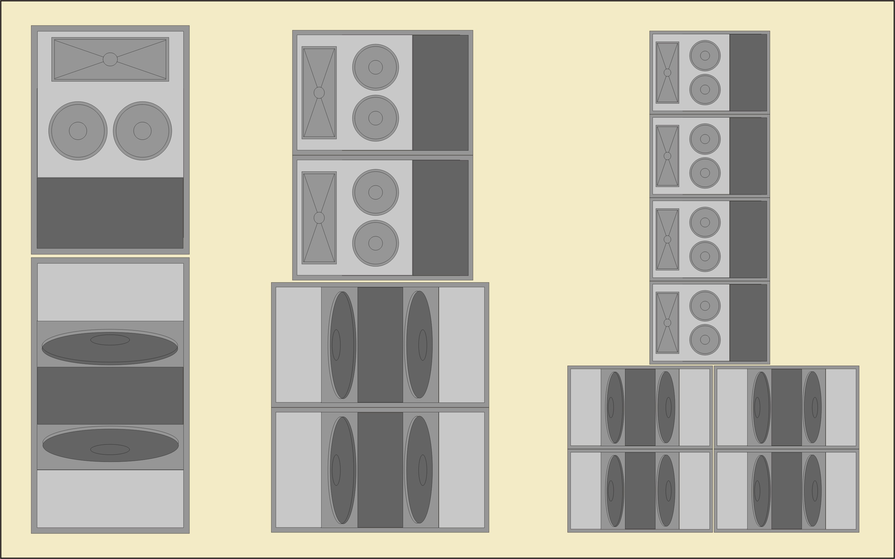

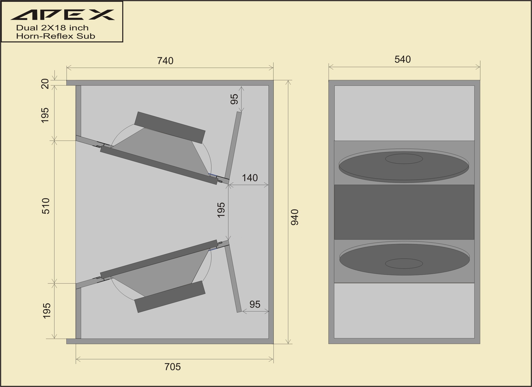

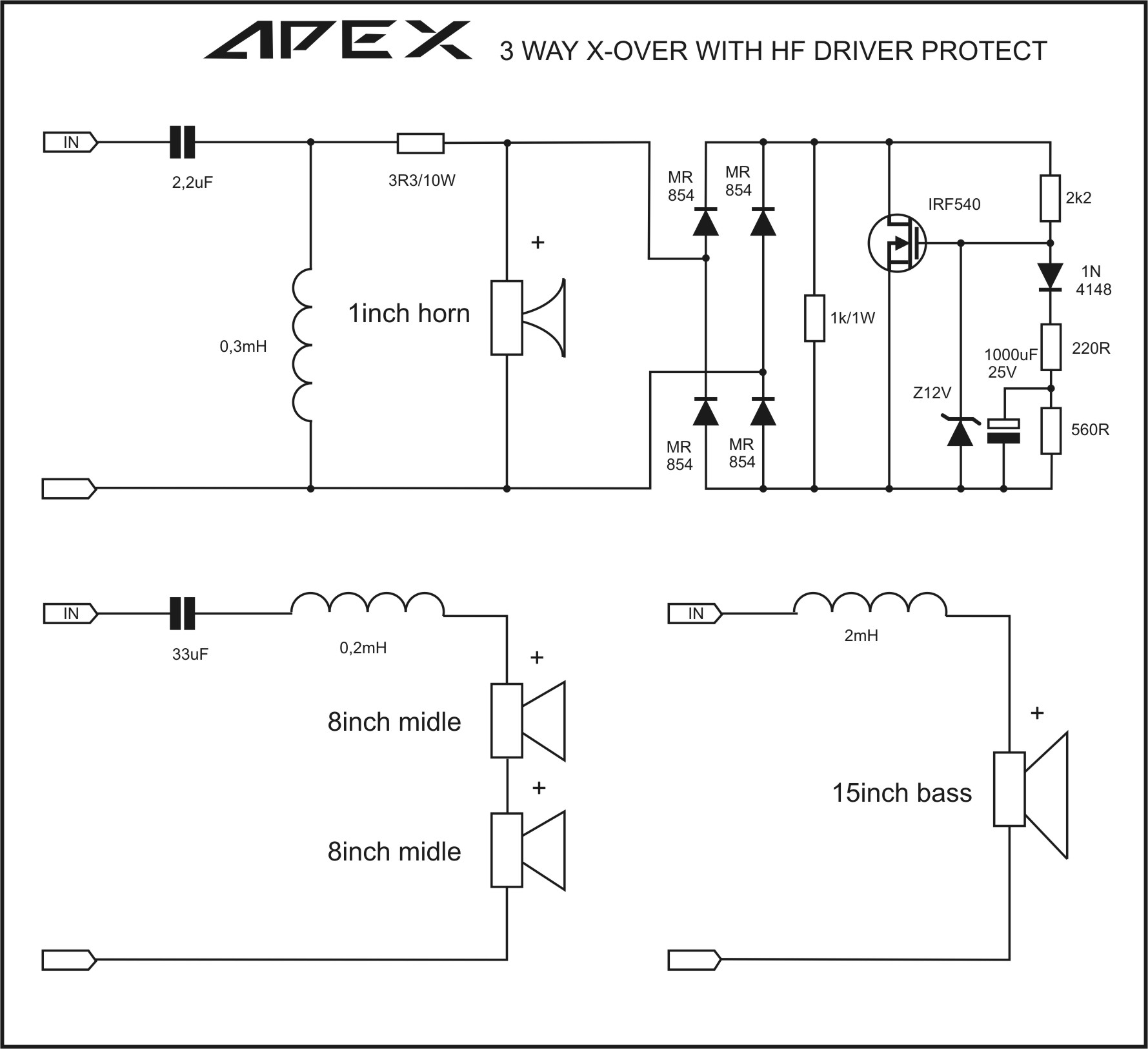

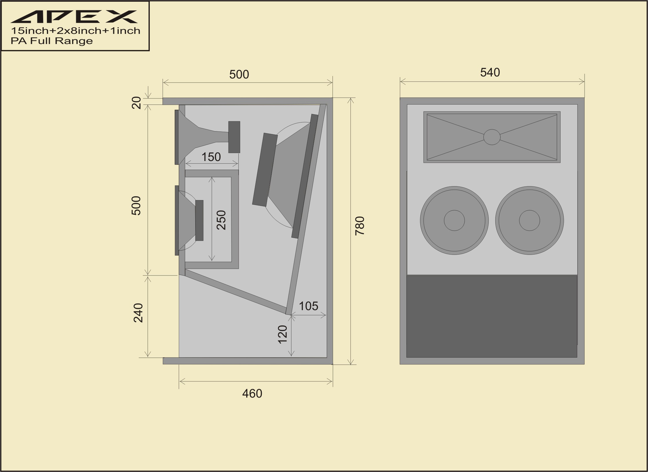

APEX PA Setup
Sub 2X18inch
Top 15inch + 2X8inch + 1inch
