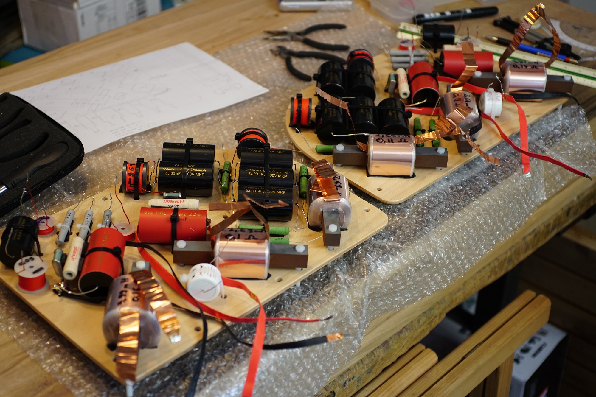

Hi Sebastian,
I use only one amplifier for the full system, since I´m back to passive filters - Devialet D 400. Had many alternatives to choose from, but liked the D 400 best... so my Fertinacoustics is passively filtered, yes.
I have in the past tried a variety of active concepts, some quite expensive, but with this combination, I have always switched back to passive filters after some time. I have enjoyed other active systems in the past (like Maggie 1.6 with RESTEK active crossover and VALVET amplification), so it´s not that I dislike active solutions per se.
A good passive filter is IMHO harder and more expensive to realize than several active approaches, and I´m not going passive to save money at all. I can´t afford doubling up Devialets sadly, but other active solutions were not cheap either...

Hi Mattes,
thank you for information. I thought that you have separate amplifiers for Fertin's drivers. Now it is of course clear;)
Passive corossover is also a goal for me, I just want to use dsp to find proper crossover point and then design passive filters.
Sebastian
Hi Sebastian,
wishing you best of success with your filter design! For my FR driver, I went with an inductive HP in the end, suited my ears best, but maybe critical with tube amps due to impedance? There are many choices... I needed more than one year to finalize my filters.
No secrets however, if you´re interested in (hand-sketched) schematics, just let me know...

Hi Sebastian,
no, not a problem at all. Attached.
It´s a balanced conductive HP filter (if you do such thing then beware of low impedance!), like the first Sonus Faber Extrema. Hope that it might give you a little inspiration - of course all values are only valid for the precise configuration, with the RD 75, something totally different might be needed.
