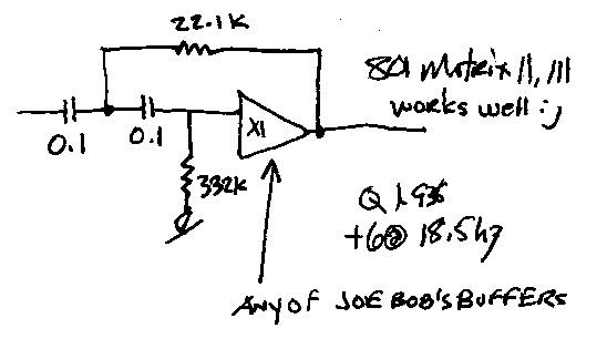

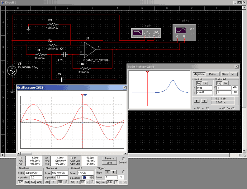

do you mean to say "all pass" filter for time alignment? Here's the design which Ballard used in his 1982 Speaker Builder Article with "virtual instruments" thrown in -- the output of the filter lags the input by 50uS.
