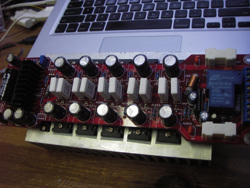

I was just wondering about the voltage suggestions regarding this board +-45 and +-60vdc.
The chip has an operating voltage between 20v and 100v. I was hoping I could reuse this large toroidal I have around. It has a dual 60v line I would really like to use but +/-80VDC amp boards seem rare so I was hoping this one would actually need higher voltages.
I am just keen on NOT wasting anything... if there is a 30 + 60v line I would like to have a board which makes use of it.

I have a couple of these boards and I tied the +/- 45 and +/- 60 volt lines together. ie +45 to +60 and -45 to -45. I use a +/- 65 volt power supply and get about 155-175 watts @8ohms depending on the power line voltage at the time of measurement. You will have to modify the Dc protect circuit a bit as it expects to see +45V, I took the almost finished amp to an Ottawa diy show and received very favorable comments concerning the sound quality. here is a link its post #123 13th picture, I think its labeled amp built by JK. The chasis is 17" x 10" x 2"

when you buy the boards a schematic is included. There is a series resistor between the DC protect IC and the relay. It is 560 ohms on my board. I replaced it with 2 4.7kohm 5 watt resistors in parallel. In series with one of the resistors is a led that tells me the relay is energized. The relay get about 16-18 volts which is plenty to energize it and keep it from getting too hot. If you use higher than 60-65 volts you may run into a problem with the maximum voltage rating of the IC protect chip uPc1237 and have to modify the board some more.
there is no advantage to use a supply for the driver chip that is way higher than the outputs. The +/- 45 pins are for the outputs and the +/- 60 pins are for the driver chip. Using 80 volts for the driver chip and 40 volts for the outputs is a waste and will severly limit your output power to around 70-80 watts instead of 250-300 with 80? volt rails.

if you decide to buy the boards, you can take some time to look at the pcb traces for the uPC1237 chip and perhaps break a trace and isolate it from the pcb +45volt rail. You might then be able to use part of the 30-0-30 winding to provide the power for the DC protection and the 60-0-60 for the rest of the board, driver and outputs. I set the bias to an average of 30ma per output device. With my rails of +/- 65 volts or there abouts power dissipation at idle is 20 watts or so per channel. The heat sinks get a bit warm after a few hours.
All the power supply capacitors on the board are rated at 100 volts. So the board should survive +/-80. Use usual precautions when powering up for the first time. Remember there is no current limiting on the board for the output stages. one slip of a probe and poof
R30 would seem the correct place to start to investigate reducing voltage to the chip. The absolute maximum would seem to be 60v...
