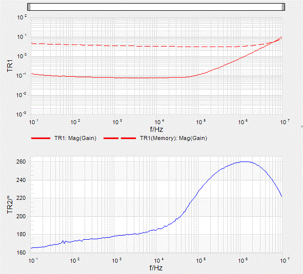

When I was designing my battery powered dc-preamp, I did some impedance testing of batteries. I noticed their output impedance rising with the frequency of current draw, especially in the gel sealed-lead-acid batteries I used. Alkaline batteries had a flatter impedance over a wide frequency range, but the impedance was a lot higher in general (because if its lower capacity).
To measure the battery's impedance, I used a small audio amp (based on a TDA2040) running through a 10 ohm resistor, then coupled to the battery's positive terminal through a 22mF (milli, not micro) cap. As I swept the frequency into the amp, I watched the signal across the resistor and the battery terminals. There was virtually no signal across the battery up to almost 1KHz, but then the amplitude increased at about 6dB/octave. So I calculated that the battery measured in the low milli-ohm range up to about 1Khz increasing to about 250mOhm at about 50KHz.
Because of this, I added 12mF of capacitance, plus Tantalums and mono-ceramics on the supply rails to ensure a very low impedance across the entire audio range. I used an LME49720 for gain, and given that its PSRR is typically 120dB, I doubt I needed much filtering at all, besides the usual decoupling, for spectacular results.
When deciding on regulated AC power or batteries, I compared the two. What I found was that hands-down, the batteries had less noise and a lower impedance than any regulator, monolithic or even a discrete super-regulator. So I went with the batteries.
But are batteries audible? Will different battery chemistries sound different? In my opinion, based on my tests and experience, with a properly designed audio circuit, no. I don't believe you will ever hear any difference in an audio circuit powered with various batteries. Even my preamp, with its rail capacitance and textbook audio circuit, should perform perfectly whether powered by NiCd's, LiPo's, alkaline's, or the SLA's I ended up using.

Although I have not tested many batteries for impedances and peak current I once built a single-ended Class A amplifier where I mounted the batteries directly below the output transistor - hardwired to the transistor without any contacts or relays in between. The distance between the batteries and the transistor probably was about 10-15 centimeters (overall). The sound of this amplifier was second to nothing I'd ever heard when it comes to definition, speed, tautness, freedom, detail, openness, lucidity, timbre etc. - sheer presence. I also built similar amplifiers where the batteries were somewhat farther away - about 40 cms - and although still quite special they were less immediate even if the design was otherwise very similar. So my conclusion also has been that the - at the actual circuitry - impedance & bandwidth of a PSU is indeed very important.
