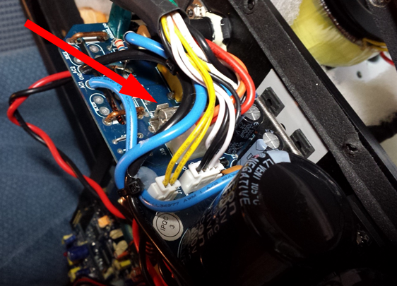

In short I have 2 Sunfire HRS 10's, one just went down, still turns on, so the power rail must be good as no blown fuses...
Had a Sunfire(can't remember model #) with similar symptoms some years ago and tracked the problem down to a single "hidden" fuse on one of the smaller boards. I believe it was 150mA, used to power some house-keeping portion of the circuit. From visual inspection, it looked good(could still see fuse wire in place) but when tested with ohm-meter it was open. Replaced it and has been working ever since. Perhaps you have something similar.
I just did a continuity test on the fuses, all OK.
But I noticed it actually doesn't quite turn on, my bad. It tries to turn on, the power led never goes green but quickly flashed red, then goes back off. Possible power cap issues maybe? I can hear what sounds to be a relay clicking.
