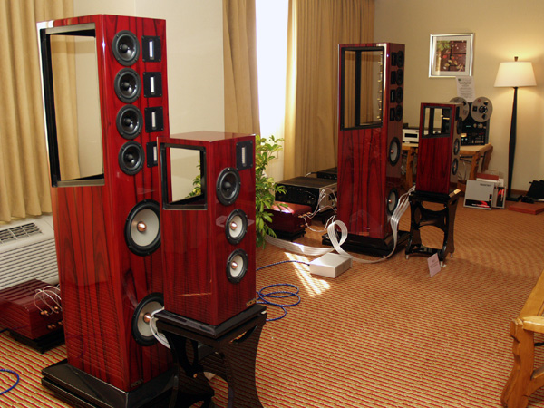

Afaik, Avalon Acoustics uses Eton drivers. You might remember those speakers. Everyone and their Grandma was trying to clone these some 10 years ago. I do believe the Hexatec drivers are an honest attempt at making a pistonic cone. Just visited the Eton site, all modern low mechanical resistance baskets and designs. Using a honeycomb structure to stiffen the cone is a solid idea. So that leaves price and the inevitable cone break up and asociated 3th harmonics to deal with.
