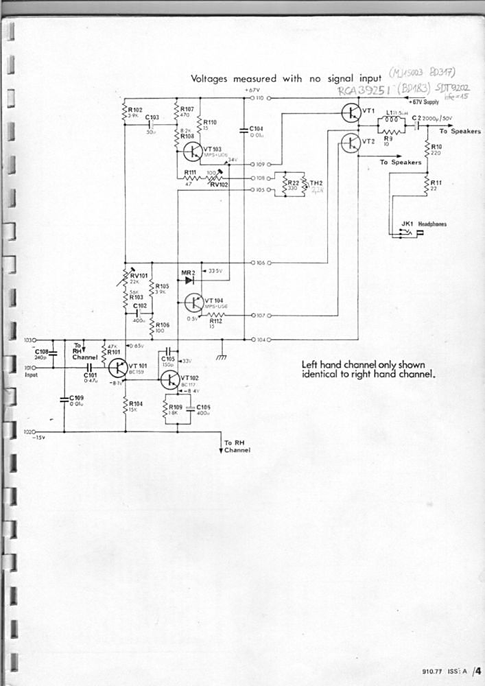

hello.
for many years i was listening radio-music (and sometimes cd) with my leak delta 75 receiver.the sound is present in the mid's and bright in the treble,can not say there is much punch in the bass.but i like that old apparatus.
there is the schematic of the main amplifier...........amazingly it has no emitter res in the output stage.
and in the preamp the volume control has two taps that create some kind of loudness.
