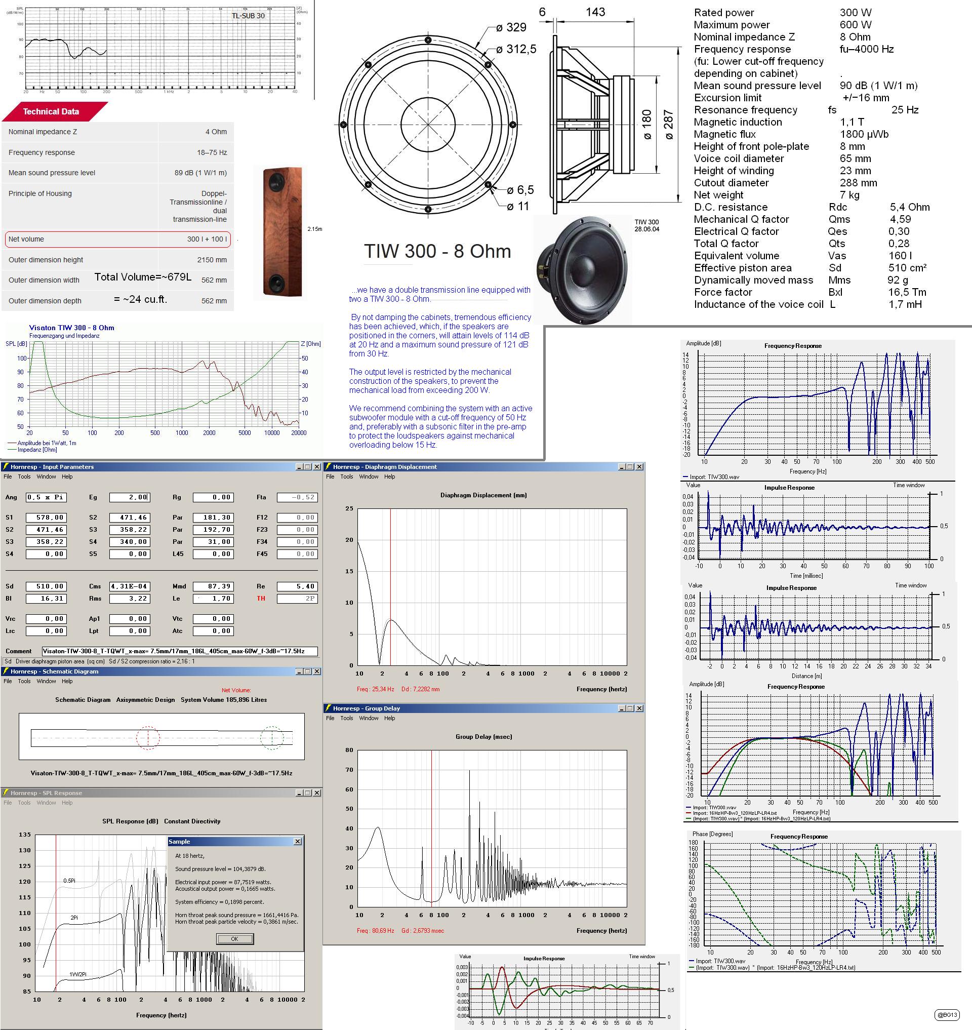

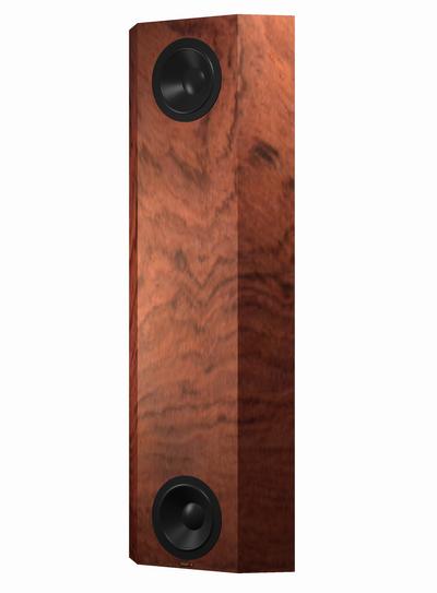

In my googling I ran across this design from German Visaton and looking for more information.

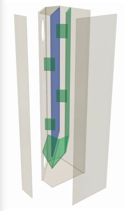

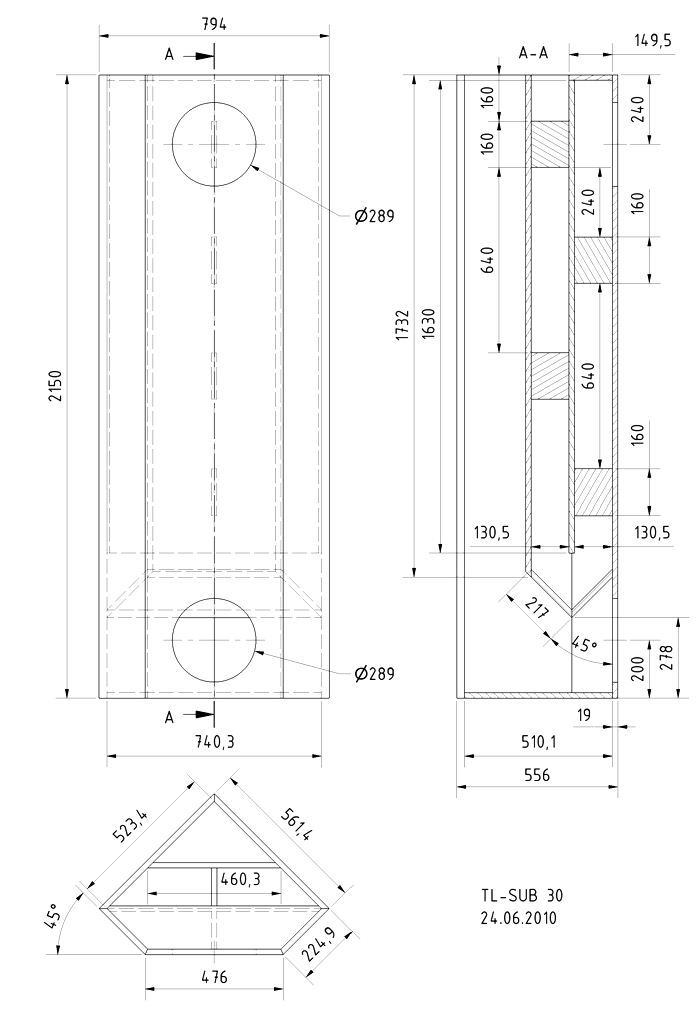

Specifically, what is going on in the exploded view? It looks like the TL exhausts out the top but there are two things that bother me. The bottom driver has a considerably shorter path than the top driver with folded line. Also it doesn't appear the lines have smaller volume as they approach the opening.
Anybody have any ideas how to keep the cabinet and re-design so it's true TL?

This cabinet is relying on Quarter-Wave design principles but IMO wasting unnecessarily a large volume for the performance.. Compare the net box volume and BW with a OD_T-TQWT....
