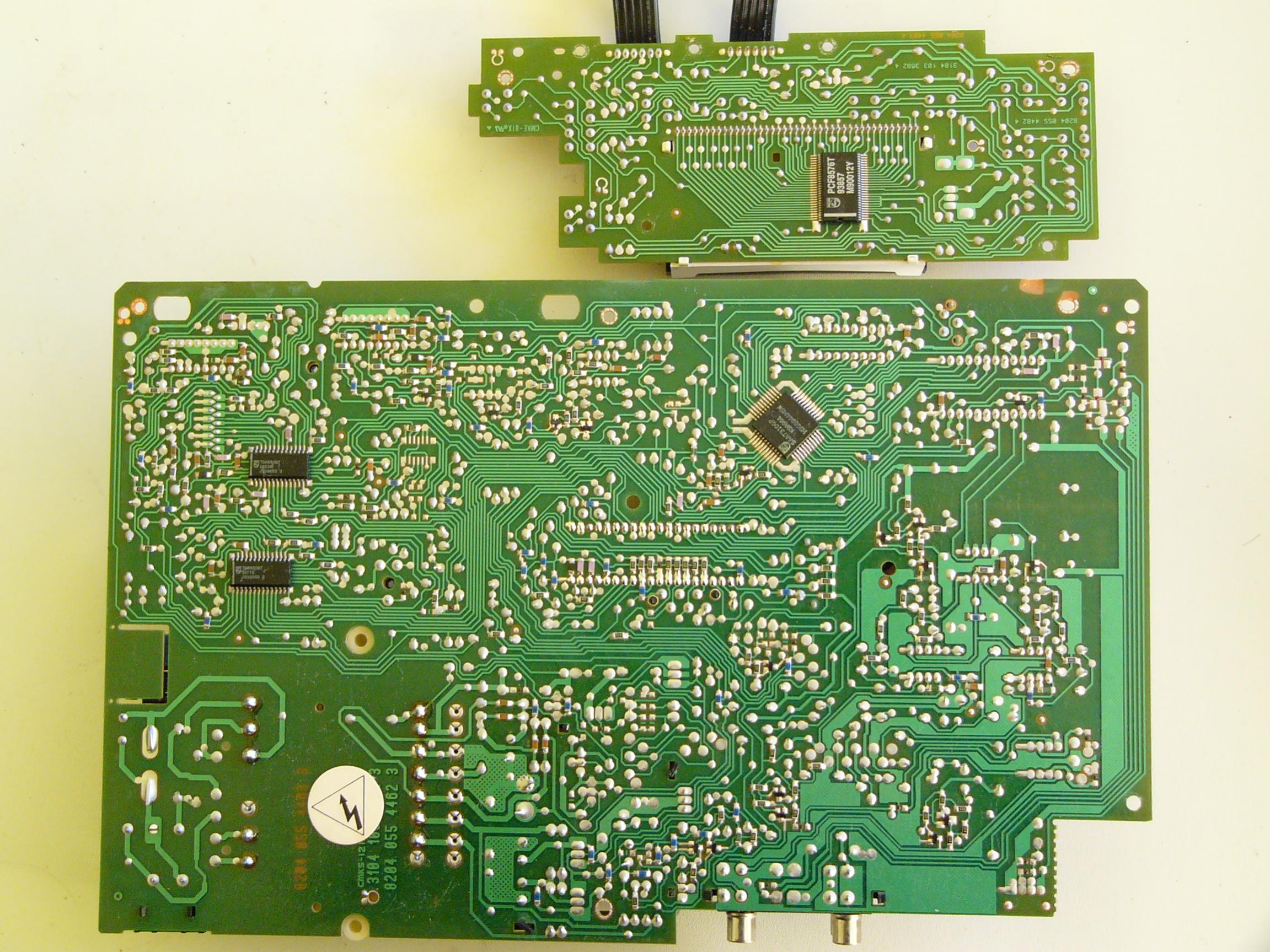

I've attached pictures of this player's mainboard and display panel.

I too have CD 210. It is working fine but I dont know if my set has some thing manufacturing state that the display window is not illuminated. To know the play status and for other indications I have to go very near to display window and peep my eyes into it. Can it be illuminated putting any short of light in the display area ?
The display in this player is an LCD panel backlit by two 12V 50mA light bulbs. These bulbs have a finite life and inevitably break, NAD players are notorious for this fault.
You can either buy new bulbs from an electronics shop / website or I could send some to you for the cost of shipping. I have a CD230 that I was about to junk, it uses the same bulbs as the CD210. PM me if you're interested.
Can you please show the pc board and the place where these two bulbs should be soldered.
They're soldered in behind the LCD module. On the back of the display PCB you can see four white plastic tabs that hold the LCD module to the PCB. Push these clips back through the PCB and gently hinge the LCD module out, exposing the two bulbs. You can then desolder and replace the bulbs. The bulbs may foul on the frame / diffuser assembly, in which case you may have to desolder the data pins.
