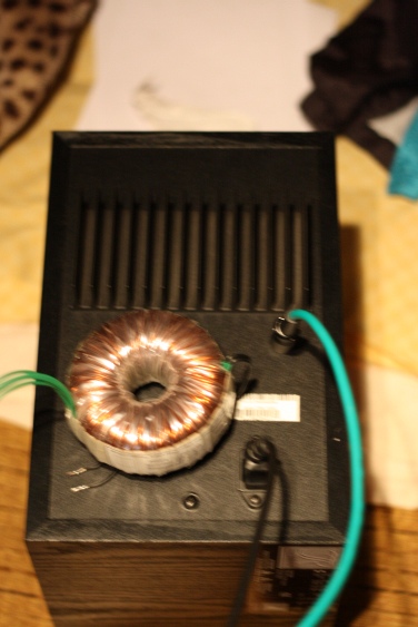

Event did also make a TR8 XL which was basically the same as a TR8 with a more powerful amp and a toroid trafo. I've seen a photo of the back and it does have a bigger Alu plate but not anything resembling a proper heatsink...
Yeah well I'm in the process of redoing these speakers. I had a pair of 200W trafos, nice heatsinks, some spare LM3886 and willingness to redo everything from scratch, including filters and input section. I'll post pictures later

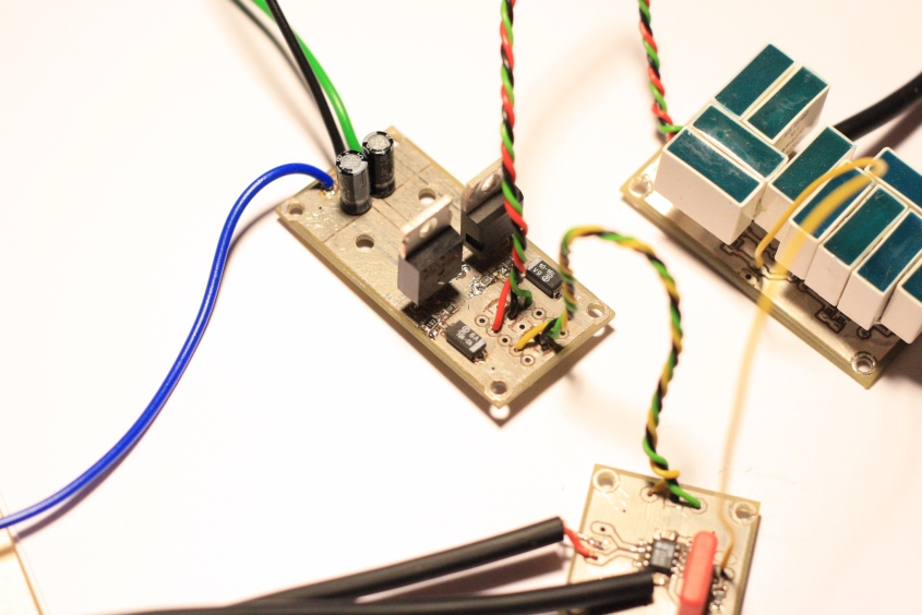

A bit late post I know, sorry for that. Attached one picture of the new crossover and a pre-rebuilding photo of what I wanted it to look like in the end. It turned out just like in the photo with some additional screws here and there and the trafo inside. I only did one speaker this way because after listening to them both I came to a conclusion that the original sounds better - somewhat more clear, more "airy". So what my oversized heatsink barely gets warm even when blasting away.. They actually sound pretty much the same, even the stereo image doesn't get messed up (I'm listening to them both right now) but one ear always gets that extra bit of detail in highs.
So I was thinking about leaving the same sink, same trafo but instead of active xo, put a passive one inside. Just to test if all the cheapo capacitors in the active path were to blame.
