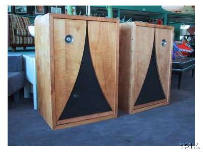

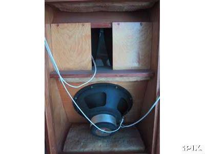

pics
Ebay fodder of Palmsprings estate sales
