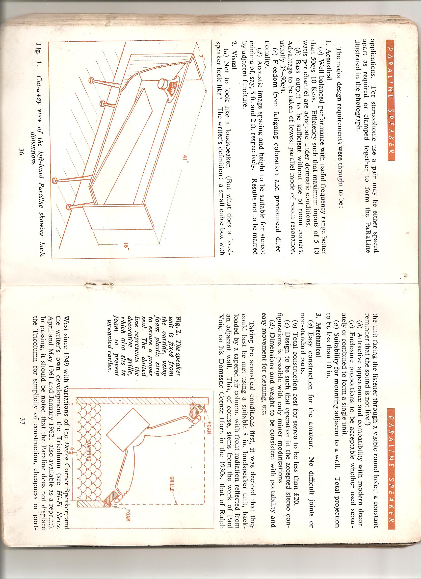

HFN &RR also had the Paraline were the driver faced the wall, the long enclosure was either standing or lying sideways with quite long legs underneath them.
Then there was the Basset a single fold Voigt pipe using four 8" Elec drivers and a damping consisting of a back of muslin stuffed with wood shavings! This was used as a subwoofer with an active crossover.

I have the origonal booklet FIVE SPEAKERS published by miles henslow which
has tricolumn decca corner 12 inch decca corner paraline and corner concrete
horn designs The only one I have built is the corner horn but this was over 40 years ago
If anyone would like to see any of the articles I will try to post them
All the designs except the corner horn were based on voigt s quarter wave design
regards richie

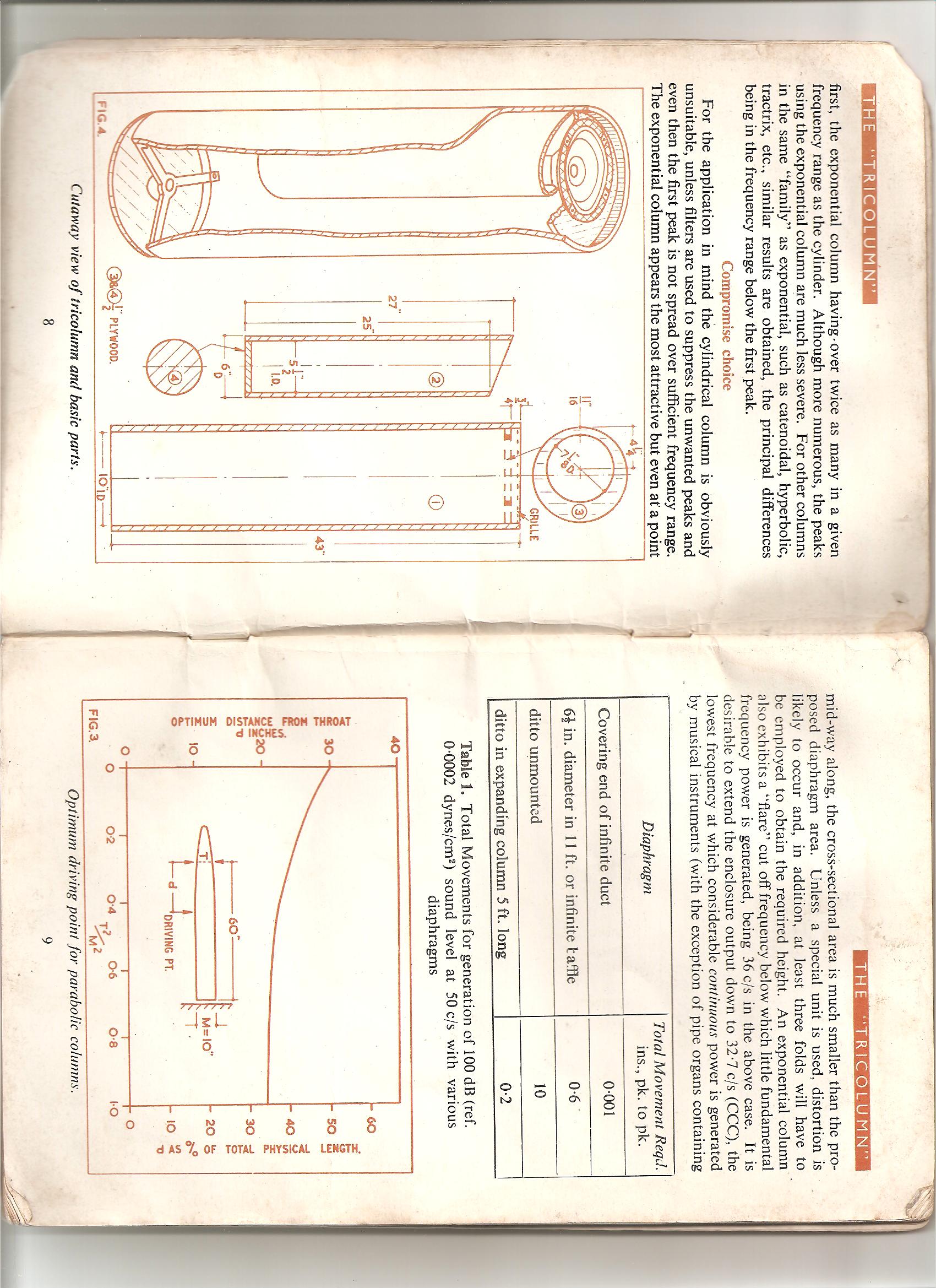

Some construction notes on TriColumns
1. The baffle is simpler with modern fullrange drivers that are front mounted on the baffle.
Do not forget to recess the baffle if you want to have some cover on top...
2. Internal bracing and damping is needed
3. Using a elastic fabric sewn as a straight tube with a diameter slightly less than the tube makes an easy finish.

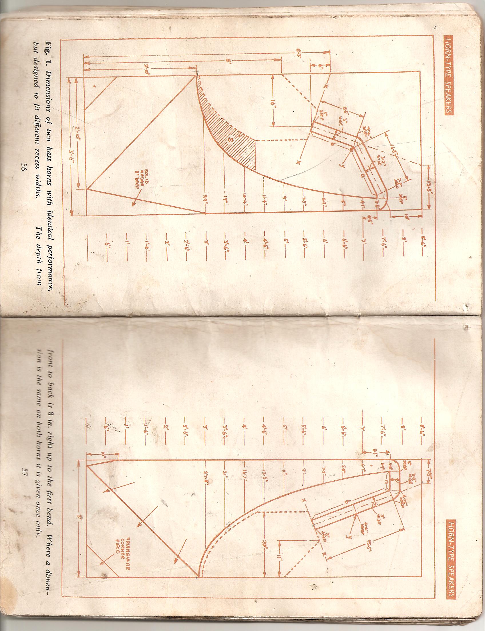

I have started to plan a build of a the Decca Corner horn. I will not build in original state with 9mm plywood and no damping what so ever! 12mm MDF or 11 mm OSB laminated with damping material is more likely.
The taper of the pipe is a bit unusual to say the least. Any opinions of there would be something gained by trying to get a more conventional flare?
I would keep the cabinet as is but add pieces of light softboard to fill out the sections below the driver to get a more conventional flare.
The intended 8" drivers are at 200-220 cm2.
Cross section in cm2
Start: 297
At start of baffle board: 428
At lower edge of driver cutout: 336
At the top of the divider oposite the driver: 440
At the bottom end of divider: 660
Bottom: 957
Then the final opening is a constricted slotloading, that in UK has bottom of a wall to wall carpet that the feet has sunk into to some undefined degree.
My plan would be to have the opening facing the corner and be of 50-100% of the surface area of the driver.

Did Anyone ever build the Decca Corner Horn?
I have the original articles that are in Hifi News magazines and the patent documents they are easy to find. But I see that the documents are already on file here.
Did anyone ever build a stereo pair of Decca Corner Horns?
If they did what do they sound like?

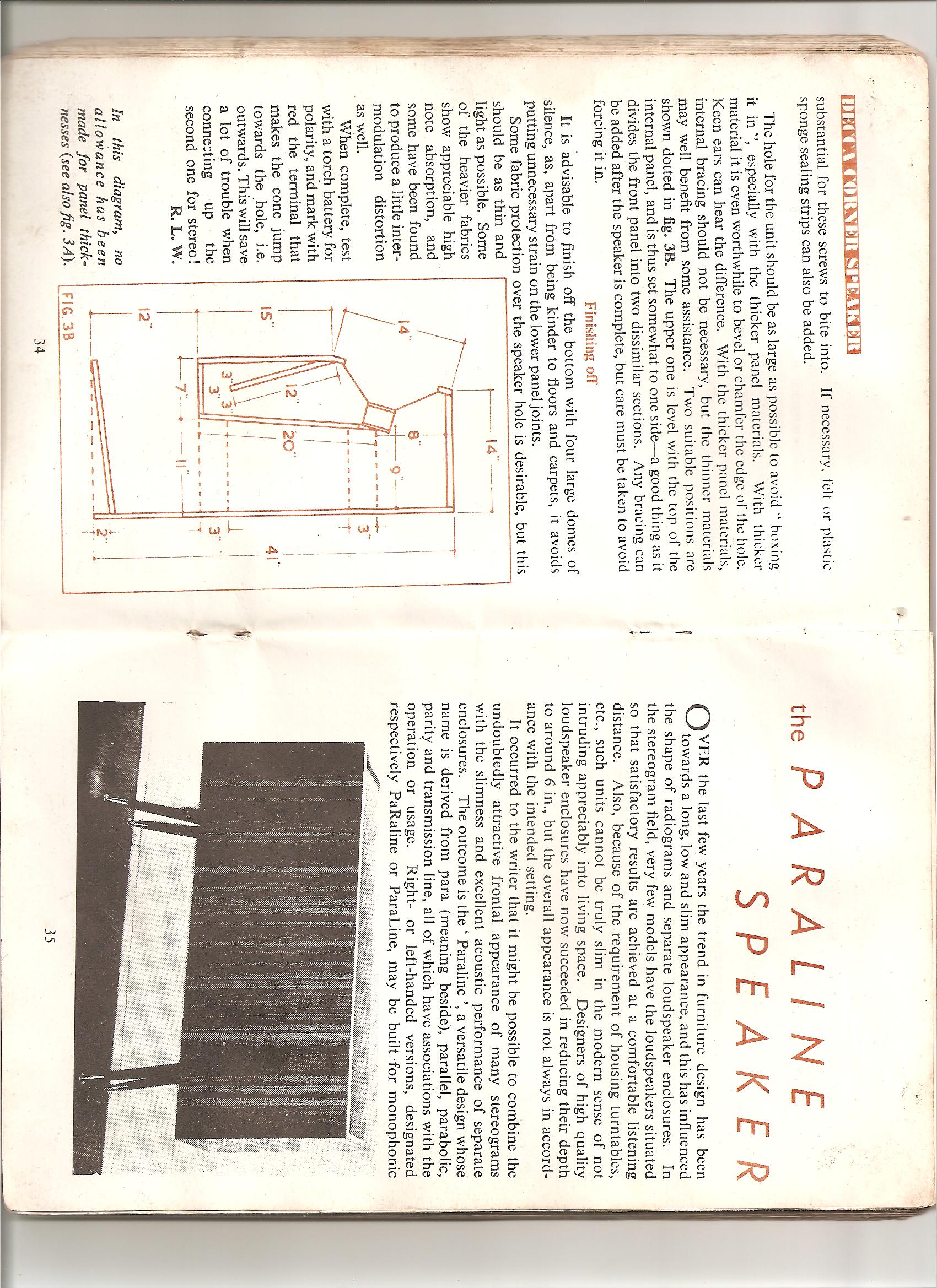

I have studied the documents and read then over and over again. The Hifi News articles do not differ from the diagrams in the patents.
The diagrams here are slightly wrong, the feet do not go the total length of the front and back, they are according to the article formed by bits of wood referenced in Page 726 where it mentions 4 135 degree strips two of which project to form the feet and the 2 of 2" x 2" x 3/4" Fig 5 form the other two feet.
There is I would agree some oddness going on at the bass port or horn mouth as part of the sound will exit from the side and the front and the rest will go up the back wall extending the horn. I assume there will be cancellations all over the place as the sound waves will be in and out of phase. Not sure I get how that works, I would expect the sound to be diffused as it is the nature of the design.
In the follow up article on fitting a 12" speaker he mentions about the resonant frequency of the driver it should be between 40 and 90 Hz the lower the better and do not go above 90. What he is suggesting rather than modify the current baffle that is used for the 8" speaker.
He suggests that you make up a new baffle for the 12" speaker and fit spacers between the two until the magnet aligns with the horn taper panel. This of course will change the angle at which the sound is reflected as there is less space between the baffle and the rear walls. Which may be why it is suggested that it does not sound as good.
I have for some time wished to build a pair of these as I suspect that they sound rather good given the high prices that they fetch on eBay.
My main concern has been the use of the 12" driver which I intend to use. I have a pair of Dynastatic forget which model - which uses a Richard Allen CG12 and a Shackman electrostatic in a large sealed box.
I have of course wished to rehouse them for some time - they date from circa late 1960s.
I have reservations that they will work in the Decca Corner Horn - I do have the data for the CG12 drivers it is as follows:
Fs (Hz) 30, Qms 3.52, Qes 0.36, Qt 0.327, VAS (cu ft) 1.86, No (%) 0.51, Cms (M/N) 17.9, Mms 11.4 & Bl (Wb/m)13.7.
I would not how to model them nor do I have the program or calculations on how to do it, does anyone or can anyone model CG12 in the Decca Corner Horn for me?
