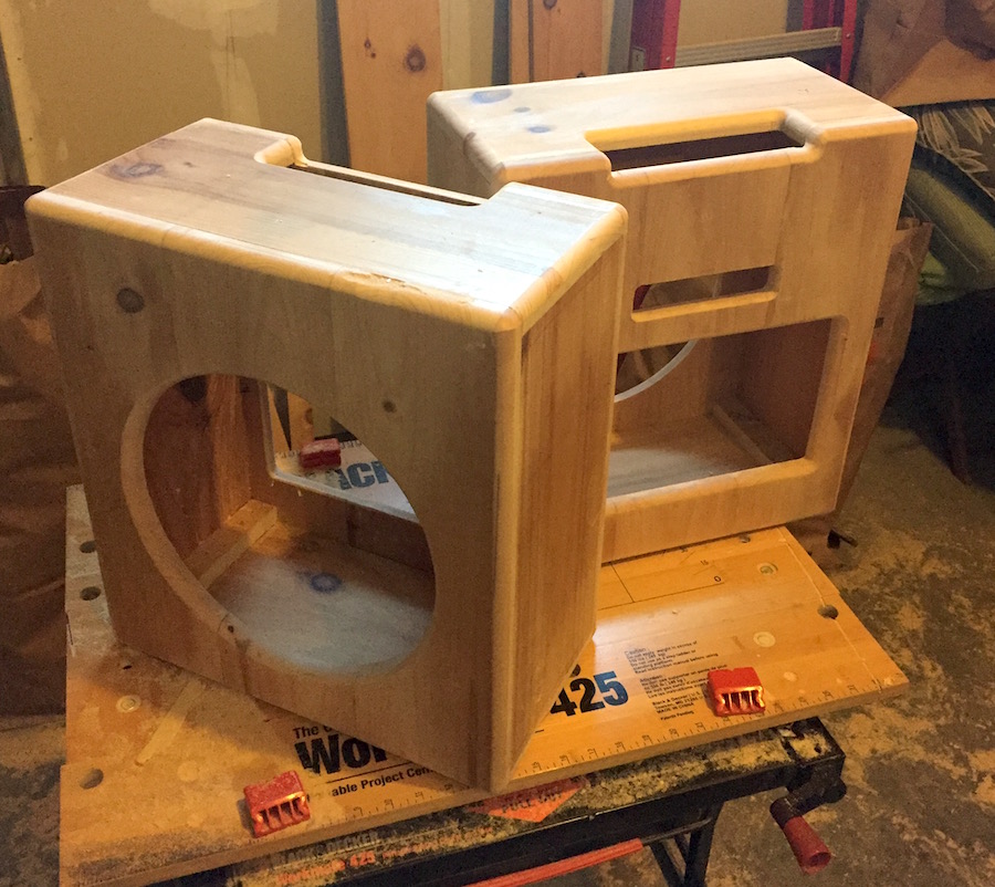

You need to keep the across grain dimensions small, don't glue across the grain, and allow the cabinets to move across the grain.
Bollocks - I didn't follow any of these rules. It's all 3/4" pine glued together and all the wrong way by the sound of it. Should I trash the lot and start over ? - will covering it all over in varnish help ?

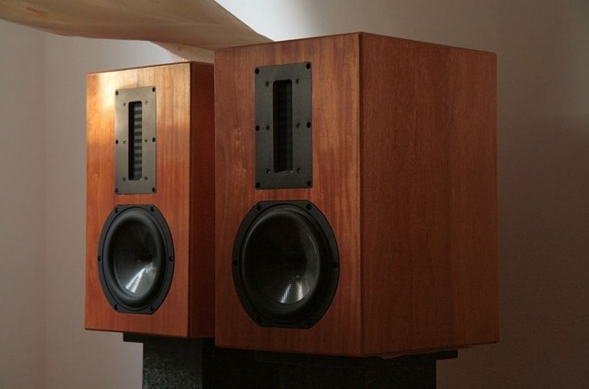

I've used exotic wood and French Polish - easy to work with. Always one piece of wood 30-35cm wide which of course deform after gluing. Closed box and soft suspension bass - below is 6" nanocarbon unit and Harwood AM35/Aurum Cantus 30130. Very nice sound, my best little speakers. Now I bought opposite - very light Samba wood 40mm thick.

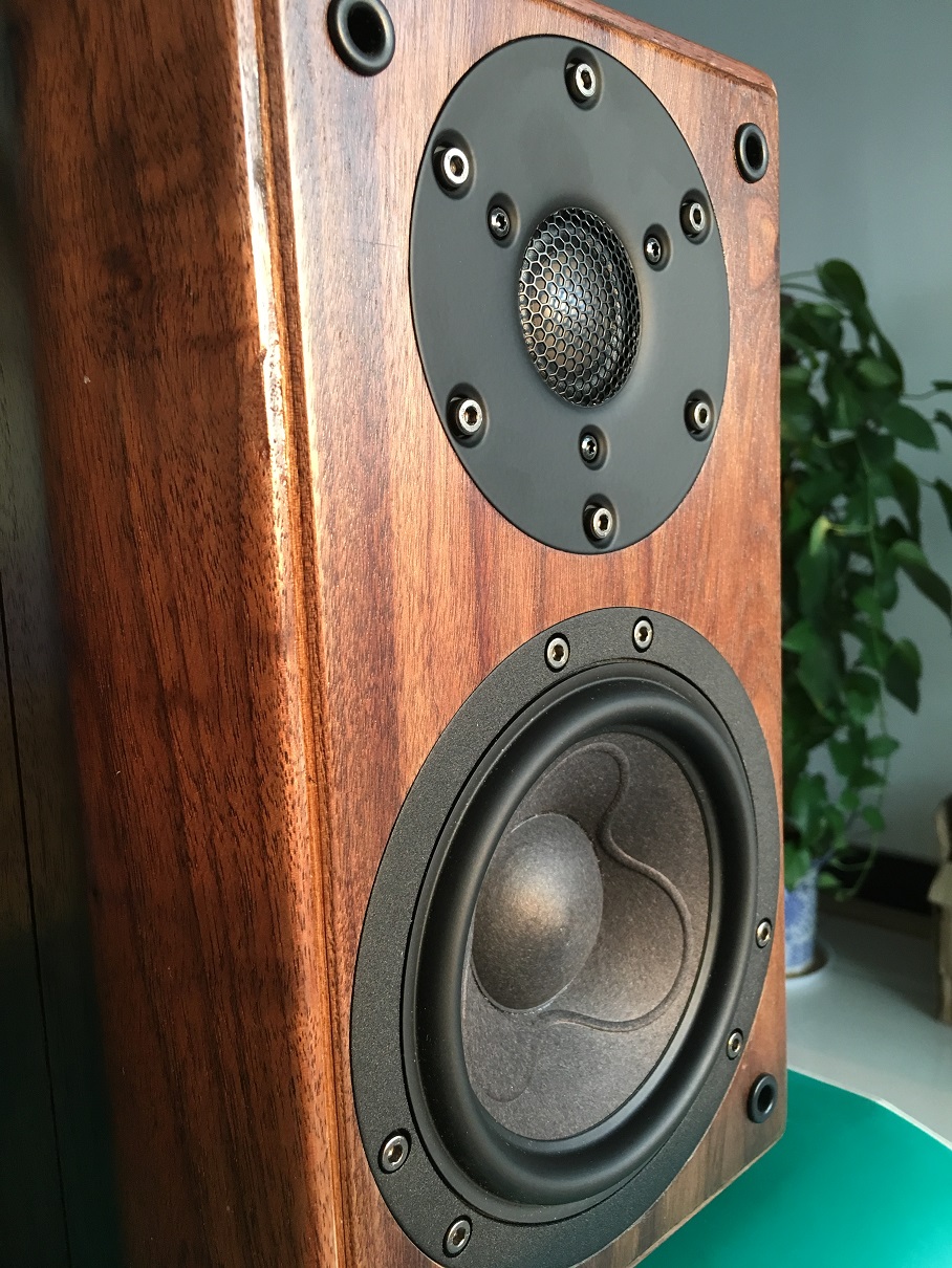

Here's my results:
http://www.diyaudio.com/forums/full-range/65061-range-speaker-photo-gallery-369.html#post4933327

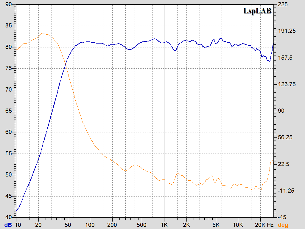

Look lovely, your happy with the sound?

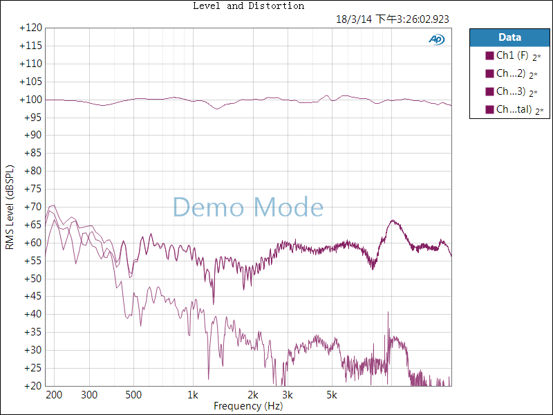

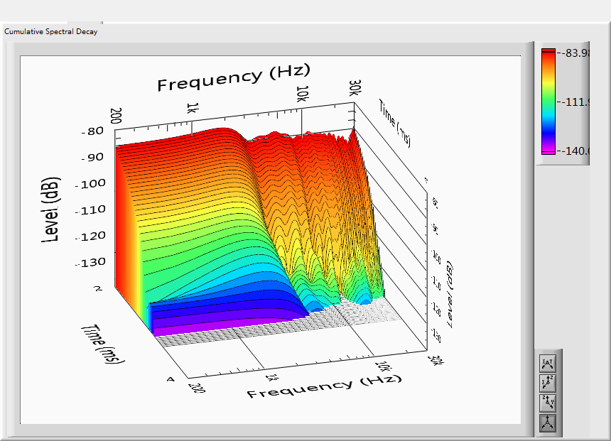

Yes, by spending weeks of time for adjust the sound. I finally make it smooth and lively. Especially for the bass, you can't believe the sound is produced by a 5.5" mid-bass unit. distortion as low as 1% @ 1m, 100dBSPL, fantastic.
