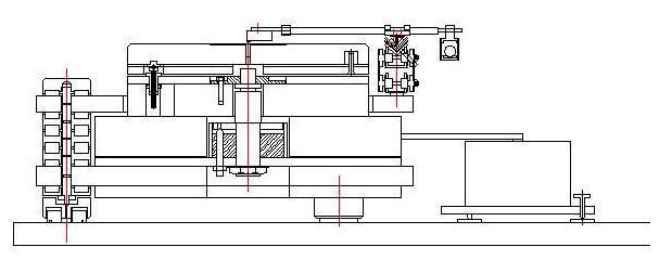

I'm with you about heavy platter: my hefty 40 kg platter project is pending implementation. Just one question bothers me: is the rather weak DC motor torque sufficient to support the constant speed rotation (not talking about start)? Should the motor torque characteristics match the platter rotation inertia (like cartrige compliance/ arm effective mass conformity)?

Hi Michael,
In order to overcome the high inertia of the heavy platter you need a powerful motor.
I use one with a 30 mili-Newton/m torque.
Once the platter is up to rotational speed the high mass and its gyroscopic effect make the motor pale into insignificance.
You'll need to put the motor on a solitary base and fix it in a high mass box because these tend to vibrate heavily.
I use an 8 kg metal bloc for that.
What kind of belt are you considering to use?
Cheers,;)

Hi Frank,
I'm planning to use Teres motor/controller, actually Maxon 110189, with max. torque 56 mNm (short time permissible overload) and max. continuous torque of 16.6 mNm. I simply have no choise but using mag tape 1/4" belt, just to keep the side load (belt tension) within permissible 5.5 N without slippage. Belt tension is to be regulated by string/counterweight force applied to the motor housing sliding on small balls. Interesting, Chris Brady starts to experiment with mag tape recently.
Thanks,
Michael

Hi Michael,
Ah, side thrust...the Maxons' Achilles heel.
I hope you won't have to use all the engineering tricks mentioned above...it seems rather elaborate.
Maybe you could use a capstan to preload the motors' pulley with a counterforce equal to belt tension?
Just a thought though...I never had to try it out so far.
