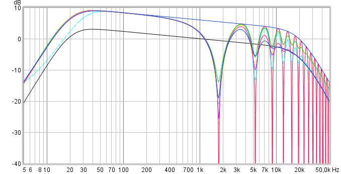

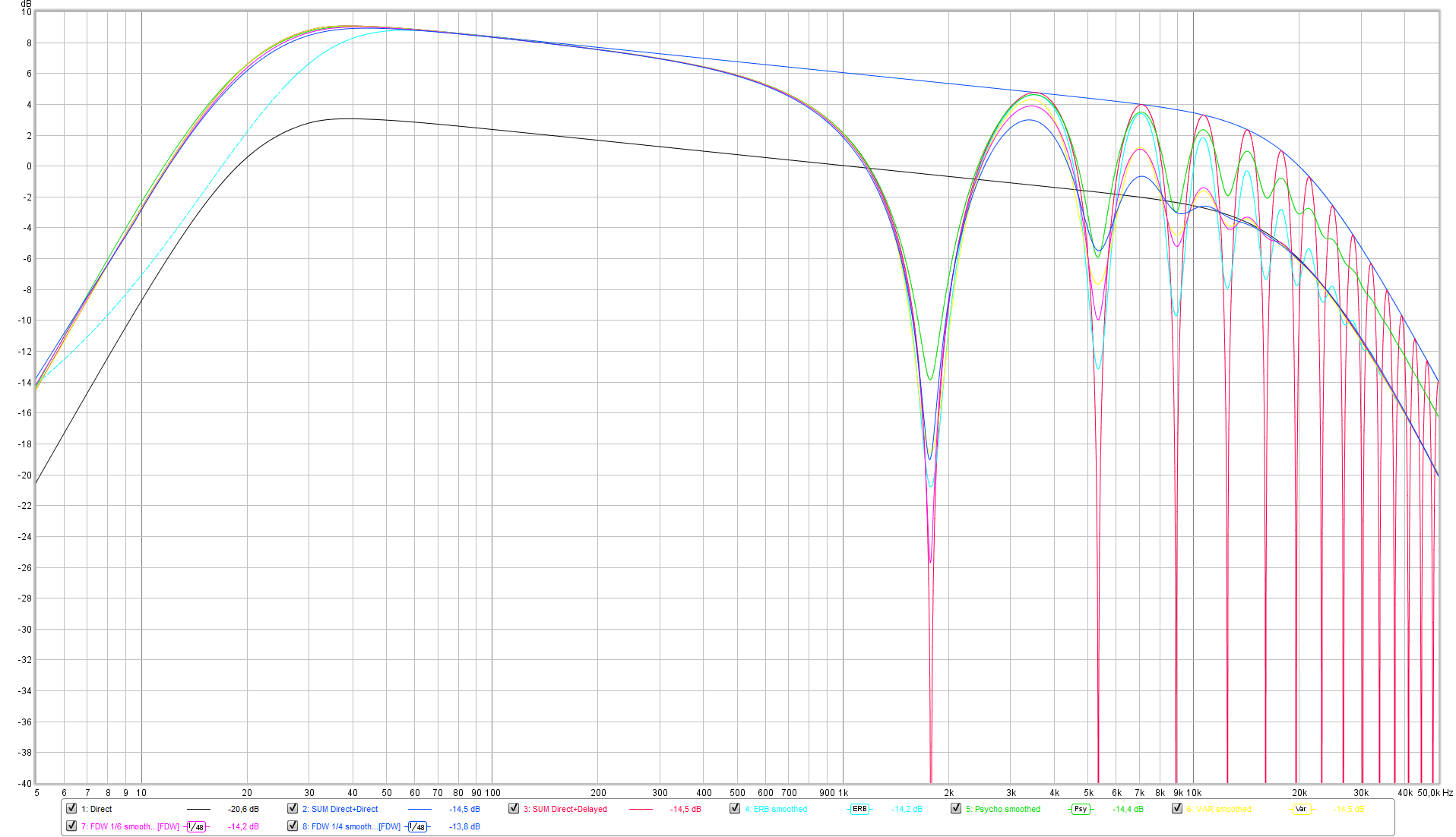

For your personal setup if i'm right its OB so agree you have solution with possibility to smooth out a mixed overall response, for point about ears plus brain smooth out stuff is right but problem with shared graph is the error is relative big compared to many comb patterns that is said to be smoothed out by ear and brain, to enlighten error is relative big see below where known smoothing or window has been added and error is still relative big, to decode what filters is used look into legend in second high resolution graph.

At a later point I added virtual reflections from lateral angles. This provided an even better sense of perceived dynamics and more holographic, 3D like imaging. The mid/side tricks are subtle, nothing like the graph posted by BYRTT, yet it helps my brain to fill in the blanks that much better. It isn't sounding bad off axis, though it did made the sweet spot a lot sweeter. Not a fixed spot, I can move and rotate my head without upsetting the balance.

Sorry for the long post, ignore me if it isn't interesting. I was reading this thread from the start, as I read a lot of threads without posting, just to hear other peoples opinions and experiences. Always looking to make my puzzle more complete. BYRTT's comb filter graph made me jump in. Not to judge anyone listening in mono, only to provide a possible alternative. It works for me with just about any music I throw at it. Believe me that it was a step up from my first days of using an idealised response for left and right channels, where only a couple of songs sounded excellent. I just could not stop there. The reason for me to build speakers was to be able to enjoy the sound track of my life, not just a couple of audiophile quality recordings.
