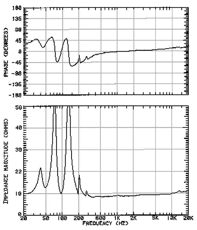

Re: Indeed,
blumenco said:
The phase of the bass flip flops a few times before it gets to 20hz, no matter the horn design. May as well use a subwoofer and deal with that set of compromises.
Impedance curve of said box. Says more about its LF behavior than a FR Note that the primamry tuning is just under 100 Hz.
