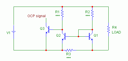

If the talk switched now to overcurrent protection (OCP), I want to remind some solution which I find the most simple and efficient way to implement OCP in high-current circuit with resistive current sensor.
I attach its picture. Its operation based on p-n junction physical effect.
I've successfully used this thing for over 4 years in my designs.
There must be matched pair of Q1+Q2 transistors on the same die, otherwise it loses sense.
Q3 is any type of same polarity.
Threshold point is defined like
I=(Et/R3)*ln(R2/R1), where Et=25mV at room temperature.
For example, if R3 shunt is 0.001ohm, R2=100kohm and R1=20kohm, then I=40A, shunt voltage drop is 40mV at this point, its power loss is 1,6W maximum.
I've found difficult to sense such low shunt drop of 40mV with LM393 comparator because comparator was more sensitive to voltage spikes which are produced by shunt parasitic inductance during converter switching operation. Transistor sensor proved itself as better choice for it.
There's no difference in which rail to put shunt: if needed into plus rail, then just to change all transistors for PNP type.
Disadvantage of this sensor is temperature dependent threshold. But it's always possible to provide some current margin for wide temperature range because OCP main function is just to help all design survive during overload.
I've also used such sensors in simple Pb-acid battery chargers with constant current/constant voltage charging curve.
Yes, a positive feedback is usually added into comparator circuit to help improve response time or make latching effect.
Looks like it is basically possible to add hysteresis into transistor sensor as well; I didn't try it though because used such sensor for current limiting type OCP, not latching shutdown. I think series diode plus resistor connected from Q3 collector to Q1/Q2 base can do such job. When thresholding, feedback resistor would be connected in parallel to R2, thus decreasing R2/R1 ratio. Certainly there also must be Q3 pull-up to allow this, actually pull-up will take part in R2 paralleling action, but feedback resistor is going to be of much higher value than pull-up (say, 470k vs. 10k).
