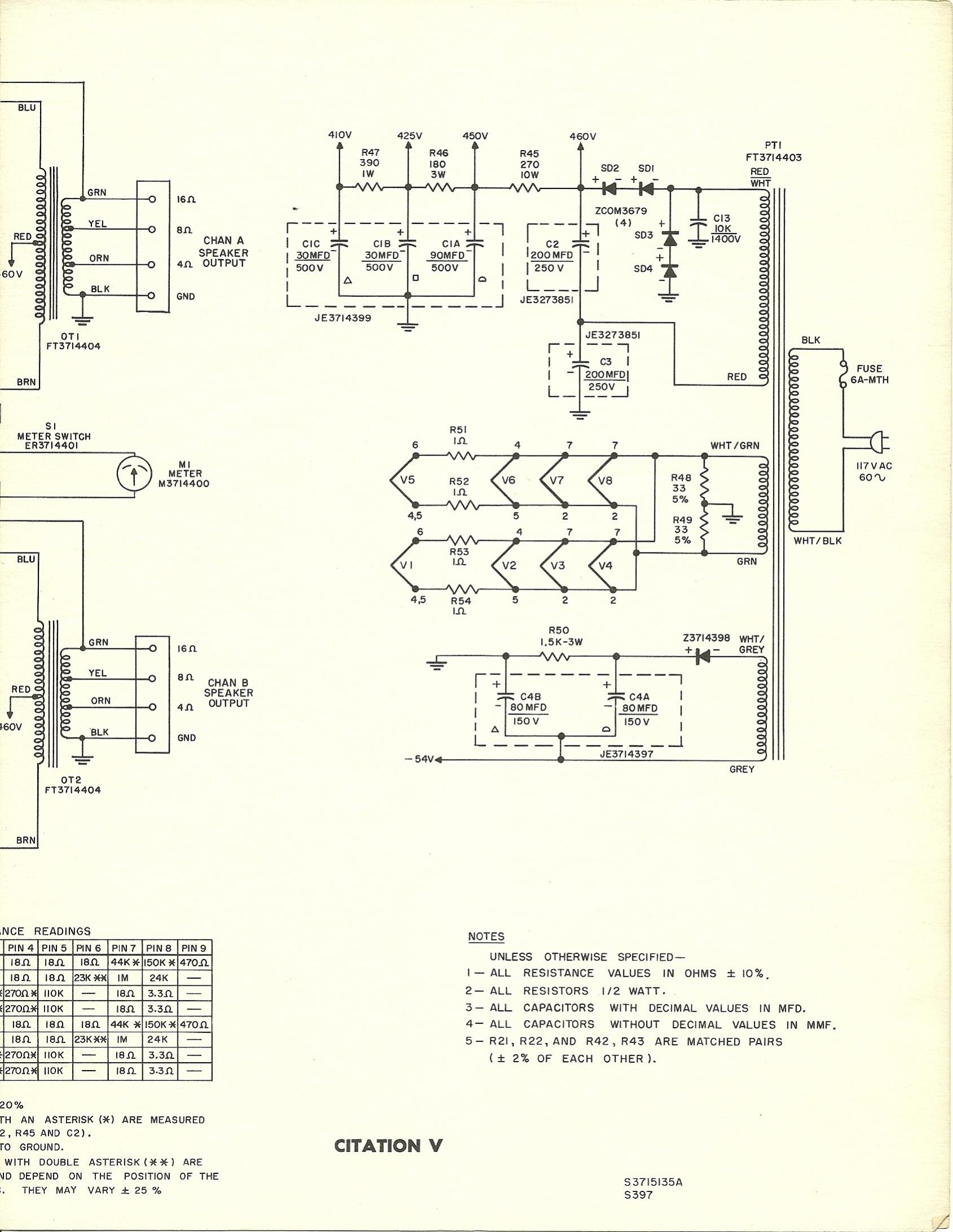

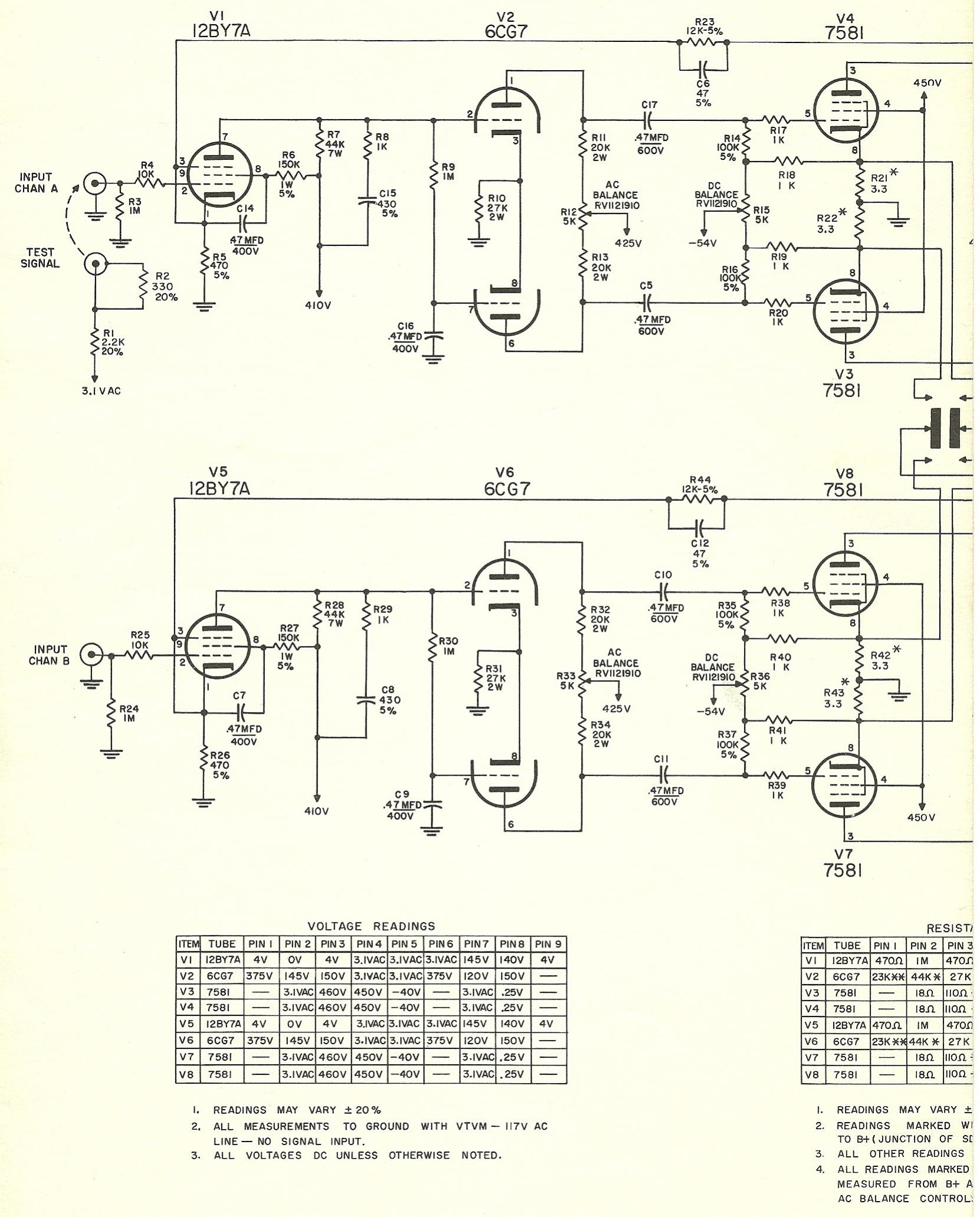

Does the thought of sweep tube finals in a Mullard circuit, along the lines of the H/K Cit. 5, meet with approval? I'm thinking 6CL6 voltage amplifier and a CCS tail loaded ECC99 as the LTP.

You guys know a LOT more about sweep tubes than I do. AFAIK, screen grid fragility is a serious concern. Those expensive Plitron separate screen grid winding O/P trafos neatly dispose of that issue. Can the "crowd" suggest a PP pair of sweep tubes that will yield 75-80 W. running in Class "AB1", that also mate well with the 2 Kohm end to end impedance of the Plitron "iron"? The OP's speakers need an amp with a good damping factor and GNFB (obviously) is a path to meeting the requirement. Whenever GNFB is employed, magnetic headroom in the O/P "iron" and infrasonic noise filtering at the amp's I/Ps are (IMO/IME) essential.
the EL509 should do it....
the HK Cit 5/Mullard 5-20 topology has been my choice ever since i made one to drive a pair of Shuguang El34's.....
