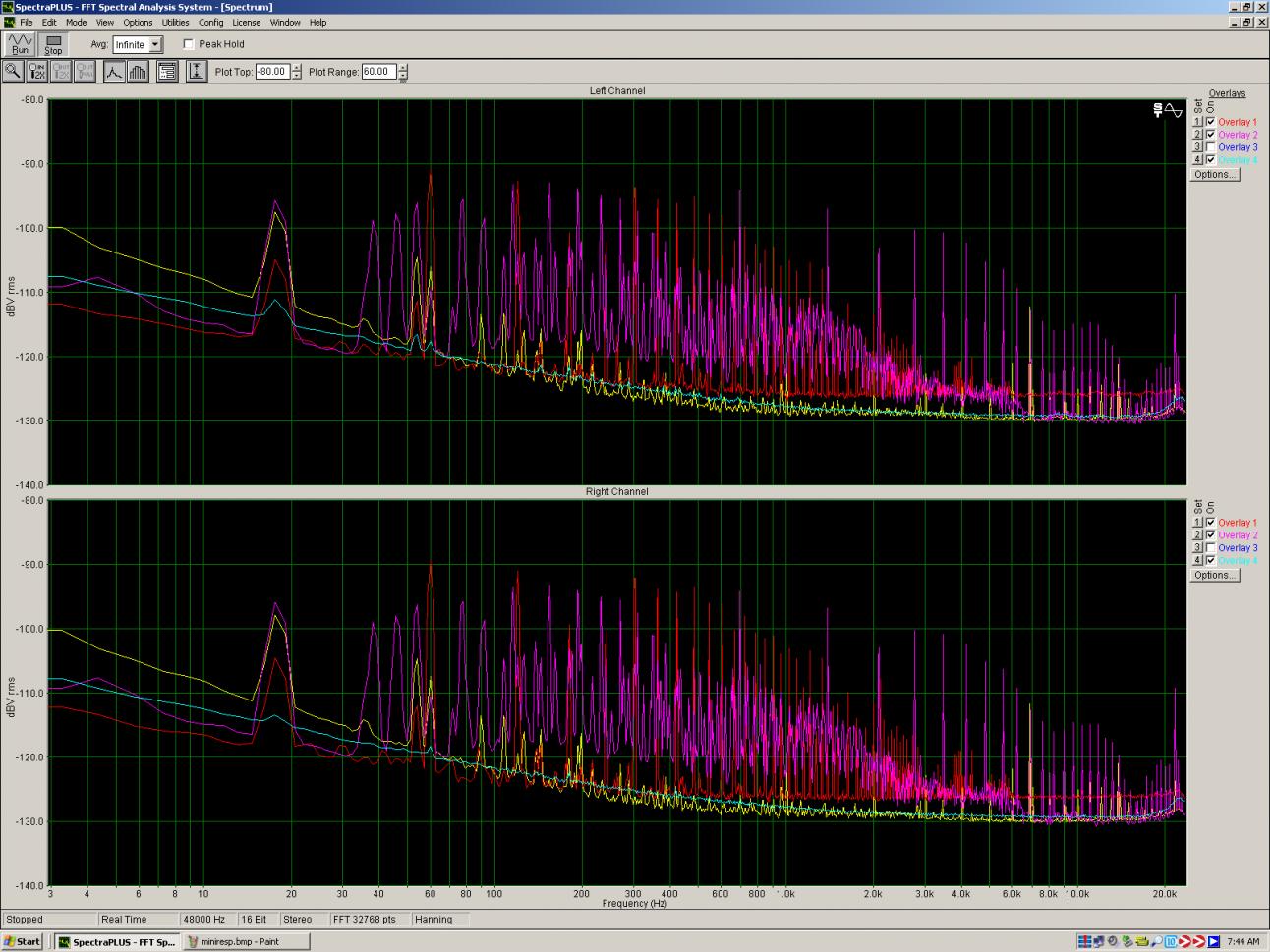

Noise floor (yellow) with a few other measurements as references. Stock DCX2496 outputs (red), line outputs from EMU Tracker-Pre (violet), noise floor of my measuring system (aqua.)
Hope that helps.

Well, you have to remember the DCX can spit out signal levels quite a bit higher than the MiniDSP. The majority of folks utilize the DCX2496 improperly, which is why there's such a variation of opinion on its performance. :)
Anyways, with any DSP devices of this type, gain structure has to be well understood and considered to achieve the best performance. Analog circuits don't (generally) have this limitation.
The MiniDSP has terrific test bench performance and the maximum signal levels are well considered (IMHO) to allow the units to be integrated successfully into a wide variety of systems.
Dave.
