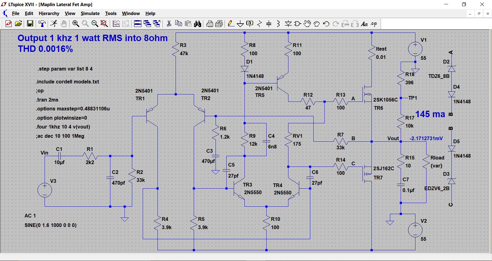

Two 13V 500mW zener diodes per FET would suffice. In series with cathodes connected, between gate and source pins.So How easy is it to add a zener Gate Clamp to help protect against a short on the output, what voltage zener, it's current rating etc, the same goes for a zener across the Bias pot, what would we be looking at here.
I think it very unlikely the bias pot would fail open-circuit.
According to the datasheet I am looking at the FETs already have internal zeners: 2SJ48 pdf, 2SJ48 description, 2SJ48 datasheets, 2SJ48 view ::: ALLDATASHEET :::

You need a zener plus a standard small signal diode (IN4148 type) per FET. Zener voltage should be no higher than 8v2 and probably closer to 6v8 to provide adequate protection given the high supply rails.
In fact in simulation even those values seem to high. You would have to measure the real device and choose an appropriate rating to keep within the safe operating area for the FET.

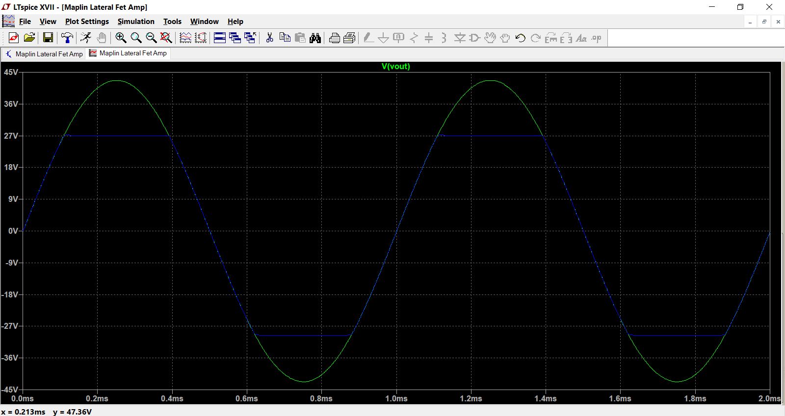

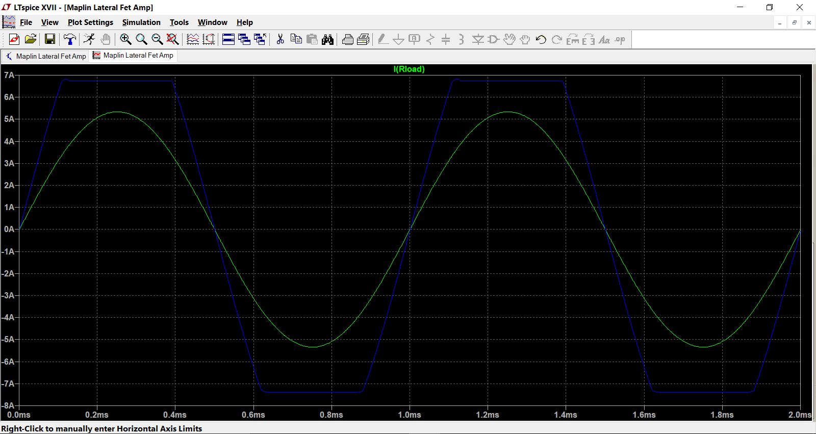

This shows 8 ohm and 4 ohm loading. The protection only triggers for the higher current 4 ohm load (blue trace).
This shows voltage across and current in a 4 and 8 ohm load with the protection circuit added.

It is very complicated to design effective short circuit or SOA protection. Given that the amps have been used for years without a problem I think the OP is better off being the protection himself by being careful not to short his speaker leads.
The gate source zeners, that are already internal to the FETs, are intended for anti-static protection during handling. They will prevent gate damage should the driver circuit go bananas. But they won't save the FET from being cremated during a prolonged short circuit condition.
I don't see how a simple zener clamp will both protect against a short circuit and allow adequate current peaks during normal operation.
Download the Lateral mosFET datasheet.So How easy is it to add a zener Gate Clamp to help protect against a short on the output, what voltage zener, it's current rating etc, the same goes for a zener across the Bias pot, what would we be looking at here.

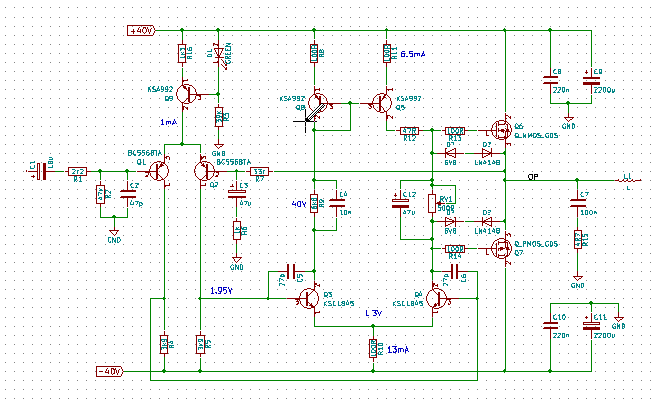

Find the SOA curves.
Look at the DC curve and find your supply rail voltage. Let's say that is 50Vdc
Now go up that voltage till you hit the DC SOA curve. It will cross at about 2A to 2.5A for all the single die 100W to 120W devices.
Now go up to the 100ms one shot line. It will probably be double, roughly 4A to 5A.
Now go higher to the 10ms or 1ms curve and note the allowed one shot current for which the device is safe.
It might be somewhere between 5Apk and 8Apk
Use that one shot transient "safe" current as a guide to the next stage.
Find the Vds vs Id plots. It has Vgs superimposed on it.
Go to the rail voltage as your Vds and go up to the power limit line. You now have the DC current where it crosses the Vds.
Let's continue with that last example where Vds=Vsupply = 50V
The 50Vds line cuts the 100W power limit at 2A for Id and the Vgs is shown as 3Vgs.
Now continue going up till you reach an Id equal to that transient value of ~7Apk. You are way above the DC ratings, but try to imagine where the Vgs plots are aiming.
The 7Vgs looks like it is aiming to asymtotically hit or very slightly exceed the 6A Id
This tells you that at 7Vgs and 50Vds, the maximum current the latFET will safely pass is ~6Apk, for a very short transient.
Select a Zener about that value to limit the transient current of the latFET to ~6Apk.
About 6v8, or 7v5 would do.
This is not the correct way to determine the Zener value but it gets the amp into the right ballpark.
There is a disadvantage in selecting the Zener as low as this. It limits the transient current when the speaker demands it.
A 1pair stage would do 6Apk
A 2pair stage would do 12Apk
A 3pair stage would do 18Apk
If your speakers demand very high transient currents you have to select the Zener to allow those peaks to pass (maybe a 9v1 Zener).
Connect the Zener from Gate to Source (it limits the gate to source voltage, Vgs).
The Zener will pass a high current if the driver or VAS sends that signal. The Zener will blow up the VAS if it triggers. You must fit a current limiting resistor between the VAS and Zener. The gate stopper can do this duty.
And use the Z+D as described by Mooly (post104).

The Hitachi/Maplin design avoids the VAS current problem by limiting current to about 13mA. This allows the zener to be connected to the VAS end of the gate stopper and avoids the RF stability issues of long tracks on the gate.Connect the Zener from Gate to Source (it limits the gate to source voltage, Vgs). The Zener will pass a high current if the driver or VAS sends that signal. The Zener will blow up the VAS if it triggers. You must fit a current limiting resistor between the VAS and Zener. The gate stopper can do this duty.
