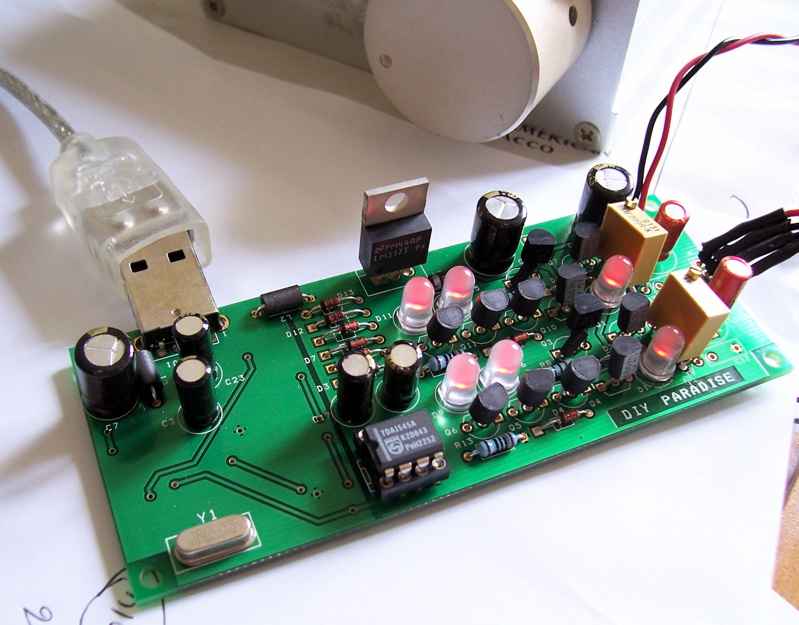

The Monica USB DAC had it's issues (broken GND plane) but would be a place to start (esp with jocko style IV) but isn't available:
Monica does USB!
USB Monica DAC | diyparadise blog

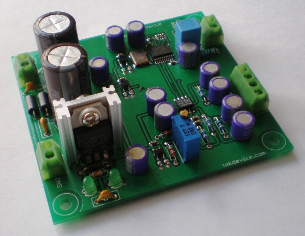

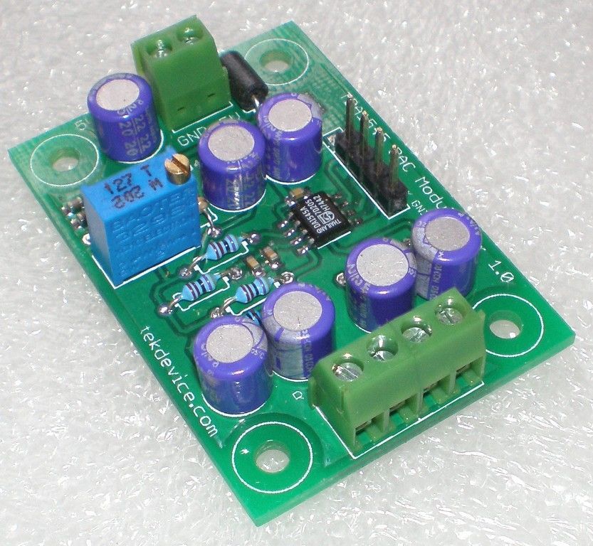

I just ordered these:
TekDevice Philips TDA1545A Right Justified Only DAC Module Passive Resistor I/V
Tekdevice Philips TDA1545A Right Justified Only DAC Module Passive Resistor I V | eBay
and
TekDevice Philips TDA1545A WM8804 SPDIF Coaxial DAC Board Passive Resistor I/V
Tekdevice Philips TDA1545A WM8804 SPDIF Coaxial DAC Board Passive Resistor I V | eBay
Critique of there boards?
(I'll let you know when they arrive and take some pics)

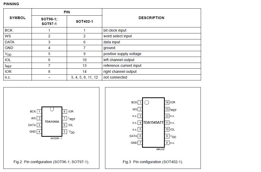

I shall be doing a layout for a very simple TDA1545AT board to fit on top of one of my hexacaps. I'll put up the schematic and layout on http://easyeda.com/ so anyone interested can clone it or mod it. I already have an output buffer schematic (AD815 based) up on there. If anyone's interested in that I can share it. After the DAC board will come a passive filter board - 11th order Chebyshev LC.
Right now the design is in progress, eventually there will be PCBs (later this year). The idea is you can order PCBs using the EasyEDA website. A whole DAC can be built up from a succession of small PCBs.
Unfortunately the TDA1545A is EIAJ input, but I think I'll make the board generic enough that TDA1387T can be used instead, which is I2S input. I'll be working on a DIR9001-based S/PDIF receiver board too which can give out I2S or EIAJ.

As well, tekdevice also has a TDA1387 (1545 with I2S) board. Search for:
TekDevice Philips TDA1387 I2S DAC Module Passive Resistor I/V

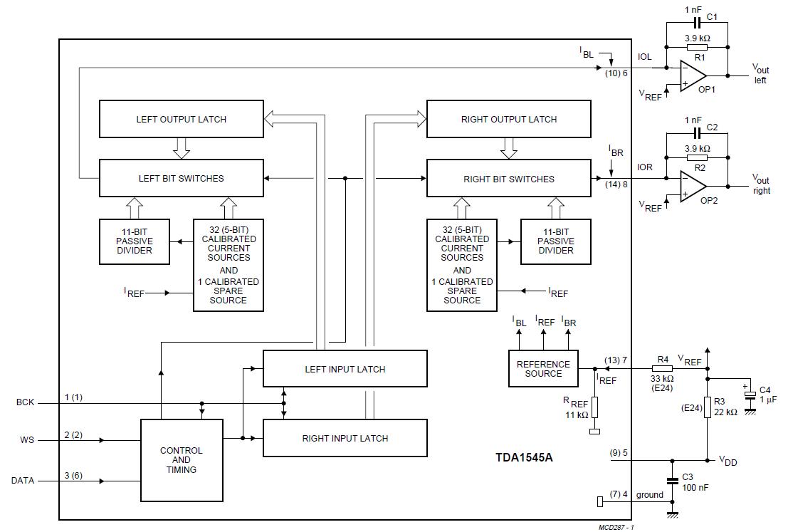

I'll take it in small chunks, going back to basics.
A current output DAC has a voltage compliance specification, that's the allowable range of output voltages permitted on its output pin(s). In the case of these 8pin chips, the outputs are pins 6 & 8.
Internal to the DAC is a digitally controlled current source (the DAC proper) and a further current source, called the bias current in the DSs. The DAC proper lies between the output pin and the 0V supply, the bias current source is between the output and the VDD supply (pin 5). I've found that in the case of the TDA1543 at least, it sounds best without the bias current source switched on, however while this trick is possible on the 1543 its not on the 1545 and 1387. The operation of the bias current source appears to be non-negotiable.
The magnitude of the bias current sourced from VDD is proportional to the pin7 voltage, the same voltage also scales the full scale current of the DAC proper.
On the TDA1545, the output compliance runs from 2V to 1V below VDD so is theoretically zero when the supply is 3V meaning to use passive I/V the supply voltage needs to be at least the output swing plus 3V. I've tended to go for 4-5V supplies and normally I've set the output voltage somewhere near 2.5V as this is simple to generate with a TL431 shunt.
To be continued...
To be continued...

Back to the arcane matters of DAC output biassing for a while... An alternative with the TDA1545A which I've not tried is putting the I/V resistor to ground and then biassing it up to a point within the output compliance range. For a 50ohm I/V resistor (which I use because that's the input impedance of my filter) a fairly heavy current (50mA) is needed to achieve 2.5V so not really an option for where low power is called for (portable applications). The CCS should also be chosen carefully for low noise and decent PSRR.
The TDA1387 provides a much more elegant solution even though it calls for an extra -ve supply for the post amplifier (AD815 in my case) because most amp chips can't work with the input voltage so close to their -ve rail. There exist rail-to-rail input opamps though that can, so these are worth a try when the AD815's fairly hefty current draw can't be tolerated.
