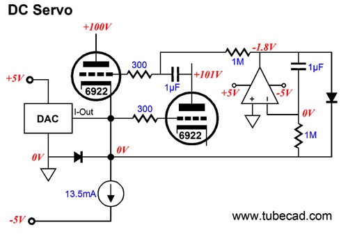

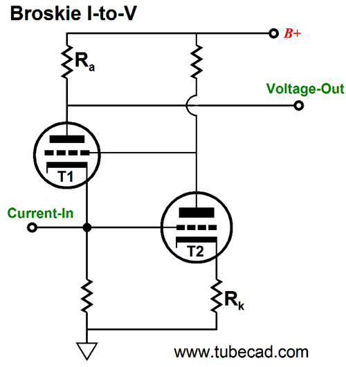

You can find a good explanation about the I to V circuit in the Broskie's article.
Yes, his wording is "A varying current enters the circuit and develops a varying voltage as it encounters the resistor and the (T1) triode's cathode impedance in parallel with the resistor."
You have no resistor but a CCS (infinite impedance?).
I was just looking for your wording around this.
In the schematic I posted the resistor is the CCS itself (high impedance) in parallel with the triode's cathode impedances, so practically the triode's cathode impedance.

Forgive another ignorant dude but L3 bead, is it to stop grid oscillations or to cut uhf-trash from the DAC-chip instead of LP-filter? Or something else maybe?
And why is C1 so big? There must be something there I dont understand. 0,1 uF would be much with a 1 M gridleak usually.
With such that gain, the bead prevents EMI/RFI. Maybe you can use a grid stopper with the 6C45 tube, I prefer the bead. With the tube named The Queen the bead is a good rule, also in the cathode circuit.
An LPF could be used at the output of the DAC rather than before the grid of V1. Someone likes to limit the bandwidth of the TDA1541A, others not. I believe it's a personal choice. Since I'm thinking to a system rather than a simple DAC, I'm planning to run the TDA in NOS at 176 KHz, so I'll avoid any LPF.
About the C1 cap, maybe you can use a 0.1 uF. John Broskie suggests 1 uF in his "more fleshed-out version".

From Thorsthen:
"In practice and with real tubes you will struggle to keep the input (and thus the TDA1541 Output) correctly at 0V, unless you add a servo.
Additionally, the circuit you show uses large amounts of negative feedback to get the very low input impedance and it has several capacitors (including an electrolytic capacitor) in the feedback path.
It may a better choice to just use a decent Op-Amp (OPA637 would be my choice).
In the end it is down to personal preference of course."
The Broskie I to V (and my updated vesion) is a bit different:
there is a DC Servo
almost no phase shift in the feedback loop
no electrolytic capacitor, C5 could be omitted, adding a little local feedback, the eternal question: bypass the cathode resistor or not?
