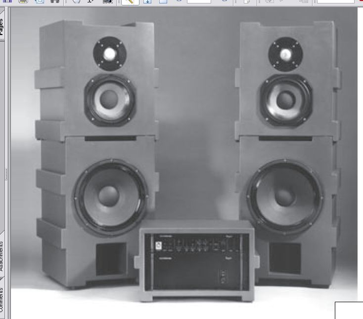

Most probably not?, musical instrument speakers and HiFi speakers are completely different items, with completely different purposes.
I wouldn't bet on this one. German mfgr "Glockenklang" once built a high-quality threeway bass-box. The standard setup was in stereo BTW.
Regards
Charles
Edit: You will find a picture of the setup in the upper part of the following document:
http://www.glockenklang.de/pdf/de/prospekt-03-06.pdf
Like I said, designed for different purposes - a bass guitar cab is designed for maximum volume from the bass guitar, a HiFi speaker is designed for maximum quality and bass extension, and sacrifices volume to achieve it.
But interesting looking speaker though - I wonder how well it worked?, and if it was intended for bass guitar or multi-purpose use?.
It was actually aimed at bass-players. The whole setup was exorbitantly expensive, in the order of a small car back then. It seems that it was quite heavy and impractical. But a tester remarked that it was basically a high-quality and high-SPL stereo.
I am of course aware that stage equipment is optimised for the most SPL per -buck, -kilo, -watt etc.
But hearing a bass played through a system that is really broadband, low distortion and high SPL is quite a treat.
Regards
Charles
Hi, definetely not your average mono 4x10 + 1x15 stack, ;)/sreten.
