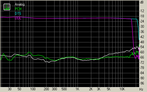

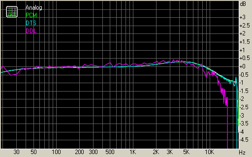

The first observation was that of the two means to transfer 5.1 channels digitally - namely Dolby Digital Live and DTS - the DTS signal was better than DDL, with better flatness and less drop-off in the high frequencies. But everything else, including analog, was pretty similar.

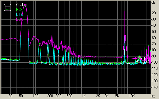

Also, both DTS and DDL had poor stereo separation compared to everything else - I'm not sure if this is by design or because of some surround effect that I overlooked and didn't disable.

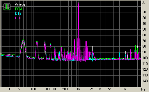

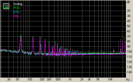

Sadly, all routes resulted in a pretty poor -70dB spurious-free dynamic range. Mostly, this was due to a 60Hz hum and its harmonics.

Frequency Response
I agree, it's most likely not including the class D amps - to test that, I think I would need to wire a transformer to the speaker output to get a line level signal from the low voltage, very low impedance output - or is there a better way?
I think the headphone out would be the best possible output, though. It's unlikely (but certainly possible) that the headphone amp should be worse than the power stage. Also, this is only meant to be a starting point, I am basically interested to see how much better the headphone out on other comparable systems can be. Also, if we agree on a simple testing method for the speaker out, I'll be happy to repeat the measurement.
Simple testing is better than no testing. It's a starting point.
I'll try to post the results below.
Test conditions: 16-bit, 48kHz DAC / ADC.
Sound card: Bluegears b-Enspirer (CMI 8788)
Receiver: JVC RX-D301
Analog: Analog to receiver, analog (headphone) back to PC
PCM: 48kHz PCM to receiver, analog (headphone) back to PC
DDL: Dolby Digital Live to receiver, analog (headphone) back to PC
DTS: DTS Connect to receiver, analog (headphone) back to PC
Frequency Response
