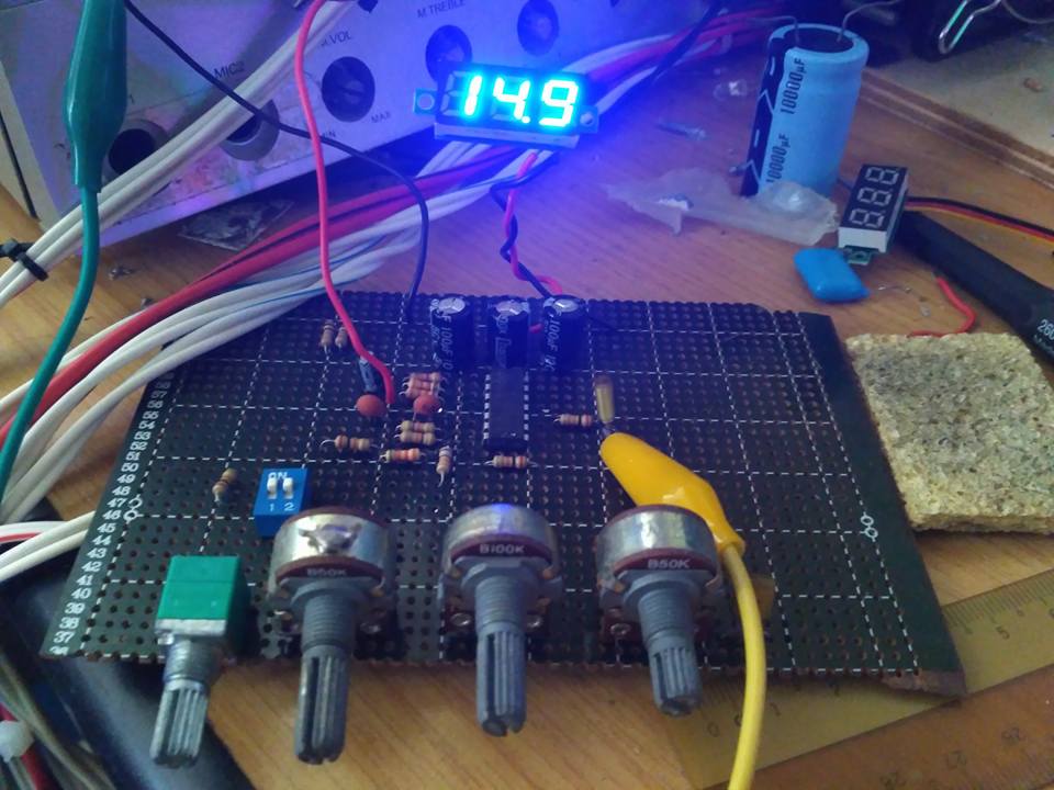

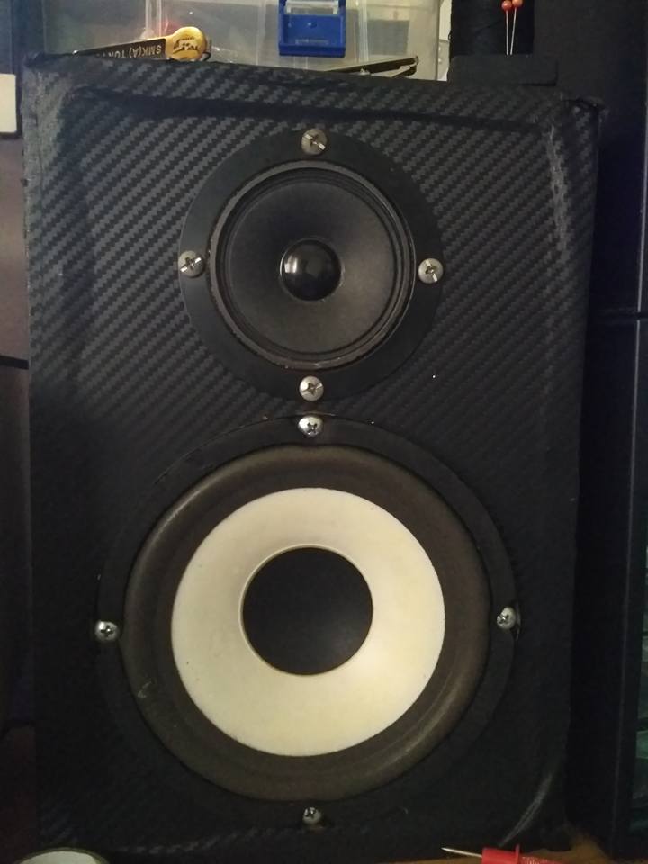

:D perhaps these photos explains better ... existing 2way stereo amplifier with xover onboard (with tone controls) ... another board independently controls the subwoofer hence name it subwoofer controller unit (consists of variable subsonic filter, variable Q factor Adjust, Variable low pass) ... and the last one is of course the speaker itself (2way speaker) in current active biamp setup ... BTW the amp and circuit boards were off chassis ... the chassis now is under rebuilt progress ... sort out wiring issues and addition of LED strips force me to use my amp off chassis ... :D
FYI i am not going to use these set of speakers anymore ... what exactly i am going to do from now on will add another set of stereo LM1875 and change the existing crossover from 12db oct LR to 24db oct (4th order). And also rebuild new speakers.

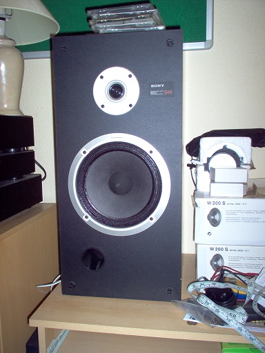

The midbass is the weakness, it doesn't really do what I like in the midrange. This is why a three way (here a Sony with classic low mechanical loss SEAS drivers) is better:

Bass units can be what you like, but listen to Troels on low mechanical loss. You don't even have to throw a lot of money at that. I have a retro 8" Sony woofer (and Eminence still build woofers like this, for example the Eminence Alpha 8A unit) that is hard to beat on musicality:
626011d1500178190-classic-monitor-designs-sony_e44-jpg

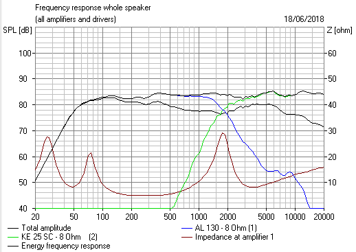

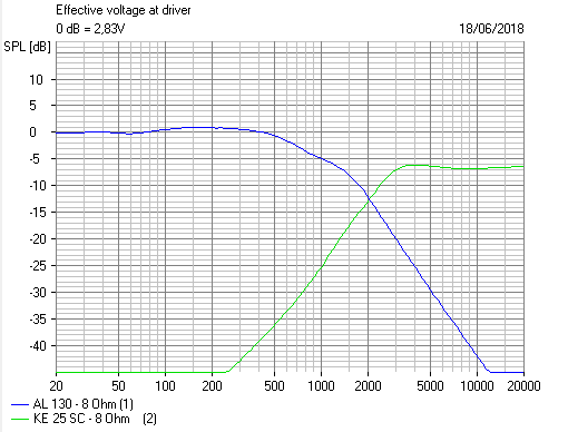

Cabinet effects need bafflestep correction. Driver responses aren't flat. Below is the default Boxsim project for a small 5" plus 1" system. A simple electronic LR2 at 2kHz won't hack it.
To get it to work, you need ruler flat drivers in their cabinets, and maybe let the bass and mid crossover exactly at the bafflestep point. Time alignment will also play a part in phase matching. I suppose this is why good electronic crossover systems are expensive.
Here's John Kreskovsky's designs: Offerings
