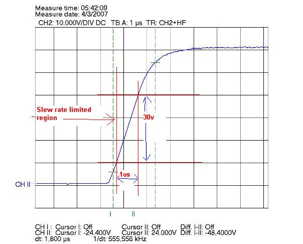

Hey, Glen don't spend your time in this confused - caused from me as well and from you - topic.
I am sure that you have the expertise so you can understand very well that i am not a novice in audio electronics. The same i believe for you.
But i become nervous many times, when unskilled persons ask from me - when i publish a project with documents such curves from scope and not only by writing hypothetical numbers - data without meaning such slewing. Many people they impressed from big numbers and they can't understand the bandwidth from the curves of rise time. They confused between speed and bandwidth, while slewing limit or rise time related only with the bandwidth limit in the upper region of spectrum under stability.
I have seen many times in manuals of comercial amplifiers, the simple numerical reference of a slew rate of 130V/ìs, while in curves quoted a rise time of 1,9ìs. And i wondered, where is the curve represents this amazing slewing?
The answeer is that, this slewing it is measured without the existence of in-out, global-nested feedback filters in their place. Thus - i have tried also me many times to make such measurement without success - we can obtain a lot of spikes, overshoots, harmonics etc etc in output. What is usefull of them?
To cause impression in people?
Instead there are many comercial amplifiers which sincerelly they report the slew rate as 40V/ìs (obviously measured from a curve such mine). Also there are many other constructors which don't reffer the slew rate.
To make the thing short, there are two slew rates. The one without the restrictive filters in the circuit, and the second with these filters in place. I am suspicious that the reference in the first it is for causing impressions, because i can't understand in what it is usefull. Also i am curious to see at least one time this curve of 120 or 300!!! V/ìs. Have you in your stock a such curve of the named extrinsic slew rate to solve my query?

If you have a scope and a square wave generator - there is not the need of a dummy load so much - can you please inject a 20KHz square wave in the input of this beauty, so its output swings at 50% of full level for safety? And if you can do this, can you post a photo from the screen of scope?
A such document can resolve all this senseless discussion about slew rate (EXTRINSIC and INTRINSIC!!! Wow! What about a scientific expression!!!).
If this amplifier has a 300V/ìs s.r. as refered by my friend Mooly, then the curve at 20KHz must be presents almost a perfect angle of 90deg at the rising edge corner.

This is the reason why i am grumbling
In the following 3 docs, you can see the refered slew rate of 125V/ìs in the first, and in the two next the curves indicating the rise time curves. Your conclusions Clen?

Figure 27 it is probably fake!
By looking it, with my falcon eye :D- expertised for 25 years by looking in screens of scopres as well in docs - i believe that the nr.27 figure in 3rd photo it is fake. It is not possible the increase of supply by 31V to offer a such reduction in rise time as it is presented. A good reason is that; it is not reffered the vertical scale graduation.
To not missunderstand me, i know very well that the symetrical input stage - or the double LTP pair - it offers a better rise time by 20% at least from the single LTP input.
You can obtain the whole project by typing in your browser "AN1308". Then, select what is refer "motorola".
