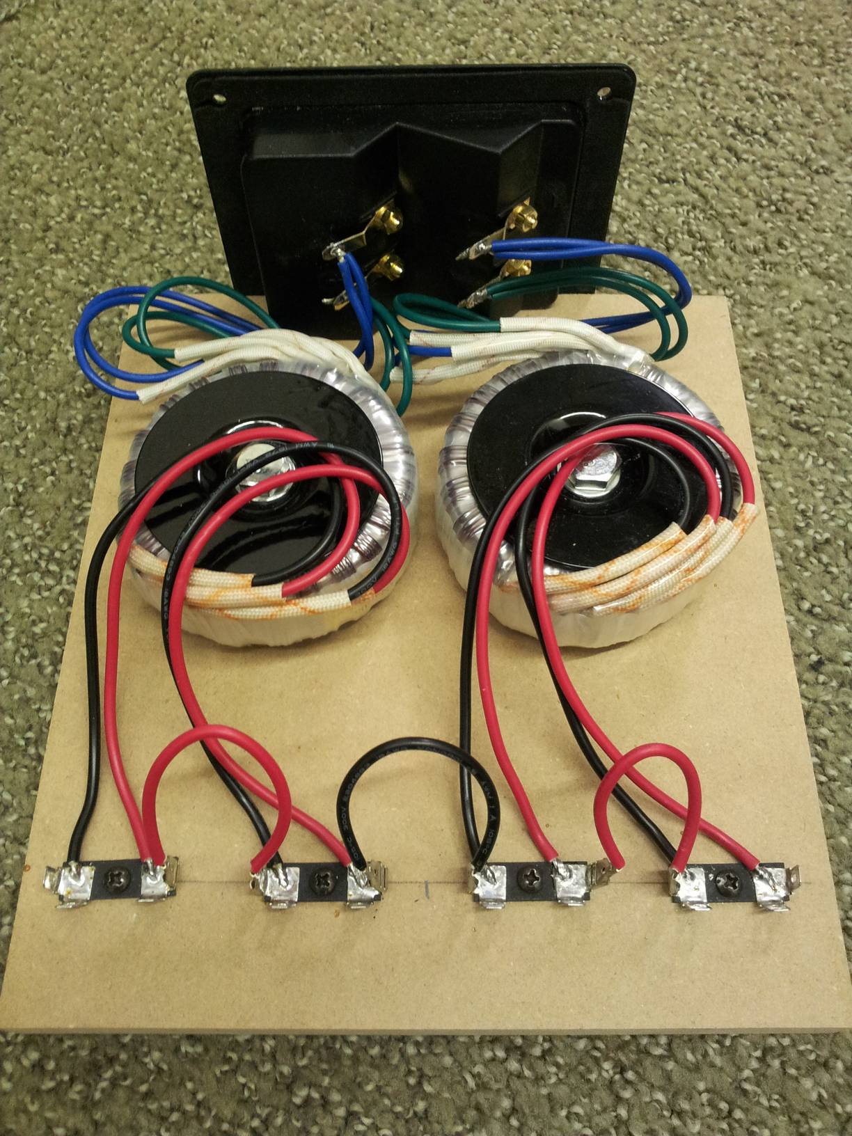

Measurement of parasitics
Two transformers were hooked up in the usual manner with all 6v volt windings in parallel and all the 115V windings in series. See attachment .
Step-up ratio = 1:74
Leakage inductance = 2.5uH (all leakage reflected to primary)
Secondary winding capacitance = 1000pF - 1300pF (depends on series order the 115V winding )
So, driving a ~ 1000pF ESL panel like CharlieM’s would be no problem whatsoever.
In fact, even a 2000pF load would not drop the HF bandwidth below 20kHz.

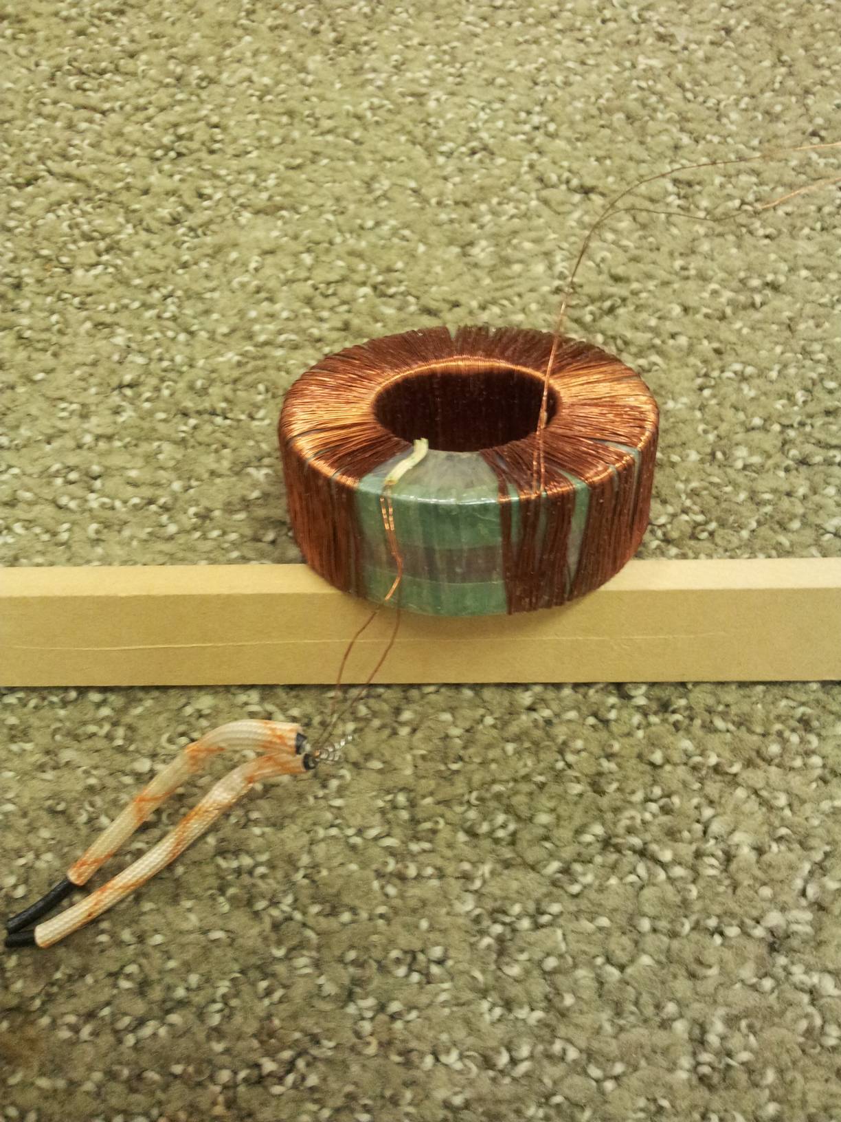

Antek Toroidal power transformer for Step-up, De-construction (part 2/2)
Ok, so now on to the elephant in the room…
What about the potential for arcing between the 115V windings?

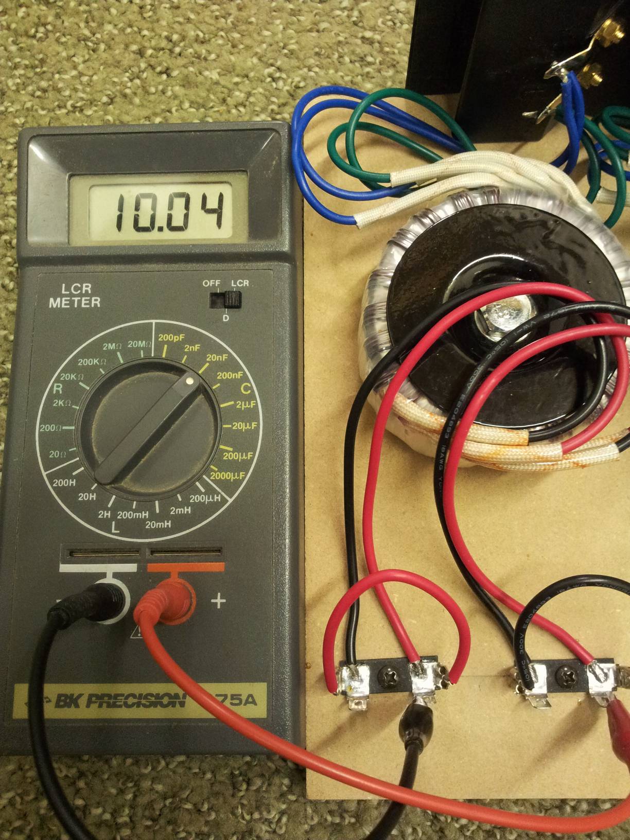

The first thing I did was measure the capacitance between the two 115V windings with ends shorted as shown in attachment (1).
This would give an idea of how physically close the two windings are to each other.
If they are separated by some insulation, the capacitance would be less. If not…more.
Measurement showed 10nF = 10,000pF.
Hmmmm…this says that if there is insulation between them, there isn’t much.
So, nothing left but to unwind the transformer and see what is what.

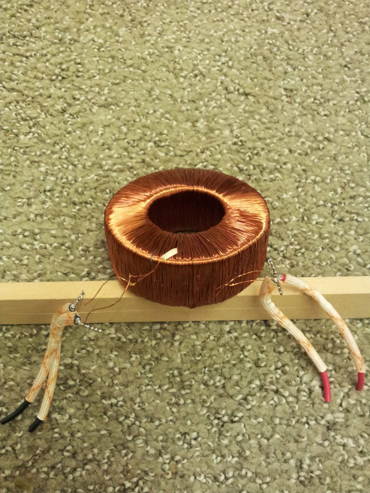

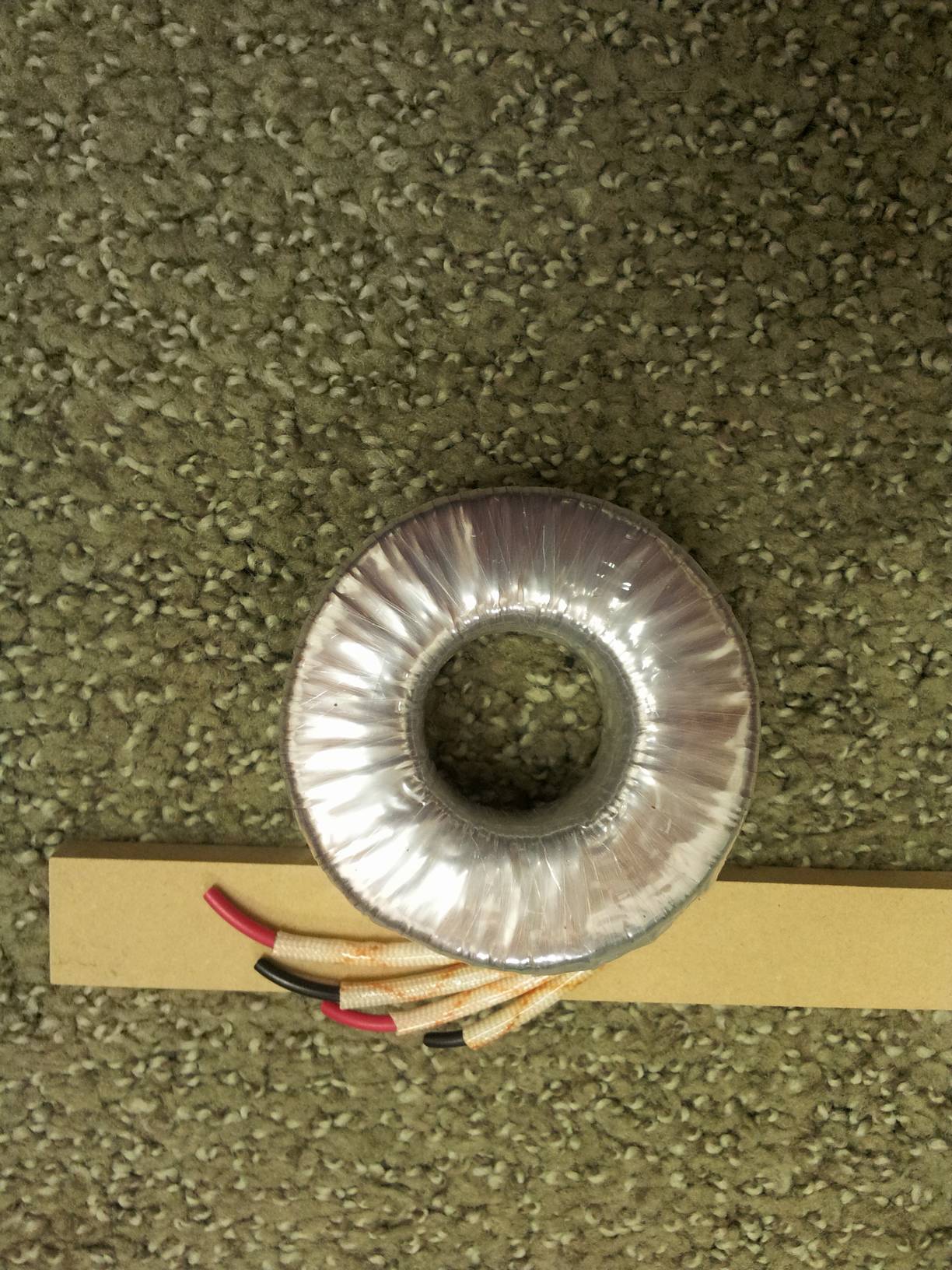

Attachment (2)
Outer insulation tape removed revealing the two 44 turn primaries.
Attachment (3)

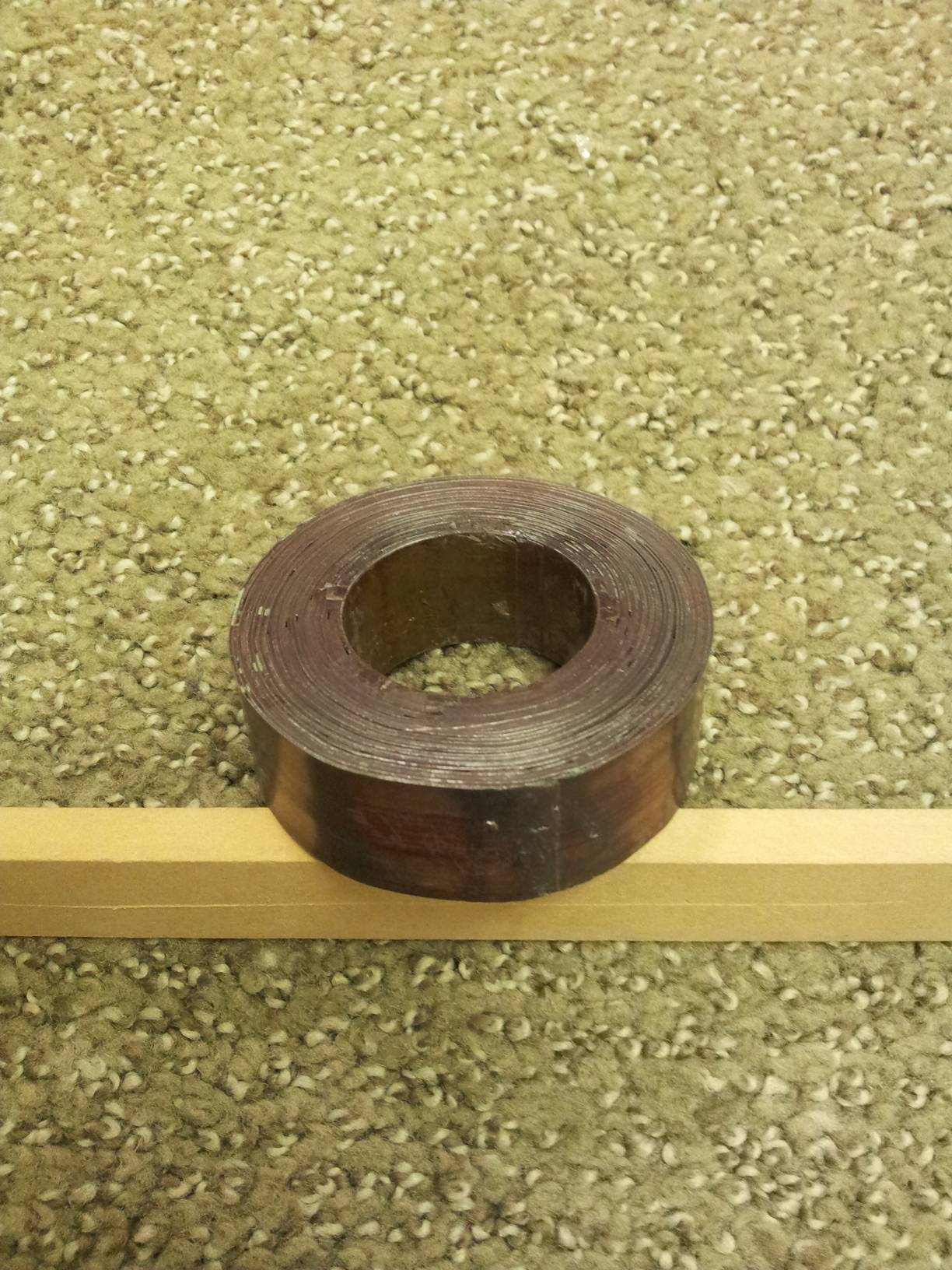

Primaries removed revealing primary-secondary insulation layer.
Attachment (4)
Insulation layer was made of up 6 layers of 2mil polyester….undeneath, the secondaries.

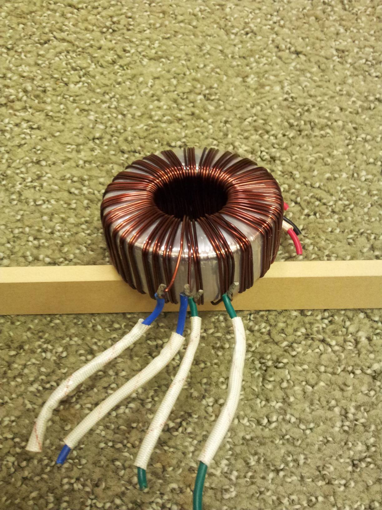

This does NOT look good, seeing both the black wires leading off together to the start of the winding.
Attachment (5)
Unwinding the secondaries revealed that the two 115V windings are wound at the same time next to each other, so bifilar wound.
No insulation between them other than the enamel on the wire.
Attachment (6)
The raw core.
With bifilar 115V windings hooked in series and 40Vrms applied to the primaries the output voltage would be 40Vrms x 37 = 1480Vrms.
The voltage between the two secondaries will be half that, or about 750Vrms.
Now the question is, can the enamel insulation stand up to this voltage?
I think the answer is that it depends on the exact formulation of the insulation and its thickness.
So, I'm not sure if we really know any more than we did before concerning whether these transformers will be realiable when used used as ESL step-ups.
But, I am $13 poorer ;)

Very Nice Report Bolserst !!!
It is good too now know the characteristics of that transformer.
The parasitic capacitance seems to be quite on the highside ,about 60% to 100% higher than the cores that I have any how ,But at least they do work well.
I have been planning on doing this same thing with my cores as well.
Are you going to add some insulation to try and see how far you can bring that residual capacitance down and rewind it?
I plan on doing this with my cores as the panels that I am messing with won't be much more than 500pf right now.
So all that extra transformer capacitance becomes a waste of amplifier power.
In my extreme tests I didn't experience any problems of arcing between the windings that I know of at 25Kv P-P.
Except one time I had a snap or two between two stacked cores as the air was ionizing between them and they where separated by a 1/4" gap.
I had no shorted or open windings and had no change in the measurement of the transformation ratio.

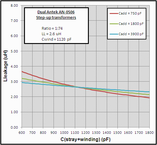

How did you determine the capacitance of your windings?
Did you use a capacitance meter or the resonate method?
You can measure leakage inductance fairly easily by hooking up an inductance meter to the primary and shorting the secondary windings.
But, I don't know of an easy way to directly measure the winding capacitance.
The best way I have found was documented in a thread here:
http://www.diyaudio.com/forums/plan...ruct-cube-louver-acoustat-14.html#post2181730
It is kinda cool because you determine both the winding capacitance and the leakage inductance at the same time.
I usually plot curves for 3 or 4 different load capacitances.
If all the measurements were done well, the curves will all cross at one point on the plot indicating the leakage inductance and winding capacitance.
See attached plot for a sample of one set of the Antek measurements.
It is good to see that the leakage inductance is low and the photo's prove why.
Leakage inductance is proportional to the square of the primary turns and inversely proportional to the length of the winding.
So having only 44 primary turns is good. And having complete coverage of the toroidal core circumference is a good thing.
See middle of this post for leakage inductance formula.
