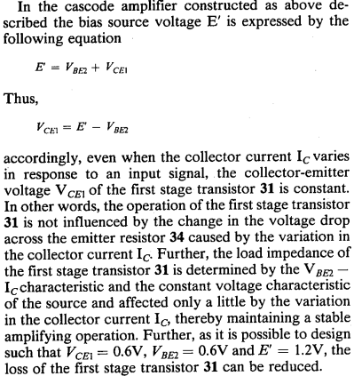

I don't imagine you as a flaming threadster, Dimitri. Actually
I assumed that you confused the two different designs. I'm
perfectly proud to have designed something before Hawksford,
and less happy to have been anticipated by him on another.
If there is something else at issue, I think you should express it
here, and I doubt anyone will accuse you of flaming.
It's hard to say without seeing the surrounding circuit in which the cascode is operating.Or perhaps even more interesting, why *any* cascode degrades the sound
It's a useful device for voltage/power shielding. Otherwise, hard to see how the benefits outweigh the cons in a typical power amp.
But the mathmatical analysis is fun for masochists and institutional types.
For purposes of discussion, there is a tendency to take conceptual groups of devices and apply names to them. Thus, two devices may become a "differential" whereas a different arrangement of the same two devices becomes a "cascode." Purely as a descriptive convenience, we have agreed to call these "one gain stage."
Yet the signal still goes through two or more devices, each leaving its subtle fingerprint on the sound.
