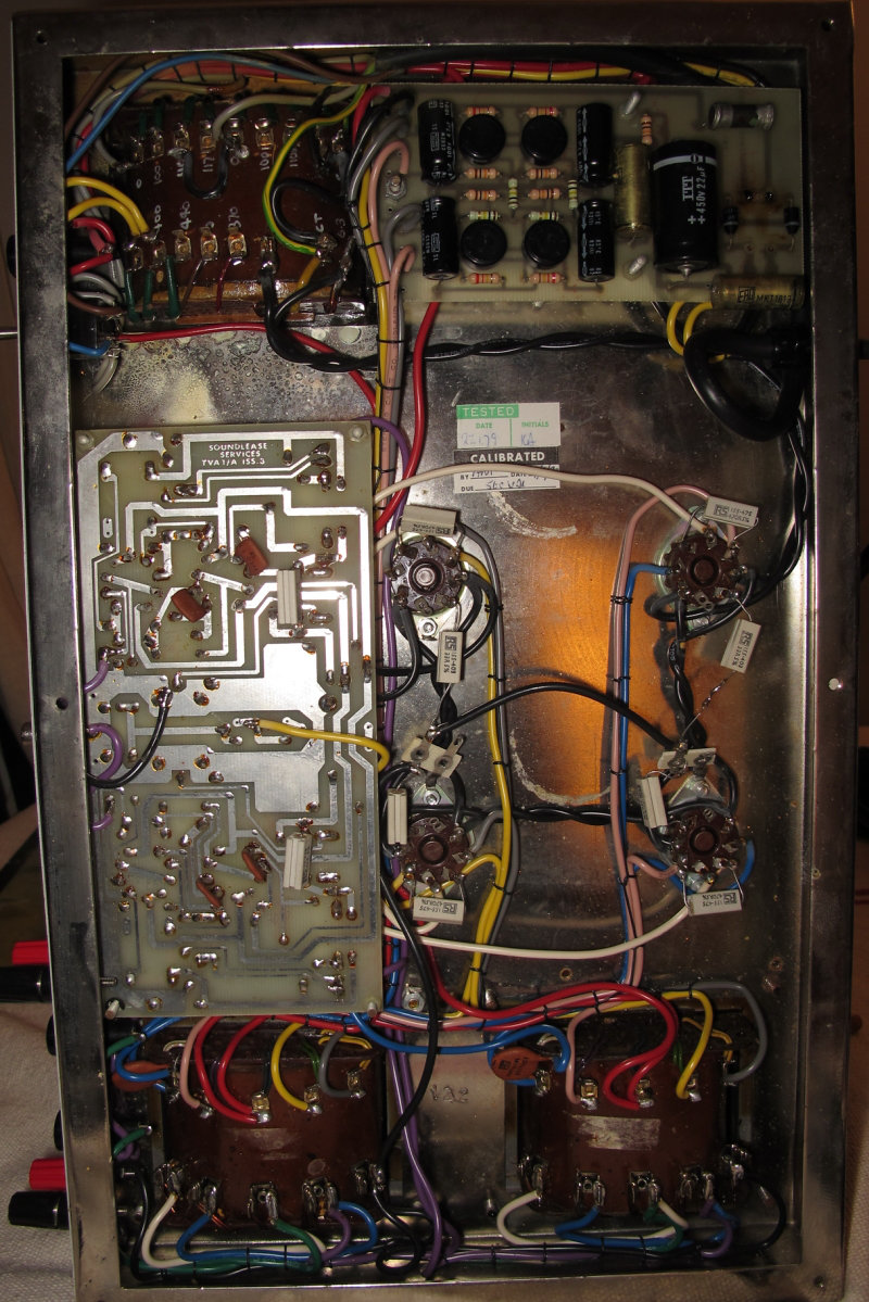

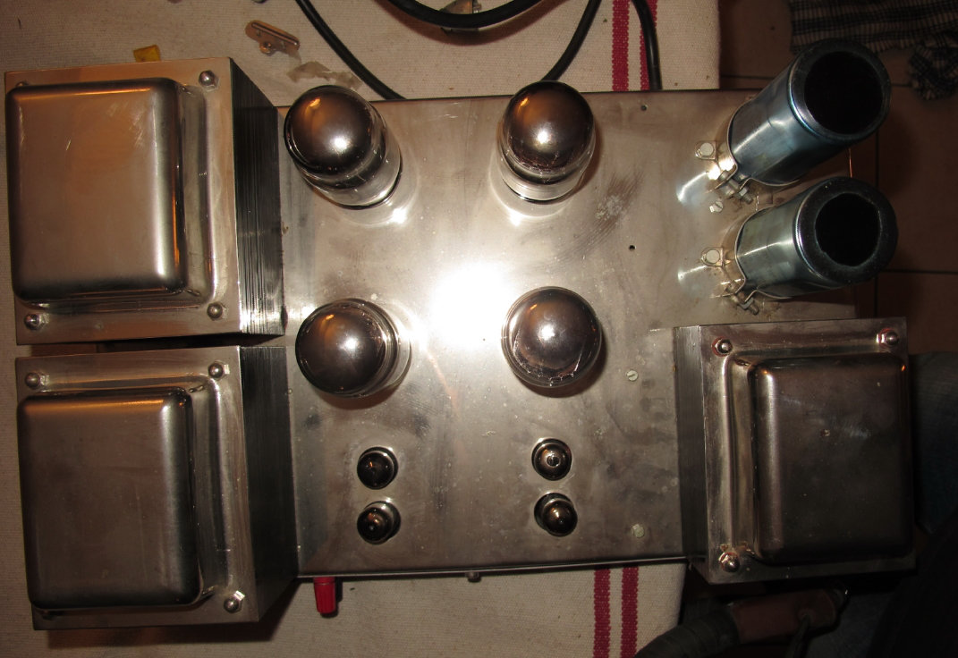

I inherited this week a Michaelson & Austin TVA-1 which hardly needs to be fixed. I plugged it in last evening and all the fuses shut down in a spaceship sound of perdition.
It's a deeply mooving situation for me because my oncle is in a hospital, he wasn't a rich man but its life was based on love of Mozart and Schubert music. I sure will repair the TVA-1 and appreciate it. I will back later with questions. Thx

First of all you need to give some more information. Were speakers connected? Did the amp play before the fuses blew? Did sound come from the speakers or from the amp itself?
How long was the amp turned on before fuses blowing? Etc.

“Were speakers connected?” No! it wasn’t! Now I know that’s not the way to do it
“Did the amp play before the fuses blew?” No it did not.The fuses that blew were the ones in the appartement.
“Did sound come from the speakers or from the amp itself?” From the amp itself. And an orange flame flickered under the structure.
“How long was the amp turned on before fuses blowing?” Half a second. Actually, I wanted to wake the component up slowly with the method “switch on one second, wait ten minutes, one second switch on etc.”
This amp did not work any longer, that why it was in the garage.
What can I do now? I am going to open it. Change all the accessible components that look bad (toasted J ), take the transformers apart and test them, Jeeeze it’s a tricky spiritual mission to have delicate ears.

I hope someone more qualified than me steps in to help soon. But while we are waiting:
Could you take a better photo of the power transformer (from underneath) and also the power switch. Check if the mains fuse in the amplifier is blown.
Also take a picture of the power supply board. To me it seems like there are fewer diodes than usually in a TVA1.

This unit has a big OT transformer to put 75 watts at output. If you turned on the unit without connect speakers, maybe the OT has failed.
To start you need to disconnect everything from OT and power transformer. De-solder every point. Then start measure the resistance between windings. Start from power transformer. If it is not open, then next step will be measuring voltages.
After you get the resistance between windings from power transformer, we can do the same to the OTs.
Don't try to turn the amp on before those measurements.
Post your measures here.

Remove all tubes and replace the blowing fuses. Turn on your amp using a bulb test. Start with a 15-watt bulb. If it lights brightly, the power transformer is shorted.
Passing the dim-bulb test doesn't mean your amplifier works. But if not passing, you will need to desolder some components.
