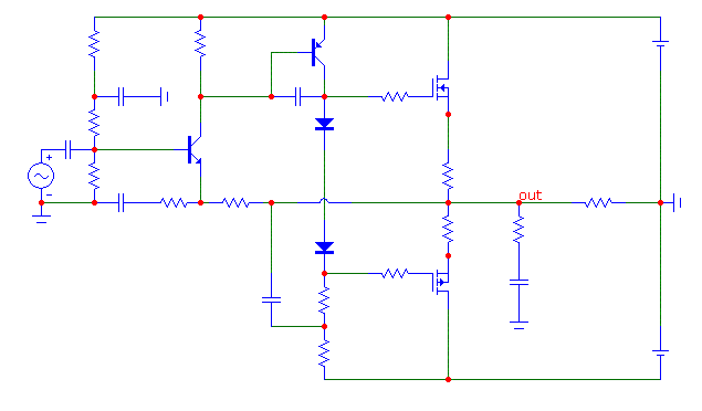

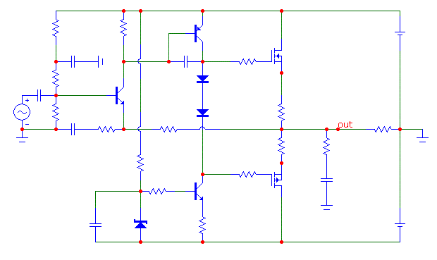

No, I did not but you are welcome to play with it. Here are the component values for those interested. The design is loosely based on the quad 303 simplified. I must admit, neither of the amps sound bad at all, in fact I was very surprised at the performance of such a simple design.
Running it with +-50V supplies it will easily give you the magical 100 watts.
http://digisec.co.za/ras/music/CCS Schematic.pdf
http://digisec.co.za/ras/music/Bootstrap Schematic.pdf

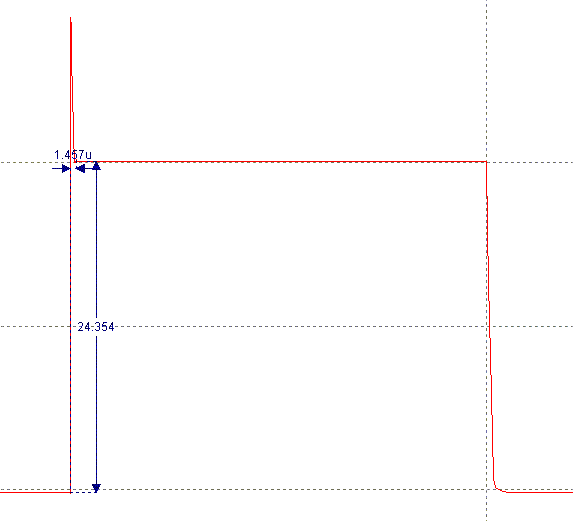

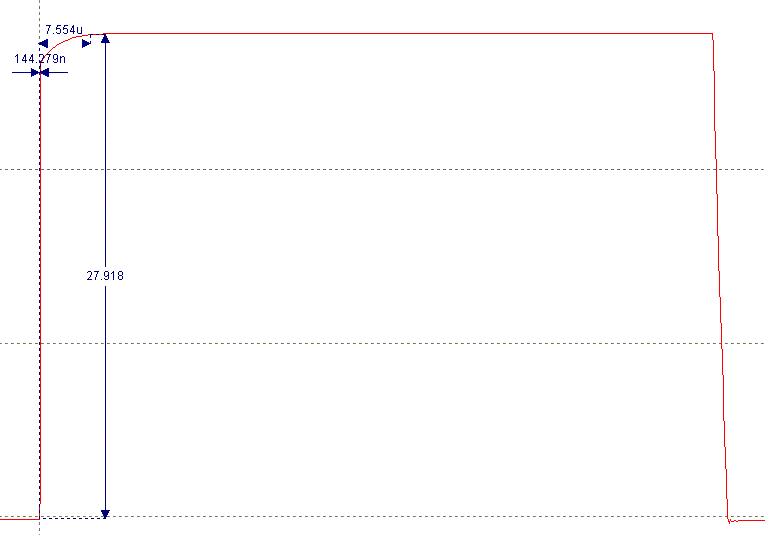

Actually what I said here is not quite correct. Have a look at the square wave response and make up your own mind.

I've always used the bootstrap; in listening tests I found it had much less sibilance, and was easier to compensate the amp because of the rapid increase in electrolytic ESR beyond about 200KHz.
I can see it's slower, but that absence of overshoot is a boon.....

DRC said:Nico,
How much voltage is across R25 and Q4 under these signal conditions ? (no voltage is indicated on D3)
Did you try adjusting C13 on the CCS version ? (the bootstrap version looks spot on)

Hi Dave,
sorry about that, D3 is 5V1. Please note that the base bias arrangement for Q1 should be zener stabilized and it is best making R1 variable then off-set can be adjusted for any supply voltage.
