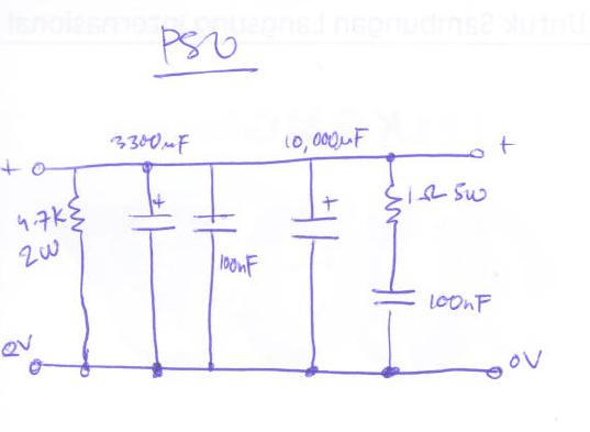

i will post a picture later, currently i am at the office. but to be simple, from the PSU 0volt i connect a wire to the TDA2050 body using a solder pin from the chip nut.
that 0volt from PSU is separated from the input and output ground which taken from capacitor ground that connects to pin 3 of the chip, then input and output ground connected to the capacitor ground.
when input signal not shorted to the ground, the amp is silent. but when not shorted, the hum is almost audible. I think this was from the PSU, not filtered correctly.
my psu design taken from carlosfm PSU design.
I powered the chip with +24volt.

ok, i try to rebuild my TDA2050 not using a pcb, directly soldered the components to the chip, and make pin3 as center of the start ground. Surprisingly, humming is reduce, almost unnoticeable, but if you really stick your ears to the speaker, then you can hear it. I guess this is a PSU problem, I am using a standard transformer instead of the toroid one.
any comments on my PSU from my last reply?
