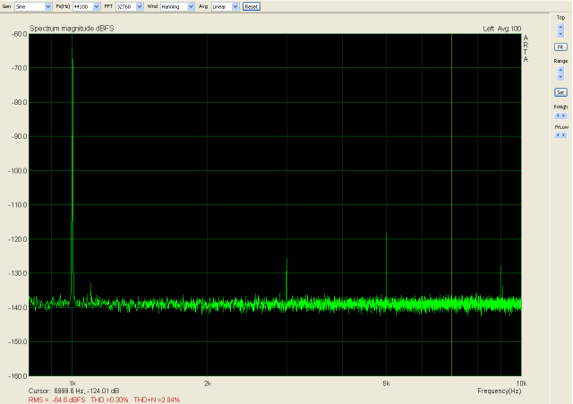

Mmmmm... Interesting. Can you attach a picture of the fft you refer to?
Here are two measurement on the output of the dac while its running a 1Khz sine at -60dbFS The measurement is first taken with the negative output shorted to ground at the output of the dac you can see it below:
Here is the same measurement again only this time its measured differentially.

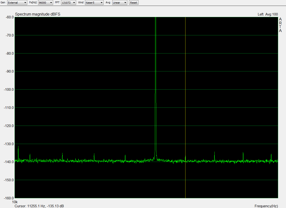

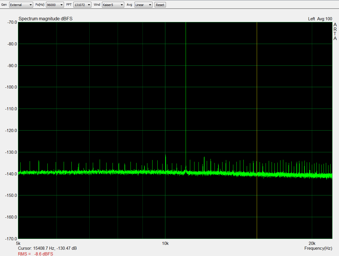

This measurement is taken with the "JTest" signal as generated by the ARTA software at 16bit, 44.1KHz, burned onto a CD and played back with my CD-player (Over spdif). The measurement itself is captured with a juli@ soundcard.

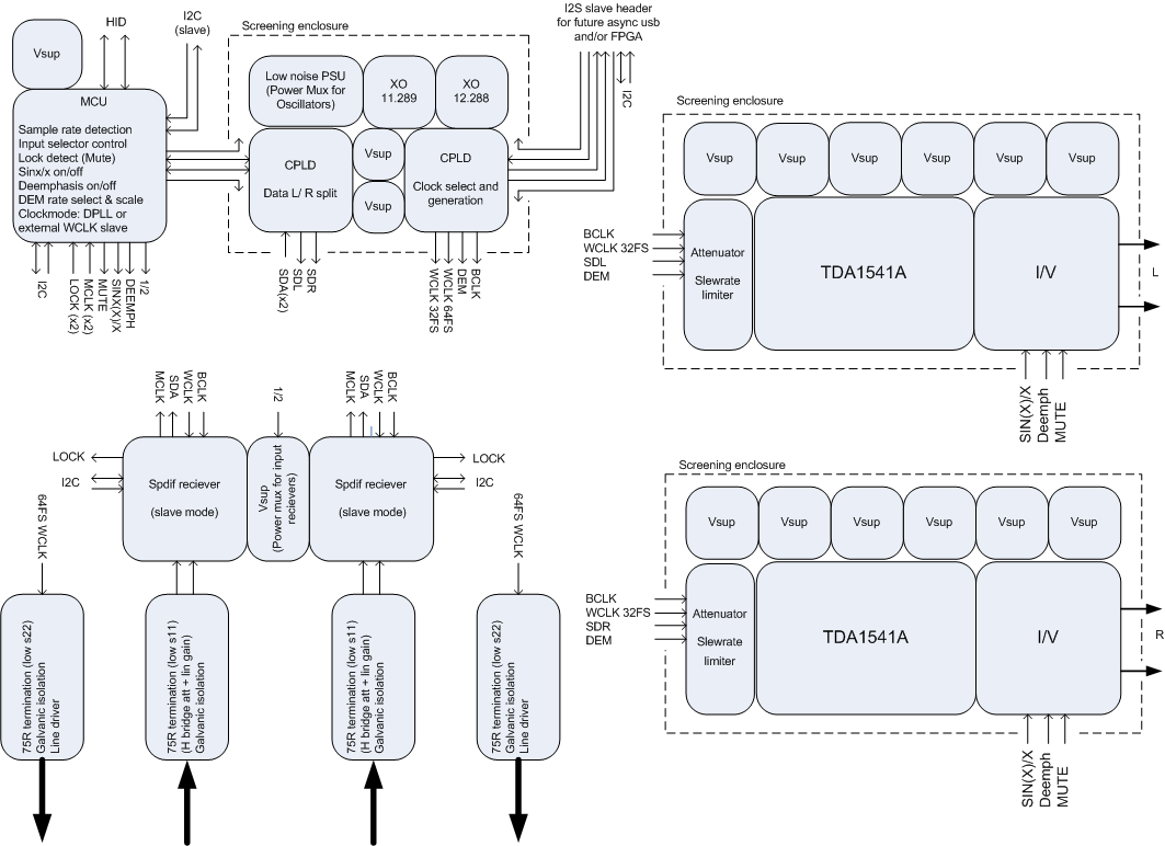

I have started (on a conceptual level) to sketch the features of the next dac I will build. Emphasis is on the digital section as I want to be able to reuse most parts for an Arda AT1401 dac should it become available.
The main features are:
Dual differential (2xTDA1541)
Dual Spdif inputs
44.1-192k input sample rate range.
Two clock modes: Either internal DPLL controlled master clock or wclk slaving (signal source is slave)
I invite you to have a look at the conceptual diagram and give your comments.

Quite complex peripheral circuits I must say... if you are building this for your own use, I would suggest to limit options and make upfront decisions on what you want on:
-DEM rate
-Why would one need i2c?
-2 spdif receivers?
-12Mhz clock?
-192khz/16bits????
-Filtering?
Less is usually more...

The features I mention are pretty much those I miss from the DAC on page one on this thread.
I intend to use that dac as a testbed for some of the new blocks before I integrate everything together on a nice multilayer (>=4) pcb.
