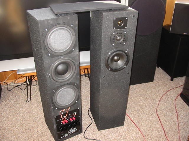

The plate amp I'm using is from a RatShack powered sub I got some years ago. The power spec is 120 watts r.m.s. @ 4-ohms. The Dayton 6 1/2" is the 8-ohm model 'cause that's all they offered back when I got it. You could probably get just as good results with the 4-ohm version of the woofer and an amp of around 70 watts (Parts Express has one). A woofer like this would work great in a condo because it doesn't really make deep "sub" bass that would travel through walls & floors and tic-off your neighbors.
It really is a simple project, but you will need a router with a circle cutting attachment plus a jig or circular saw. It actually took more time to put a finish on it than to cut out the parts.
You can experiment with added weight on the passive radiator if you like, but I got great results right out of the box.

Very nice, Ive been looking into passives for a while but haven't done a project with them. Im assuming its a dayton classic sheilded #295-306 with a 295-492 passive? If so the drivers look alot nicer in your pics then on parts express site...

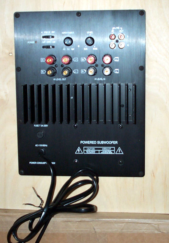

would have liked a pic or brand, feature list...
No brand. Apparently these were OEM overstock. It has a 5db boost at 35Hz, phase switch, auto on/off, 40-160Hz XO, level adjust, high and low level inputs. Pretty good for the price.
The plate is about 8"x10.5". The innerds are not sealed if that makes a difference to you.

plate amp
None of us have tried every flavor of cheap plate amp, but my humble feeling is thay're all about the same "quality".
Of more significance to mr ocool might be the price and availability. Since your signature lists location as SK, you might want to consider the AMP100 from Solen. I've used them on a couple of occasions, and they're OK.
By the time you pay the currency exchange, and brokerage fee if the US vendor "accidentally" sends by UPS or Fedex, you could easily pay more than CDN list from Solen. This has happened to me more than once.
I tried mounting a plate amp without its cheap plastic sealed case, and it was a bad idea! All the connections were leaky, so you got farting noises as air rushed through them all, it being a sealed sub! It sounded like severe distortion. I ended up rebuilding the box without the plate amp in it, as I didn't want the plastic box to mess things up.
