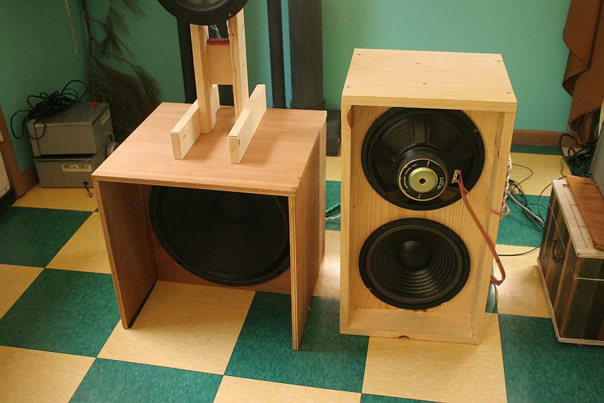

So here are a few pictures of the design - nothing revolutionary, just simple and useful, and I hadn't seen something like this around here yet.

Above, you can see MJK's H-frame next to my recent 'pet'. I don't know if it deserves a name, so lets just call it GWx4 for now - the drivers are four Goldwood GW-210 10" drivers, available from PE for $18 each. The Alpha driver is $60, while the Goldwoods are $72 (per side). So we are talking $12 more (but there's more to that). The drivers are high Qts types, so need little EQ in their lower end.
The footprint of the GWx4 is about 13" by 11", and stands about 23" tall. I more or less fixed how big I wanted the enclosure to be, and then worked with it. A larger enclosure would make the whole thing more sensitive, but one of the primary goals of this design was to not be 'big'. As you can see, the enclosure is somewhere between an H-frame, and an OB with wings. Using one set of drivers behind a front set is something I've only seen in an Emerald Physics design, and of course only works in the bass range. Of course, there is no free lunch - above 400Hz, one sees interference patterns, depending on where the mic is. But 400Hz is high enough.

I don't get the complete picture from your pictures. Are both volumes behind the driver baffles open to the outside? Since you've already got a central cavity, why don't you go full circle - ending with a W-frame? If the pictures tell the full truth, I see a vast mismatch between the impedance on either side of the cone. Wouldn't that be a severe source of NLD?

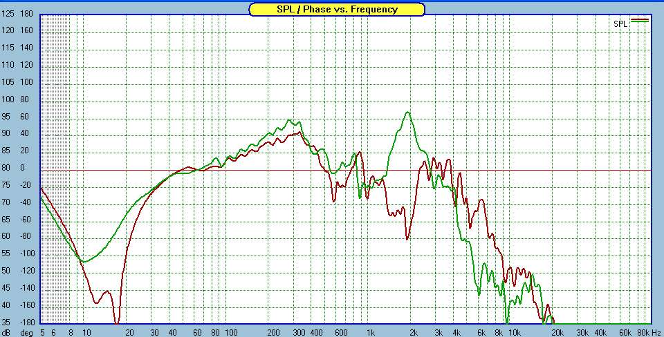

First is an overlay of the FR of each woofer design, measured under the same conditions: 2.83V at the drivers terminals (but remember there are two amps driving the GWx4), mic at a distance of 2m, .84m off the ground (which would approximate the listeners ears), all done outdoors with long MLS signals.
As you can see, between 45 and 100Hz, the are doing just about the same thing. Remember, at a distance of 2m and outdoors, there are some environmental effects on the data - so lets call these close approximations. 1m data had more similar results.
Green is the MJK H frame with the Alpha 15a, Brown is the GWx4. Note the nasty FR above 400Hz... Also, the GWx4 has less of a peak at 200Hz - the GWx4 baffles are less than 4" deep, as opposed to 7.5" for the Alpha 15.

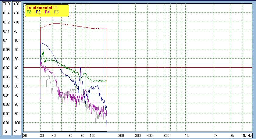

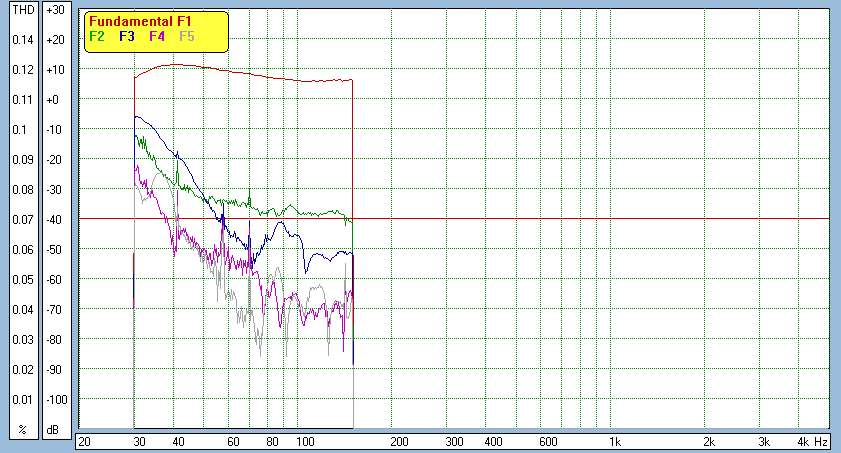

Here is the nonlinear distortion data, done using sweeps. These two graphs were measured the same way, but differently than above. The driving signal was 6dB higher, at 5.66Vrms at the terminals, and measured at the opening of the H-frames indoors. I would have rather measured at a greater distance, outdoors, but there is way too much noise and environmental effects. Indoors, I barely had enough noise free dynamic range.
5.66V represents about 93.5dB at 50Hz and 96.5dB at 100Hz at 1m, so decently loud, but not insane.
The first graph is the Alpha 15a, the second is the GWx4. What you can see, in both of them, is they really loose control of things between 40 and 50Hz. The GWx4 maintains control lower. The other thing I see is that at 50Hz, the GWx4 tall order NLD is 20dB lower than the Alpha. This makes me happy. At -75dB, 4th and 5th order distortion is 'clean' and I'd postulate inaudible, and indicates that the woofers have plenty of headroom till distortion becomes an issue. I need to redo the simulations, but when considering both sets of speakers, I would guess the GWx4 should be able to hit 108dBSPL in the mid bass without problems - which is a lot of output, and comparable to some of the more high end designs. Just not below 50Hz unfiltered. Again, due to masking, instruments natural harmonic content and recording lack of dynamic range, I wouldn't worry about NLD till its around -45dB compared to the fundamental.
Oh - my computer makes these annoying glitches during the sweeps that cause spikes in the graphs below - so ignore the tall sharp spikes.
Yes, the thing is all open. As I was working this design up, I tried using the drivers in the H-frame 'isobarically', ie, connected face to face in the middle of the baffle, and wired out of phase. This didn't work, in fact it worked a bit worse! I'm not sure what an W frame is, but I was considering doing a ripole - but decided not to because of the increased build complexity. I don't know enough to guess what the degree of impedance mismatch is, but the NLD looks decent to me. Let me know what you think. I haven't tried it, but I'd guess sealing the middle of the enclose would be unhelpful, similar to using them isobarically.
