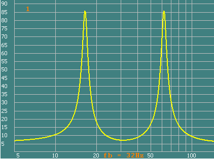

The lower peak is the so-called port peak. For a given box size and tuning, varying port losses will vary the peak height. Same goes for the upper box peak. Leakage losses will lower both peaks and raise the port minimum.
You will notice that varying tuning will vary the relative heights of the peaks and varying box size will vary the distance between them...
Damping the enclosure is the best way to bring down the port impedance peak if this is a problem.

Equal heights are not necessary. The whole equal heights thing is a persistent relic from the 50's and 60's before people knew about thiele and small's papers.
The relative heights of the peaks (ignoring damping) will depend on the tuning ratio Fb/Fs and this depends on the Qts of the woofer for a given alignment. Detuning an alignment to get equal peaks might work in some cases and be really bad in others.

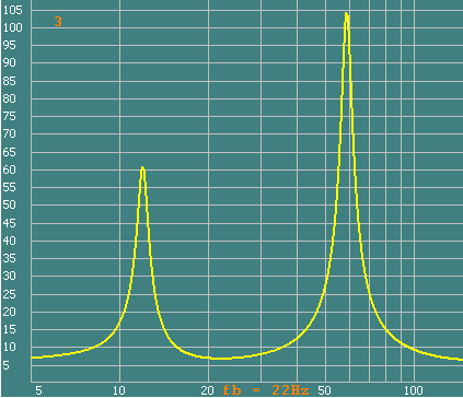

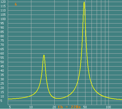

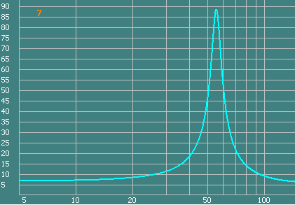

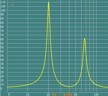

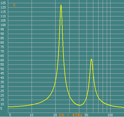

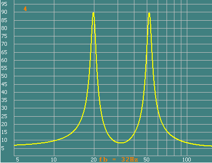

Here's some examples of how things vary.
T/S of driver = fs = 32Hz - Vas = 206L - Qts = 0.33
Images 1-3 Reflex Box = 103L
Images 4-6 Reflex Box = 206L
Image 7 Sealed Box = 103L

I would like to ask why this behavior, i can see from the graph that if we tune the box equal to the fs the peaks are equal, if the box is tuned below Fs the first peak is lower and if we tune the box higher then Fs the first peak is higher. Its my understanding that impedance curve reflects the entire electro-acoustic-mechanical system, for sealed box it is easy to understand. It is getting tricky with the bass reflex for me to understand how this parameter are reflected, I mean where and how does the mass in the port, compliance of the system , anti resonance fit all together. I am sorry but i am trying to understand all this phenomena in the forum because some text book and online information dont do justice to explanation they write it simply ok this bass reflex system and it has two impedance peak one is due to port resonance and the other is due to the driver resonance.
There are two subsystems.
1. the driver - sadly, the only ones we can buy have their resonance in the audible range; I don't know why.
2. the cabinet - based on a 19th century genius named Helmholtz, it whistles just like the old coke bottle when you stimulate it by blowing across the top.
The "classical" approach is to tune them to the same frequency so that the box behaviour contradicts the driver behaviour. When you choose the "classical" tuning, the two peaks are the same.
So what the impedance curve is showing is really how the cone is moving in one system. But that system has a dip in the middle where the two subsystems contradict one another.
In post 7 I pointed out that the sound output does not correspond to the cone motion in a BR box. Post 7 might make more sense to you now.

That sounds like a different model than explanation in post 13? There aren't two peaks in cone motion. Just one with a dip in the middle.The lower peak is the so-called port peak.
But like I said earlier, you don't need a good grasp of acoustics to use a sim - and to use it usefully as a first approximation. Might work for some folks, but not my way of engaging the world of technology.

Lets say i have a restriction in dimension and i need to use a driver with higher resonance frequency because of smaller size, and i tune them below the resonance frequency of the driver. The first peak is significantly damped, but why is this happening , what is going on inside this mass-spring system?The "classical" approach is to tune them to the same frequency so that the box behaviour contradicts the driver behaviour. When you choose the "classical" tuning, the two peaks are the same.
OK, that's where you might find yourself.Lets say i have a restriction in dimension and i need to use a driver with higher resonance...
The cone motion (as reflected by impedance) is easy to understand: you have two competing resonance subsystems. If their tuning is staggered, the system nudges the cone motion around as you'd expect. In your case, the lower peak gets worse. The cone is letting-go more.
And with that non-"classic" system, some parameters of sound output can be more-or-less anticipated; but you need a sim because you are going beyond the realm of human brains and tech-intuition (at least for my brain). For some builders, having a handle on some basic parameters may be all they care about.
What isn't as easily anticipated are the consequences of having more cone motion than the "classic" such as influence on distortion, "group delay" (a euphemism for boom), and the general issue of tuned and non-linear elements within the audible band.
The widely sold Altec A7 (the Voice of the Theatre) had non-classic tuning, 70 years ago.
Any of that helpful?
B.
Why does this matter to you? Ben's explanation is not terribly wrong in a hand-waving sort of way. Funny though, that his explanation in post 16 contradicts both his "model" in post 13 and your experience.
The reason the lower peak is damped in your example is that the motion reducing action of the port on the diaphragm is applied lower in frequency, reducing cone motion below resonance more. When the motion reduction is applied higher, it reduces the upper peak more. The reason the peaks move closer and further with changes in box volume has to do with the "Q" of the port output.
A complicating factor is damping. Damping applied that restricts port flow damps the lower peak significantly. Damping of the box spring affects the upper peak more. This is why the peaks are sometimes referred to as the port and box peaks in the impedance curve.
The impedance curve shape is not a good measure for "tuning" a vented box. Again, why does this matter? To truly explain this well it would take way more time than I wish to spend, with no guarantee that anyone would get anything out of it.
Additionally. IF you make the box too small and tune too low, you may find that your vented box is not much better than a sealed box....
