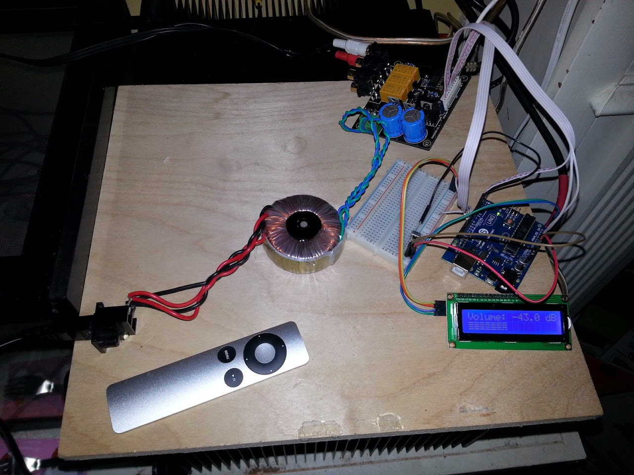

Background:
I purchased an ebay PGA2311 kit to play with. Recently I decided that I want to integrate this into an existing Aikido preamp where I wanted to add remote controlled volume and input switching.
Enter the Arudino Uno
I want to turn this kit:
Into this:
I have been following numerous threads about this and will keep my progress updated here.
I am an Arduino novice - maybe not even a novice so I appreciate any help with coding that may come up.
Pasted below is a response from ElectoNick Thanks!!! It think this is a good starting point to begin the Arduino sketch.

OK...ran a IR receive decoder on the Uno with the apple remote for fun.
Unfortunately based upon what I have read I am not seeing the same code or code format that others have reported.
UP 77E15004
DOWN 77E13004
LEFT 77E19004
RIGHT 77E16004
CENTER 77E13A04 77E1A004
MENU 77E1C004
PLAY/PAUSE 77E1FA04 77E1A004
I dont think I have seen these codes called out in any "code" that I have seen related to the apple remote.
Sorry for the noob questions...
Another update:
I have inserted the PGA2311 into doing full preamp duties for test.
Apple remote works for volume up and down and I tried a version that switches the inputs but no go.
Any advice or suggestions on how to code the arduino to switch relays would be appreciated.

Bench setup...

OK I tried this bit of code out with the addition of my apple remote up, right, and down code and I was successfully able to switch between relays, but what I want to do is scroll through the inputs only using the left and right buttons on the remote.
Getting closer, any advice or suggestions on tweaking this bit of code is appreciated.
Code:
UP	 77E15004 	2011254788
DOWN	 77E13004	2011246596
LEFT 	77E19004	2011271172
RIGHT 	77E16004	2011258884
CENTER	 77E13A04 77E1A004	2011249156
MENU 	77E1C004	2011283460
PLAY/PAUSE	 77E1FA04 77E1A004	2011298308
OK making a little more progress...
Working:
  • So far I changed the welcome message
  • I got rid of the volume bar thing that didnt display right
  • On the remote the left button toggles the input 1 on/off
  • The right button toggles input 2 on/off
  • The top button is volume up
  • Bottom button is volume down
Still need to fix:
  • On the display I tried to get it to display which input is active to the right of the startup message. The input shows and stays on until you adjust the volume and it goes away.
  • The ability to scroll through the inputs just by pressing left or right buttons
  • Add a mute function by pressing play/pause - just need to assign function to button and pin on arduino board
  • Need to add encoder
Here is the latest functioning code:

It occurred to me that I'd rather use my smart phone for a remote for my stereo than a separate dedicated remote. Now days virtually everyone has a smartphone by their side. Just need to find someone who can write the application, and create the receiving end interface. I'd want input selection, volume, mute, a few tone options, maybe an external processor in/out option and that's about it. Any thoughts?
