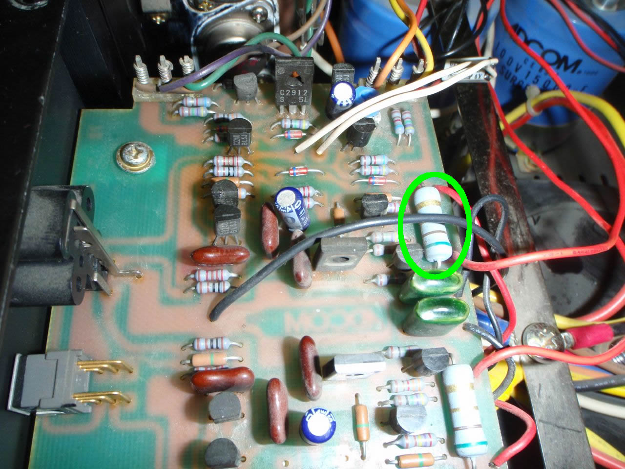

Well, fire it up was not a good choice of words. I replaced Q7 and Q4, as well as Q8 (with the "under-gained" 970) and R7 and R8. Plugged it in and turned it on and almost immediately R22 (the big 2 watt resistor) got hot enough to release the damn magic smoke.
Very discouraged.
I've double checked every replaced component for correct orientation, and I've checked every solder joint under the magnifying glass. Nothing seems amiss. I just don't know what I could have done wrong.

Do you have an O'scope? R22 looks to be part of the Zobel network. The only way to get it hot is for the amp to oscillate at a pretty high frequency _or_ for C6 to be shorted _and_ high DC ouput to be present.

Doesn't look like anything to do with the Zoebel to me. I see R22 as feeding base current through an offset adjustment pot to Q8 (one of the 2SA970's).

We're literally on different pages here. The schematic I have is out of a booklet from Adcom. The parts list says 'Input/Driver P.C. Board (A020 A)'. R22 is listed as 5.1 ohm 2 Watt metal oxide film. On my print C6 is 0.1uF film cap. C6 and R22 are in series with C6 to the output and R22 to ground.

The resistor is definitely 5.1 ohm 5%, according to the color code on the part itself. In my service manual, R22 is listed as 5.1 ohm, 2w. I've circled it in the attached pic.

Well, like I said, there are 2 R22's, one on the analog board (which I guess is the "input board") and one in the PS regulation section. To make things more confusing, both boards have 2SA970's in locations labelled Q8.
The photo, and the value, definitely clears things up, though.
Everything I said previously was regarding the "other" R22, so we can ignore all that.
As stratus said, then, this R22 is part of the zoebel circuit. To smoke, either the amp is oscillating heavily at pretty high frequencies. (Rail to rail oscillations at 30KHz would be around the minimum to get 2W into that resistor.) Or C6 is short.
Have you checked C6?

1. Not neccessarily. I'd check first in circuit to see if it looks like it might be low resistance or short. If I only read a few Ohms or less across it, I'd then pull it to see how it reads out of circuit.
