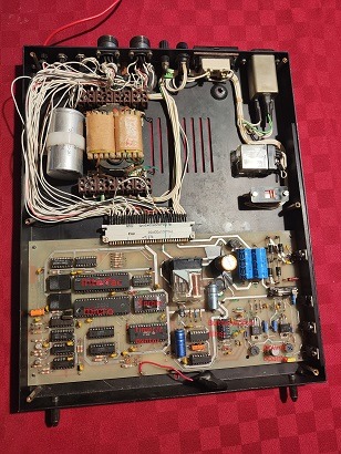

Hi Ganther, many thanks. Here, I hope, you can see the board of the motor controller:
It seems I have downsized too many, sorry....
All you can see at the right of the big relay down it's the power section. I have replaced all the electrolitic caps and all the ceramic caps all over the board (apparently some of them was bad)
Same for the linear power supply for the logic (7805), the power opamp (dual supply), the TIP111 and 112 power transistor you can see at the right down corner
I can't read the eprom I haven't the right reader and a new one it's really too expensive for a one shoot use

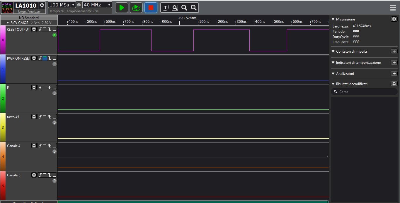

Many thanks Nelson I'm still working on it. It seems that the clock generator (MC6875) for the MC6800 doesn't go out of the Power-On-Reset (pin 12 of the IC).
It never goes low as it would be when Vcc goes above 3 Volts. I would need someone who knows well the MC6800 architecture :unsure:

According to DS Reset out is active low. For CPU normal operation it should be high (>2,4V).
Reset out is provided by a schmitt trigger buffer wich input is pin12. You should have on pin 12 and 14 the same logic level. For exact treshold values check DS.

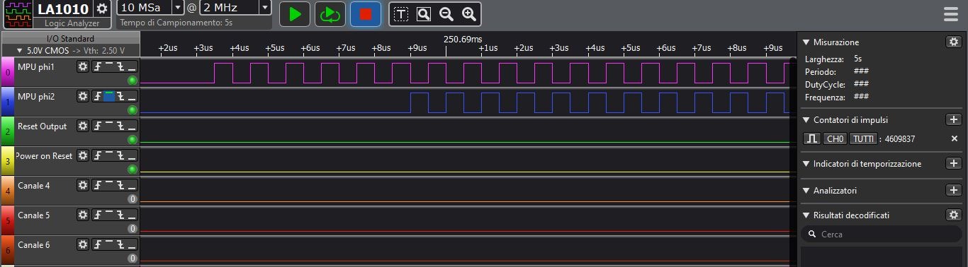

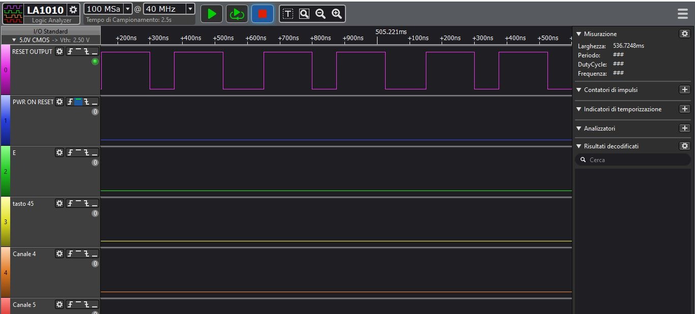

I haven't the schematics and I'm searching for it, but I checked the signals coming out from the MC6875:
phi1 and phi2 are the same I can find on the MC6800P. The MCU is also generating the E (enable) signal for the EF6821 that's the peripheral interface adapter for the MC6800P. It seems that Reset Ouput and Power On Reset aren't used and connected to ground

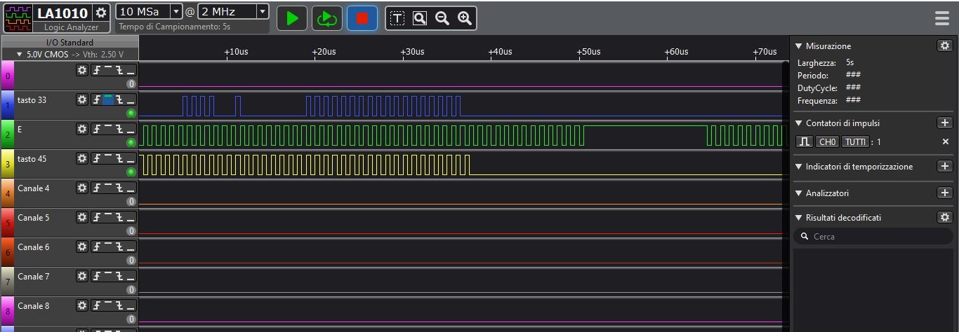

Here I checked the inputs to the EF6821: the E (enable) is clocking right, when I press the 33 button after some bouncing the signal (tasto 33) goes low but I don't understand why it doesn't return high. There's only a kind of pull up resistor between the contact of the button 33 and the input of the EF6821.
When you don't press the button the input is set to high when you push goes low but after that it would be high. Moreover I'm seeing a very dirty signal on the input tasto 45 and it goes low but I never press the button 45

MC6875 is the clock generator for the MC6800. Clock is two non overlappin phases : Ph1 by Ph2.
E : Is Enable pin of the PIA (6821) this has to be Ph2 which is the main clock used by the 68xx and 65xx peripherals.
Whats matters is reset pin of the CPU. Could you check cpu pin40 with analyser. If low there's something wrong with reset and fact that Power On Reset (p12) on 6875 is low it not a good sign.

Just saw you last post and the strange E waveform between 50 and 50us. E (Ph2) should never stop except if cpu is suspended to allow access for slow devices, wihich is usually managed by 6875...
Could you ensure that CPU is correctly running (Reset high, activity on adress bus, on data bus, etc...) ?

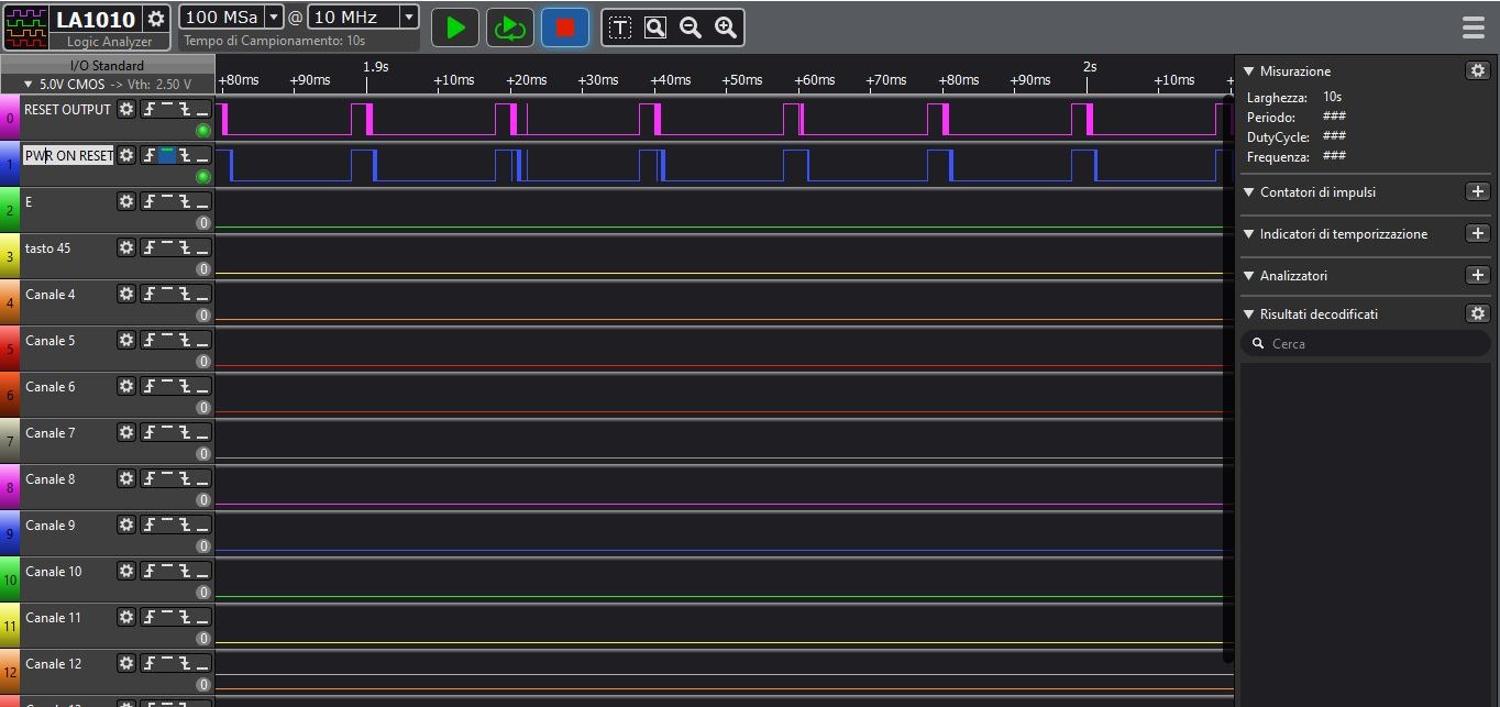

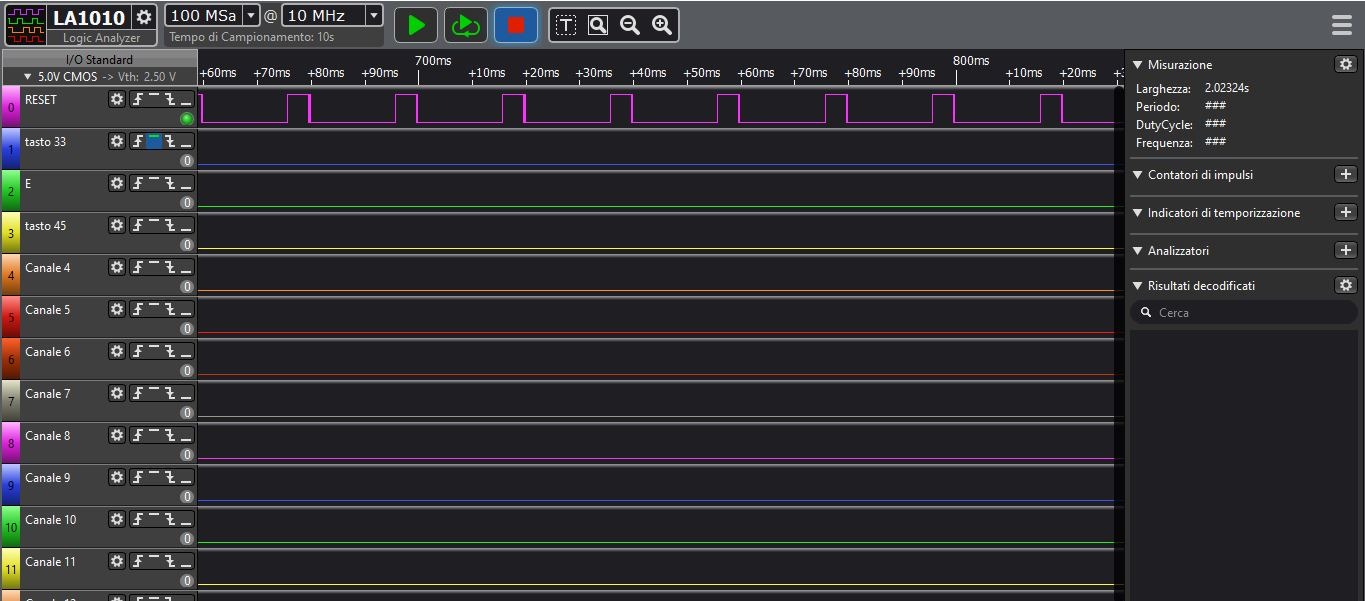

Hi. OK so, Reset is not always low as stated before. Regular reset is not always a fault, this could be a feature generated by a watchdog, but if so signal is likely to be inverted (short reset time and long running time).
Check the 5V supply. We have a periodic pattern with 20ms repetition rate : 50Hz ! this could be main power related.
Do you have a scope? in order to check reset input pin of 6875 in an analog way (analyser is digital)
Circuit diagram are now required!, could you draw the circuit connected to reset input of 6875 ?. For such a simple board we expect a RC to ground, but with such a waveform this may be more complex! ie : a main frequency sync mechanism.
