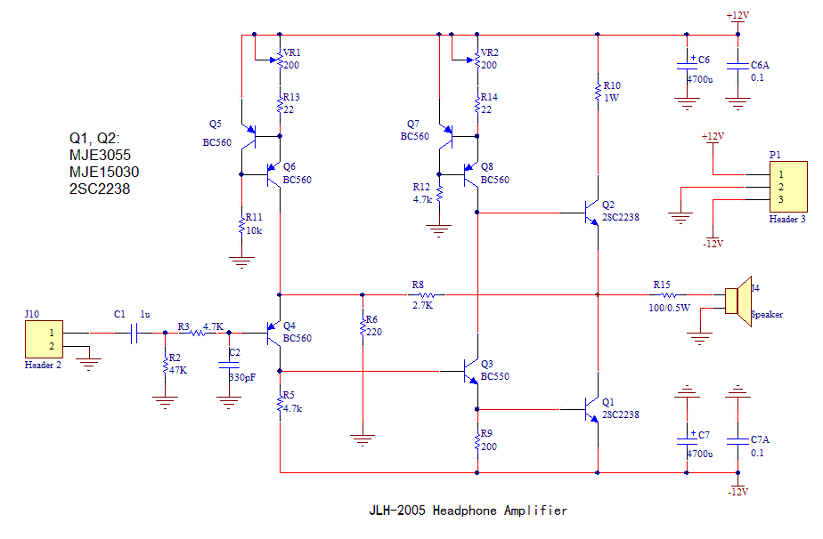

Just finished another JLH amplifier project. The design is still JLH2005 but components are modified for headphone amplification. Circuit is attached below. Please help me to check the design. Any advices please feel free to let me know.
I can offer free PCB for this amplifier when the design is done. If you are still interested in getting one please feel free to let me know.
