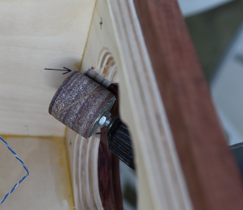

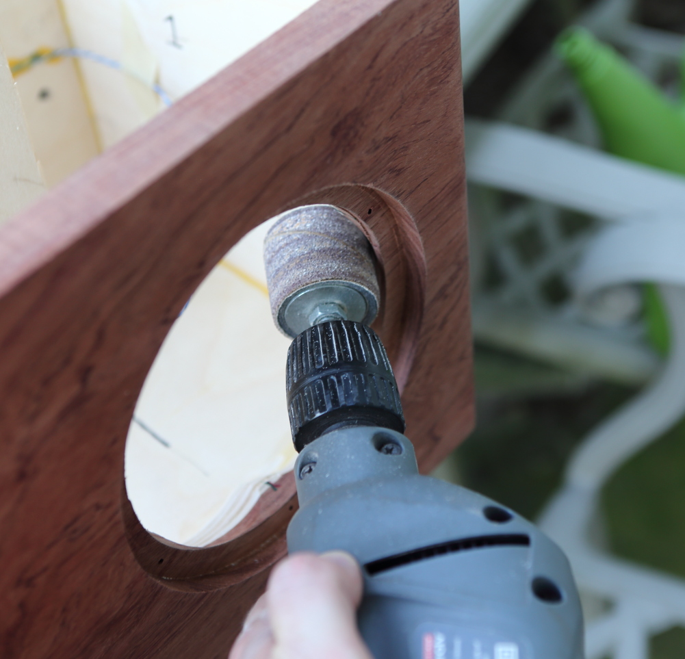

Before I forget, I wanted to share a few more details about creating the driver chamfering on the rear side of the baffle. A sanding drum in an electric drill works wonders, even if you've already sealed up the cabinet! Just stick it in through the driver hole, watch for the mounting screws, and let the sawdust fly! I've attached a few images.

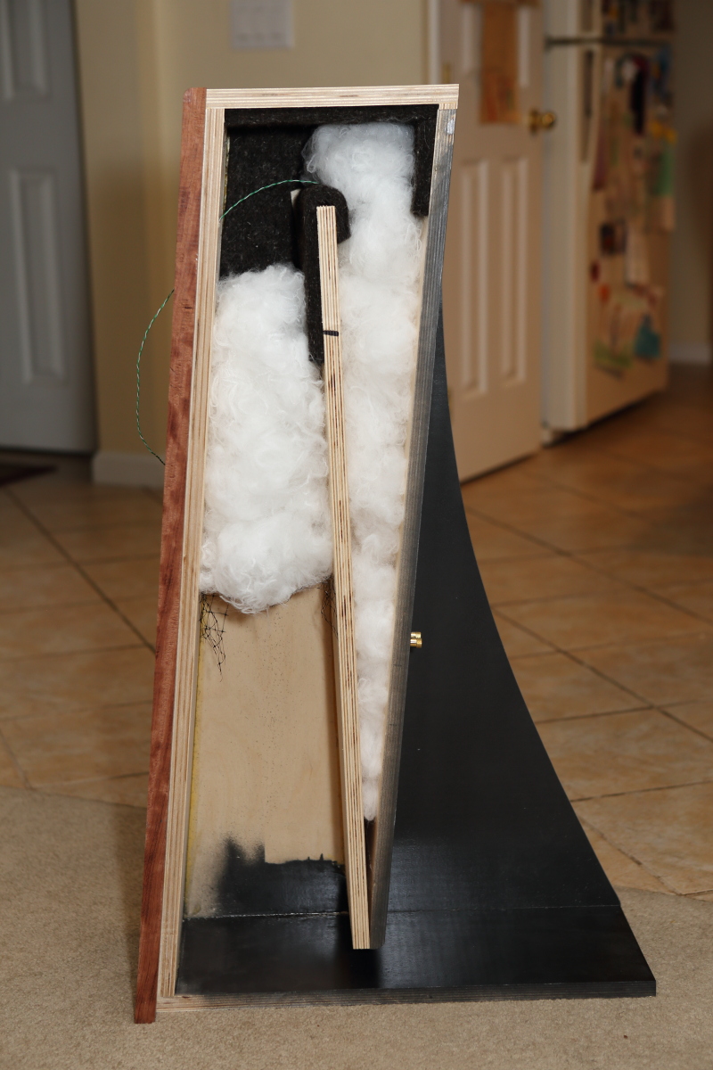

So now I'm at the point where I think I'm "ready to close." I wired up the speaker terminals with some 24g cat5 wire that I glued to the rear panel of the speaker to keep it from rattling inside. Felt and stuffing have been added - man it takes forever to properly tease the acoustastuff apart and make it fluffy! If there are no criticisms or suggestions to what I've done, I'll finish gluing up the cabinets tomorrow and then get ready to apply the veneer. Almost ready for an audition with the drivers mounted...

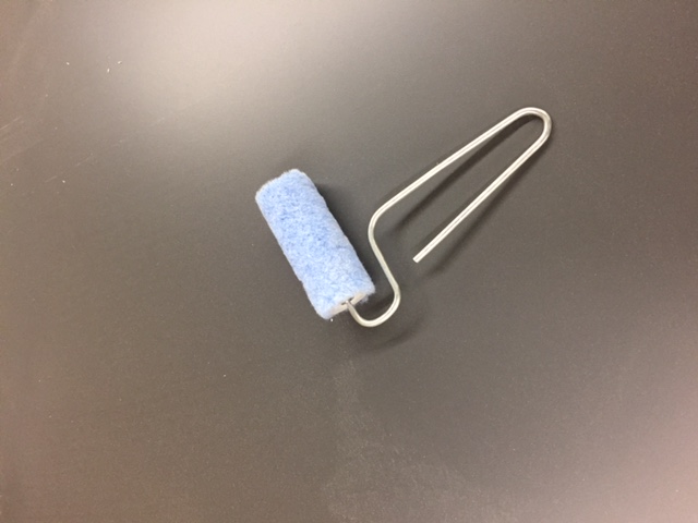

The rollers I use are a cheapie short nap 3" paint / trim roller. The first time you use for glue, you'll get a bit of lint pull out, so that's the best time to practice, but once you've done that, it's pretty easy to get a uniform light coat per surface with a very light eggshell texture. Seal up when done in a zip-lock bag, and they can last for weeks without needing to wash and dry after each use.
I find them much easier to control than foam rollers.
