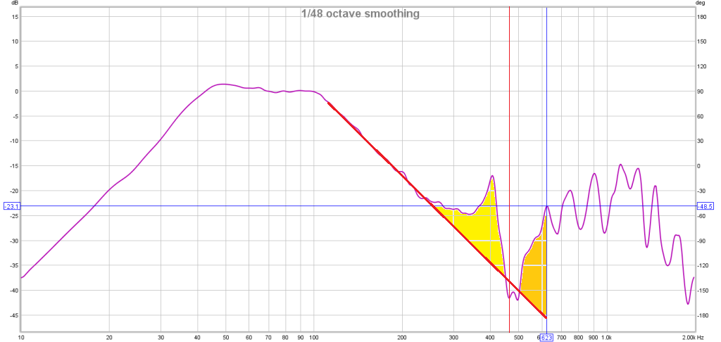

I've run into another "enigma" with this build. The raw response of the original build shows a significant peak just under 400 Hz, a peak that decreased significantly in magnitude when I cut the vents down a bit to "fix" the passband.
I thought that peak had something to do with the pipe resonance of the vents and their interaction with the enclosure, as it increased slightly as I cut down the vents. In fact, I was thinking of using this effect to determine best size and location for a vent in an enclosure, by trying to figure it out mathematically.
However, apparently that peak in the out of band response has nothing to do with the pipe resonances of the vents.
The pipe resonance frequencies for a pipe that's open at both ends is given by the equation: F(n) = =n*c/(2*(L+0.8*D)), where n-1,2,3.., c=speed of sound (m/s), L = length of the pipe (m), and D = diameter of the pipe (m). The "Enigma" sub has two 3" vents that are effectively 21.5 cm long. Using c=344m/s, F(1) works out to 623 Hz, much higher than that ~400 Hz peak, suggesting that it has nothing to do with pipe resonance effects.
So, where is that 400 Hz resonance peak coming from?
My next guess is that it's primarily some sort of resonance mode caused by the dimensions of the rectangular box that makes up the vented section of the subwoofer, which I think is closer to the truth. However, with internal dimensions of 38.1 x 31.8 x 21 cm, the lowest resonance modes work out to be 451 Hz, 542 Hz and 821 Hz. In the attached image, I've added a vertical red line indicating the enclosure's lowest resonance mode, which is still noticeably off from that 400 Hz peak.
What could it be? Any ideas?

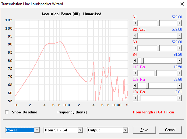

I redid the Hornresp model for my 4th order BP build, this time modeling it as an offset driver horn, with the vented section being the "horn". Basically I used S1-S2,S2-S3 and L12 and L23 to describe the net volume vented section and the location of the driver within it, S3-S4 and L34=0.01 to simulate the step down to the vent's diameter, and then S4-S5 and L45 to simulate the vent. It's not perfect (perfect alignment with the sim would require that the vent be mounted outside of the box, not inside of it), but the 400 Hz peak, and subsequent dip shows up in the sim.
This opens up some interesting things:
1. The out of band noise exiting a 4th order BP's vent can be modeled in some circumstances.
2. It may be possible to reduce this out of band noise by choosing appropriate cabinet dimensions and the location of the driver within the cabinet. The effect can also be modeled before building the enclosure.

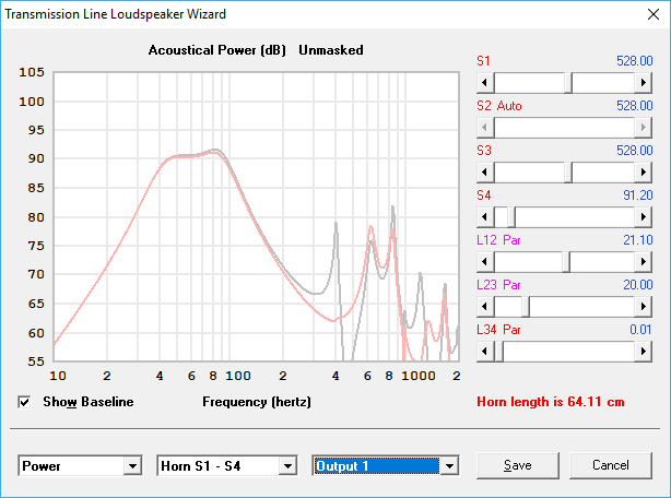

...and here's how that 400 Hz peak can be addressed by just moving the driver a few cm in the enclosure, according to the Hornresp sim. I've also sim'd the addition of some stuffing to the vented section. Now, the only out of band stuff appears above 600 Hz, where it's a bit more easier to deal with, and also measures quite a bit lower than the sim suggests. Wins all around.

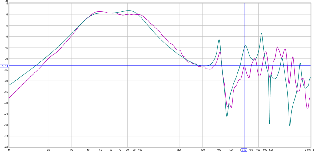

I actually have another 4th order BP on hand at the moment, a smaller one that built before the "Enigma" that has a similar "offset drive" arrangement. When I get the chance, I'm going to perform some more measurements on that one as well to see if the shape of the out of band noise from that build matches an offset driver sim of that build. However, the shape of the response curve does suggest that there is some nulling going on that's not predicted by the current Hornresp BP4 sim (see attached - the null is appearing just above 600 Hz - the peak just above that is damped by the damping material that I have in the vented section of the system).

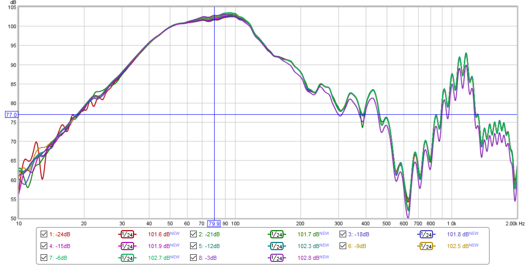

Another thing I noticed with these builds is that the shape of the response curve can change a bit at different power levels, some times in strange ways. For example, for this smaller enclosure, it looks like the system gets MORE efficient (by about 1.2 dB @ 80 Hz) as power is increased.
