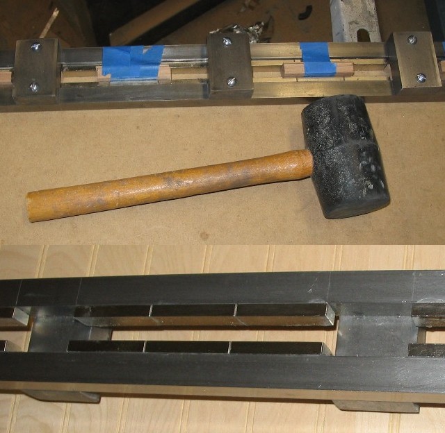

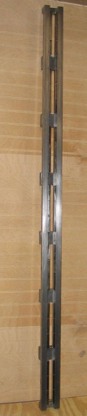

I've made a little more progress today. I got all the cross pieces installed and squared up. Now al l I have to do to finish is build a set of ribbon connectors and cut, pleat and install the ribbons.
I've included a couple more pictures. The top shows the frame still clamped up with cross pieces installed along with my "adjuster". As I mentioned in a previous post, Once the cross pieces are placed on the poles they the magnet field makes it literally impossible for me to budge with my bare hands. This is where my rubber mallet comes in; A few whacks will usually get the cross pieces lined up with the threaded holes on the poke pieces.
The second picture is just a detail of the front of the assembly, before I install the fiberglass connector blocks. These blocks will just sit on the cross pieces attached with super glue.

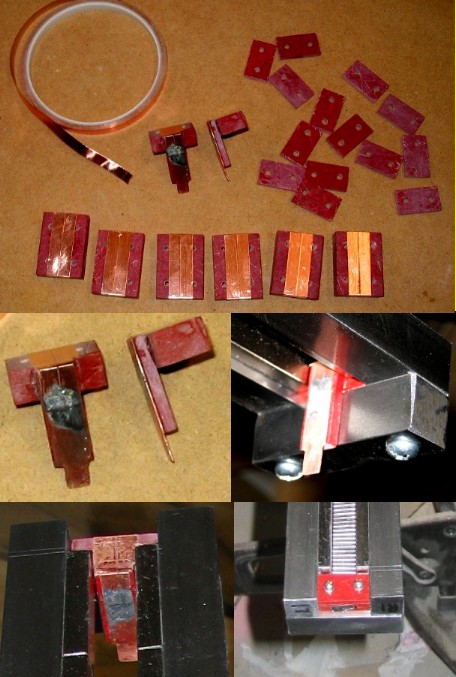

I've completed the second full size ribbon. I'm attaching a set of pictures that show the parts that make up the ribbon connectors.
The top picture shows all the connector pieces. The pieces are made of Fiberglass. I use two thicknesses: 3/8" thick and 1/8" thick. The 3/8" pieces sit on the cross pieces and have holes tapped to accept 4-40 screws. This time I used stainless steel screws and lock washers as well as a non magnetic screw driver. This makes assembly MUCH easier.
You can see the role of copper tape that I use to provide electrical connection between the seven individual ribbon segments. The tape is a quarter in wide and I put two strips side by side to correspond to the half inch ribbon width. The tape is used in making stained glass objects like lamp shades. They wrap the copper tape around the edges of each glass piece than solder them all together.
The bottom four pictures show details of the end connectors. These two connectors have an additional piece of fiberglass as well as a this copper strip that I use as the male part of a push on electrical connector.

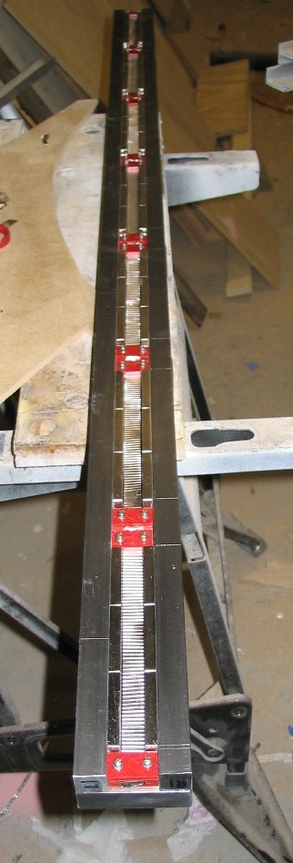

Here is one last picture. This one is the completed ribbon. All I have left to do now is wind another transformer and attach two lengths of "T" shaped aluminum that will serve as the mounting brackets. I should be able to easily complete it tomorrow.

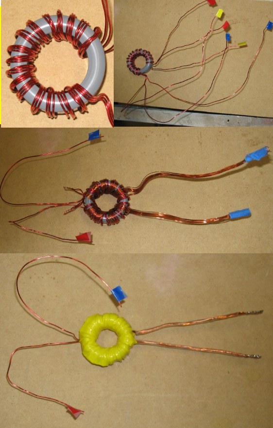

I finished the mounting brackets and the second transformer. I mounted the new speaker on the old test stand and listened to it. It sounds good – about the same as the first speaker. I've made no measurements yet of the new speaker and mounting method.
I've included some pictures showing the steps in building the transformer. It's the same design as the first:
Primary = 18 awg, 17 turns, 3 wire series multifilar winding (equivalent to 51 single wire turns)
Secondary = 24awg, 9 turns, 12 wire parallel mulitifilar.
The top left picture shows the primary with the three wires per turn.
The top right picture shows how the three wires are connected to get them series connected. Note that it's a good idea to mark each end of the three wires to make it easier to figure out what to connect.
The third picture shows the secondary wound on top of the primary. No need to keep track of individual secondary wires since they are all wired in parallel.
The last picture shows the completed transformer wrapped in electrical tape to keep the windings tight to the core.
