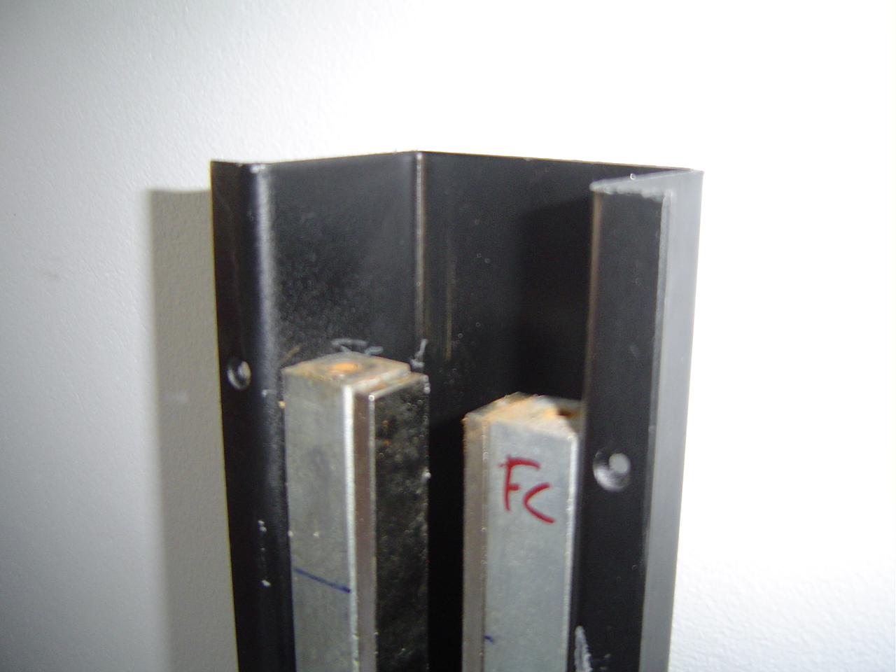

The toroid I'm using is 2.4" OD and .5" high. Based on the calculations and measurements I did for the original ribbons, it should easily handle the frequency range and 30+ watts , which should be plenty. BTW, the toroid I'm using is a type 77 all ferrite (no gap).
I think .25" X 2" might be too small as it is less than half the cross sectrional area of the .75" X 1.5" I'm planning to use.

I've done a Femm simulation to optimize the field strength in the gap. I'm getting nearly 1 Tesla which is almost twice the original prototype. This should get me an efficiency in the ball park of what I'm looking for (90+ dBm).

I just received the .5" X .5" X 2" N45 magnets ............... man, are these things STRONG!
I'm having trouble pulling them apart.

tinitus - Good advice on the magnets. The site lists them as having nearly 55 lbs of pulling force. I'm able to get them apart by sliding them apart and twisting the magnet so it is at a 90 degree angle to it's neighbor. Then I can pull them apart.

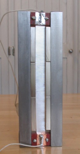

FYI, the ribbon is basically the same as my original prototype (attached) except the magnets are twice the thickness and the frame is also bigger stock.

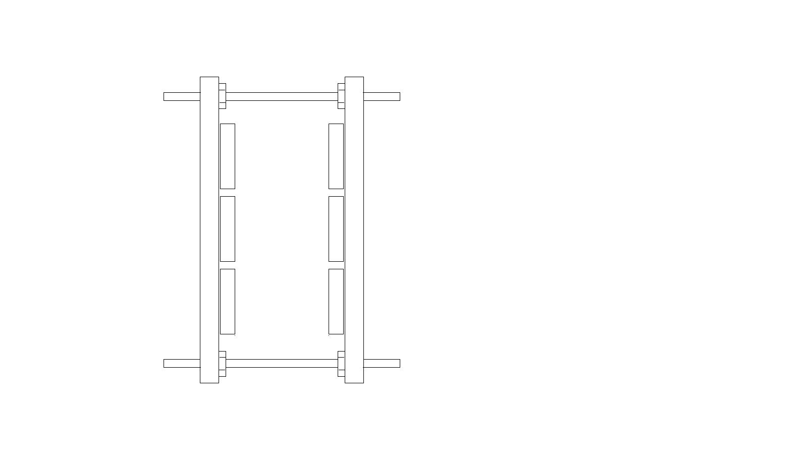

I dont know if this drawing makes sense
threaded bolt rods are holding the steel bars
when magnets are in place, the steel bars can be brought closer together by turning the nuts
when placing magnets I would wrap opposite bar with thick cloth, just in case

tinitus - Interesting approach. When I made my original ribbons, I assembled the vertical frame rails separately. I then put them together separated by 1/2" Styrofoam sheet and applied the cross bars. I then removed the Styrofoam. I'm a little worried that the stronger magnets will make it difficult to remove the Styrofoam with this design so I may have to try the threaded rod approach.

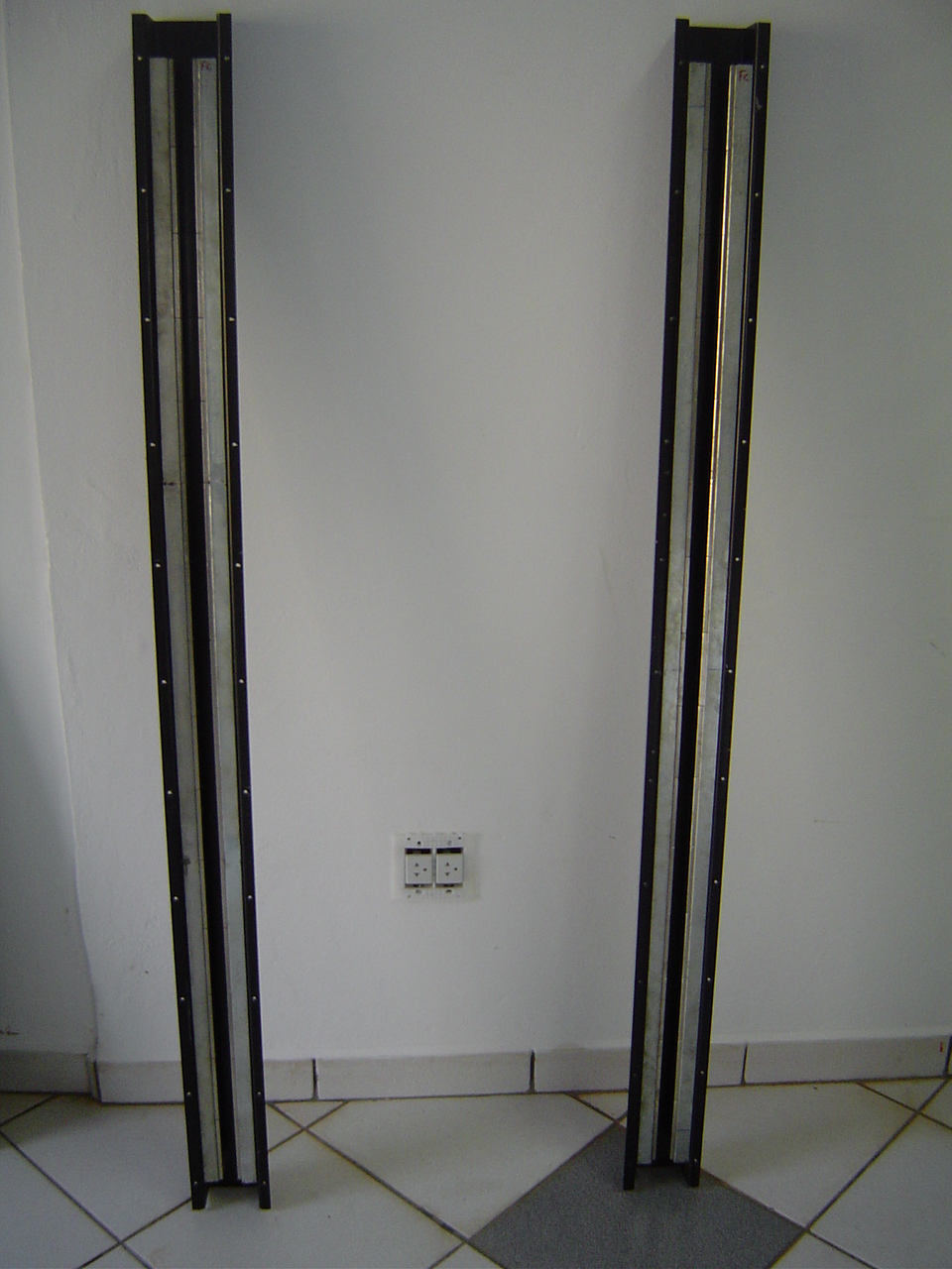

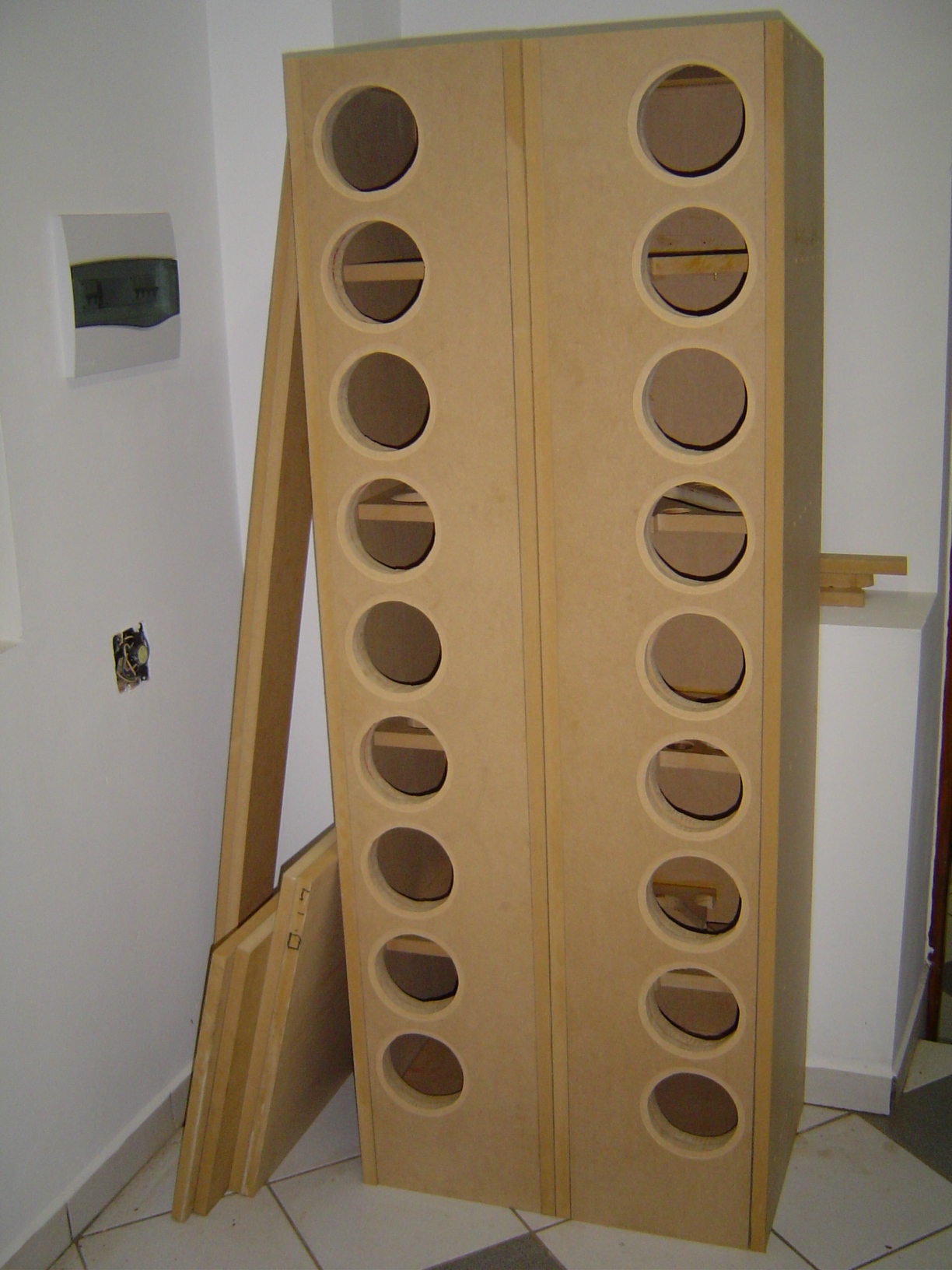

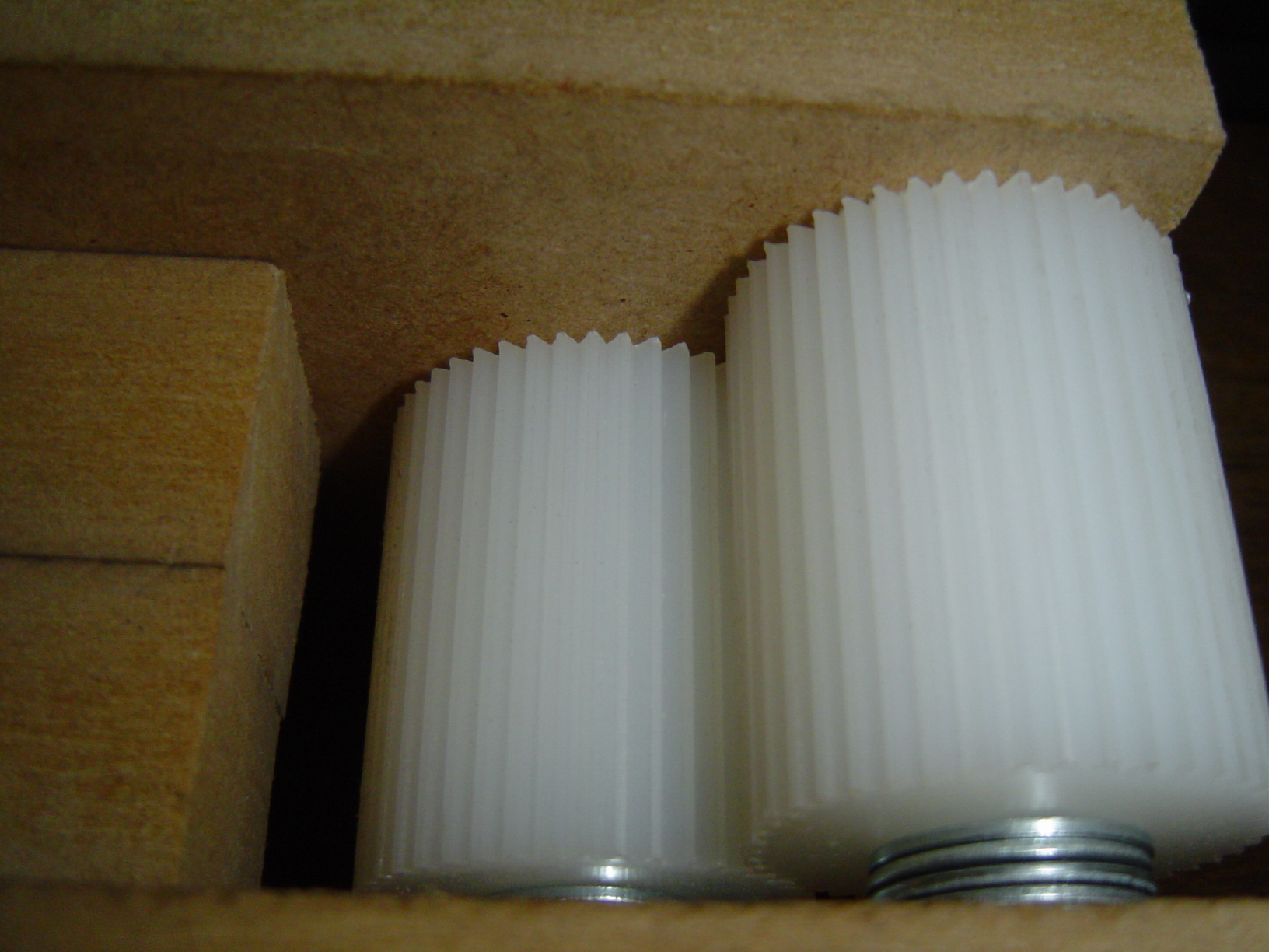

Hi folks,
I'm just here to show my work in a little ribbon tweeter that will be installed in my line array asap
I hope you enjoy it.

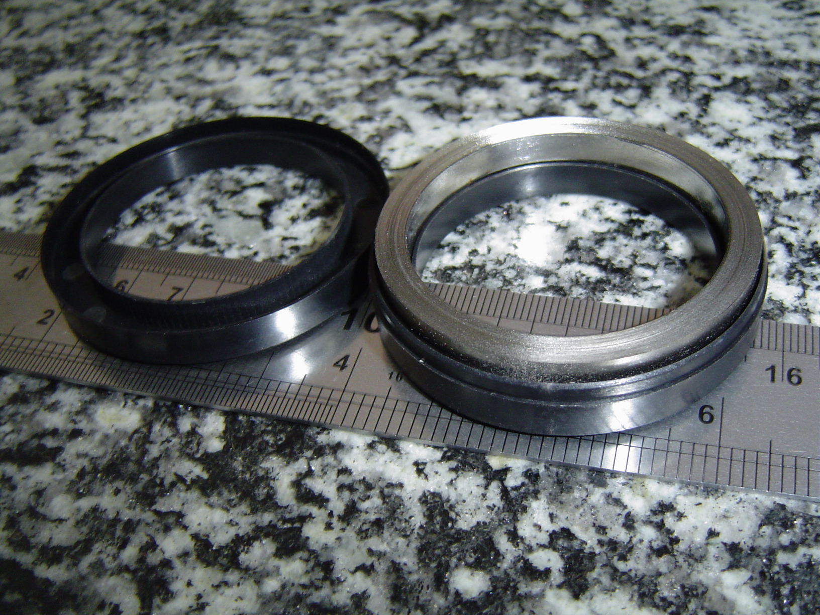

Nanocrystalline core that im using in the ribbon:

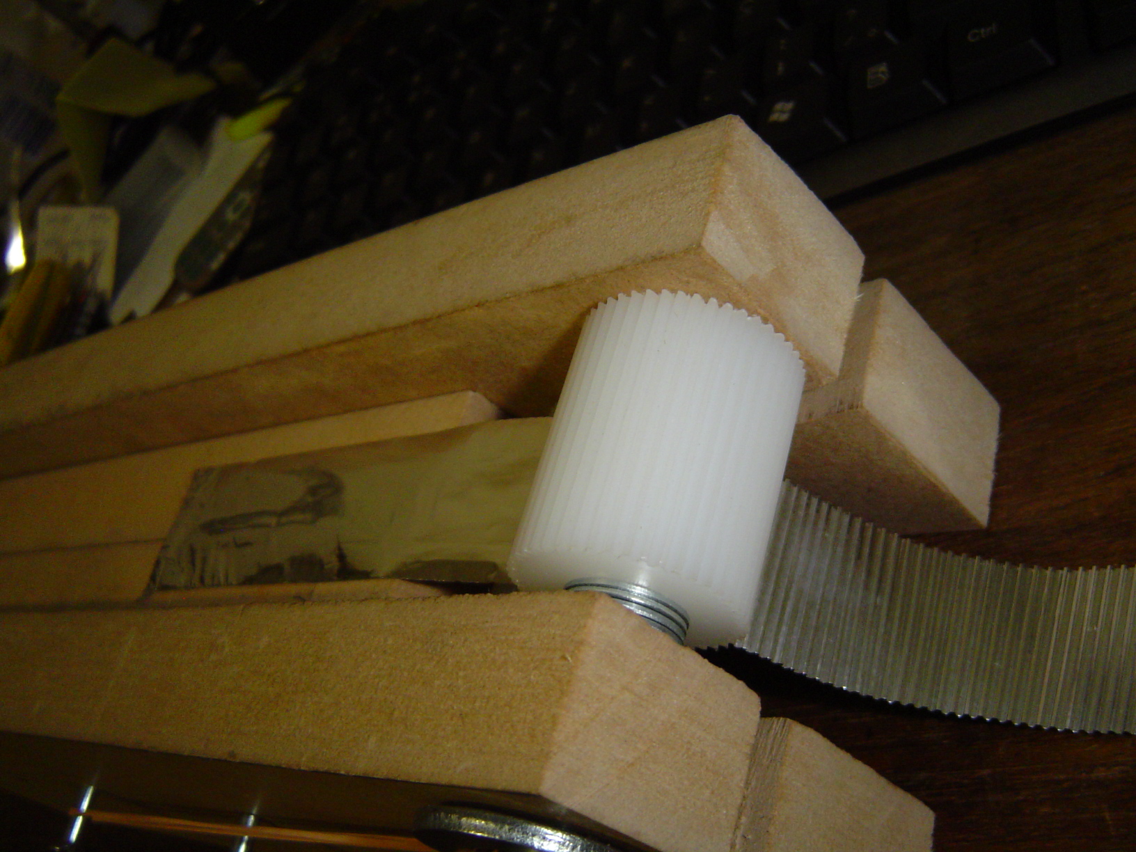

Corrugation machine:

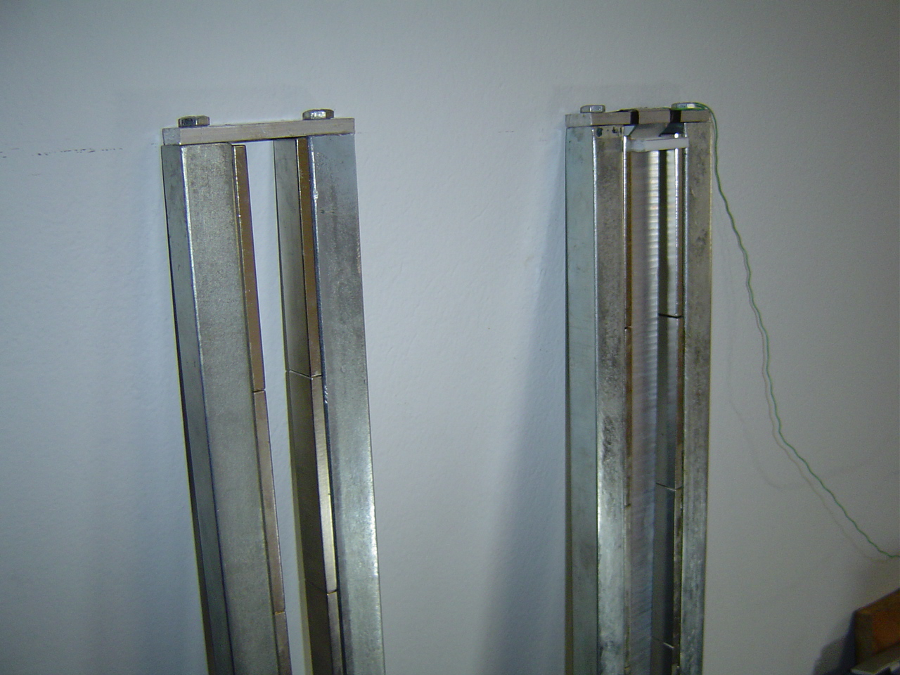

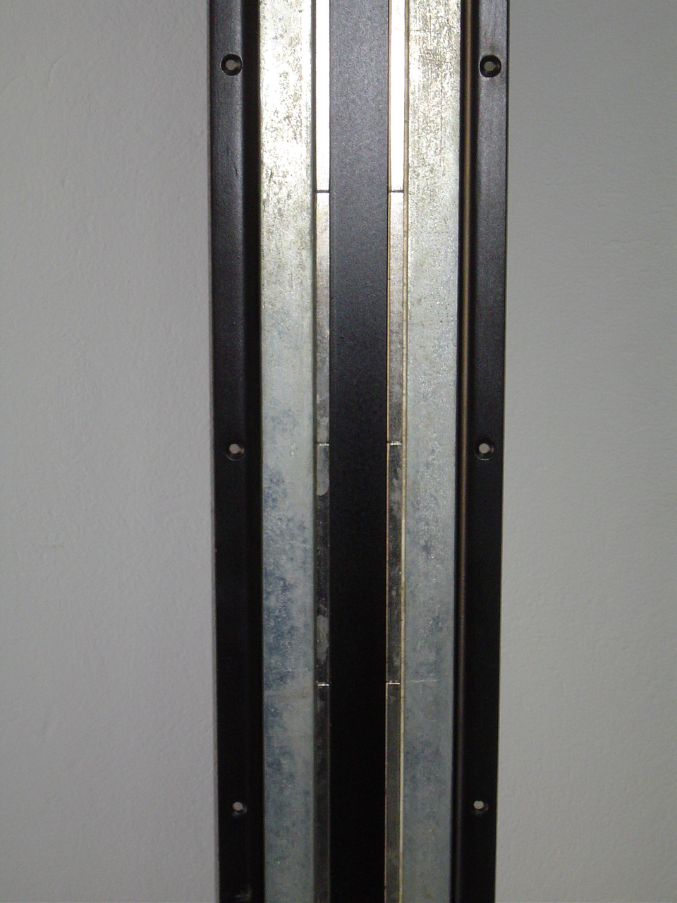

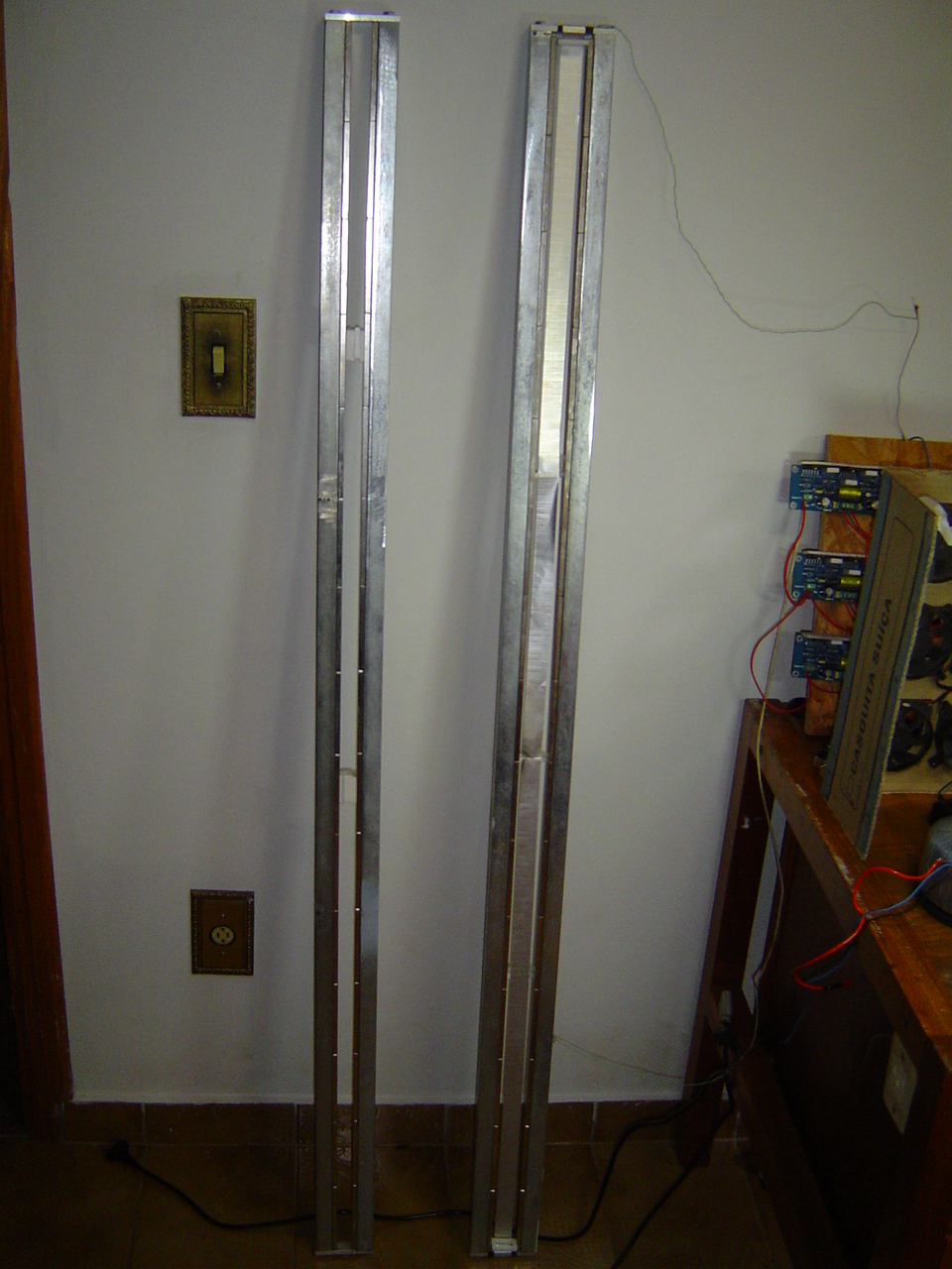

Ribbon tweeter almost assembled:

Specs:
2 bars of sae1020 steel, with 7/8"x7/8" to act as pole pieces.
30x (15 each side) 100x20x6mm Grade N50 neodymium magnets with a 22mm of gap.
20mm aluminium foil (0,0125mm=12,5 microns).
I have a lot of work to finally finish my line array and ribbon too, im on last year of college and i have to make a final paper, but when i got a little time to spend i will post all the work spent on this little baby.
[]'s
Murilo
Ps: take off th. from images url to see these ones on higher resolution.
